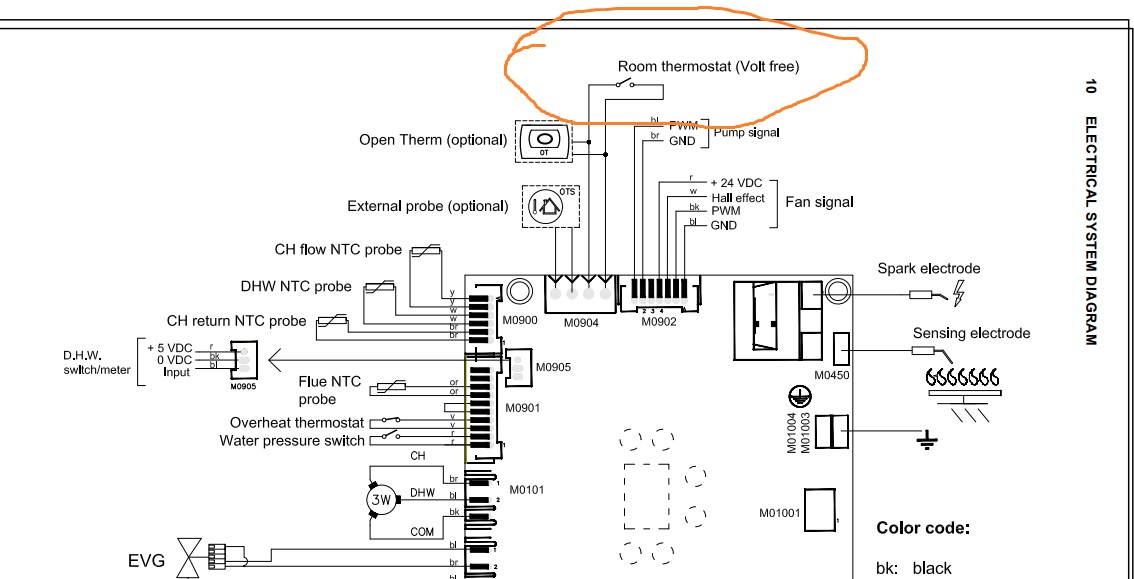

Hello everyone ! I have the same situation like @plumbamateur , just only one difference , my 2 wires from old thermostat is Volt Free (consult electrical diagram for my gas boiler Arca Pixel 31 fc ) ..and i have also 2 channel version of Wiser and also need just simply to control the Arca Pixel combi for heating only.
Please tell me where I must to connect my 2 wire ( COM and NO ) from my old thermostat to the Wiser backplate. I have attached the diagram.

@oldbutnotdead My boiler is ARCA PIXEL 31 FC. I have attached the instruction manual. on page 6 is the electrical diagram, and it's show that is only can connect thermostat.
@Sergiu Which drawing is correct- the one attached to your first post or the one attached to your last post?
If it's the first then connect your 2 wires to the Opentherm module in the Wiser.
If it's the last then the 2 channel controller on its own is not going to work. You either need a relay between Wiser and boiler or you need to swap the Wiser for the single channel version.
@oldbutnotdead The second post is my Arca Pixel FC 31 , this is right diagram. Well, I understand now that my 2 channel Wiser will not work in my case. Have no where to change to single channel in my country, this was bought in the UK and sold in my Country via Internet.
