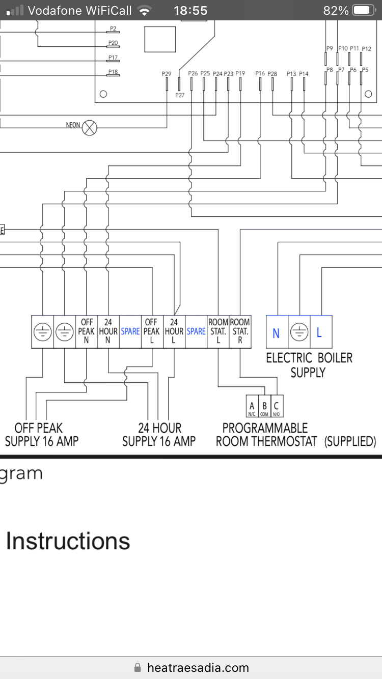

We are considering a Wiser smart system install, complete with the trv valves etc.
Our heating and hot water are both handled by a Heatrae sadia electromax and a danfoss tp5000 battery programmer/thermostat. Heating system is not zoned, but obviously water circuit as well as heating. We are also on economy 10 if that makes a difference. The TP5000 is our only external control (unless something has remained hidden for 10 years!). We would like the Wiser box to be either in the same location as the tp5000 or in the cupboard with the electromax. With the tp5000 being battery and only two wires going to it I assume I am going to need to run a new set of wiring from the electromax to the Wiser box as I don’t have a industry standard back plate anywhere.
Would I be right in thinking it’s just a case of identifying the applicable bits from the boilers main panel and matching those with the wiser diagram and running appropriate cables to a new back plate?
Anything I am missing, not thinking of or should avoid? Any helpful guides or similar I can check out before diving in?
