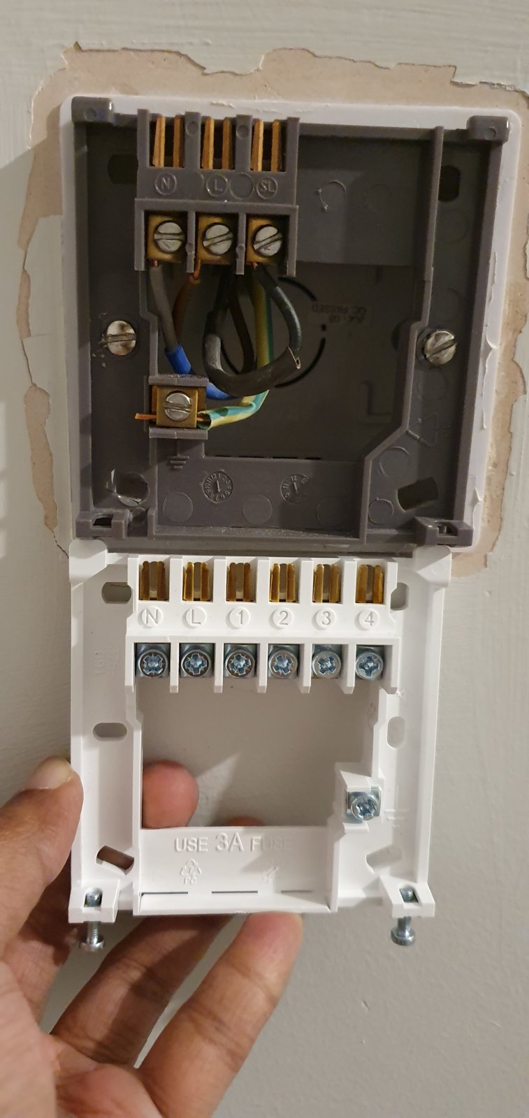

Hi Guys i'm new to the forum. I have bought the drayron wiser as well. My existing glowworm felixcom 30cx has an additional 'switching live'(SL) terminal. On the new wallclock provided by drayton wiser there is N L 1 2 3 4. My question is where should i connect the SL wire on the drayton wiser wall clock.
Any help will be appreciated. Thanks.

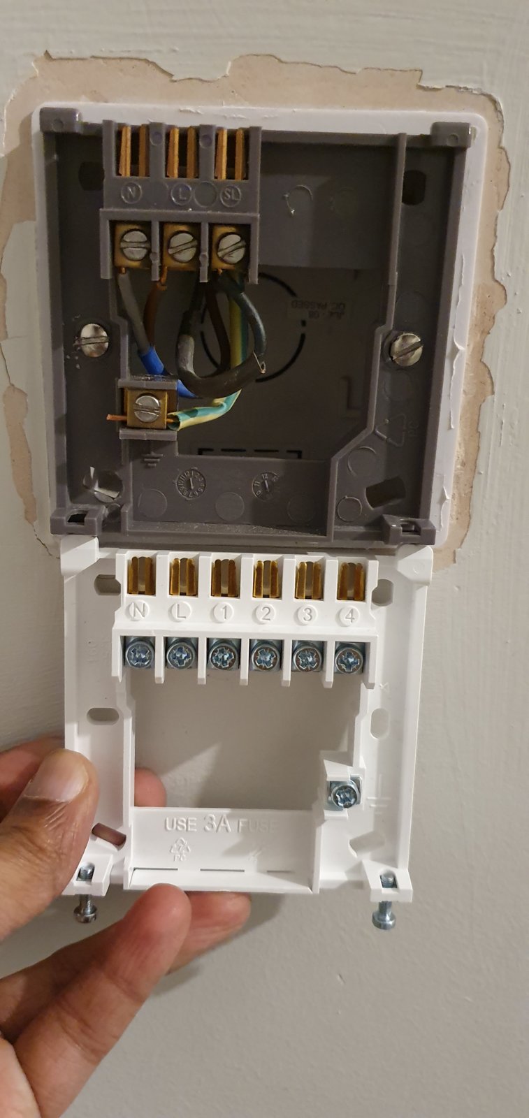

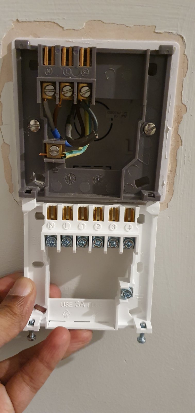

So I just bought a Drayton Wiser kit and fitted the Hub. My problem is that when I activate boost to test the system the gas light on my boiler doesn't light up - which I assume means it hasn't turned itself on...
Here are some pics of my wiring and the boiler, along with a pic of the Drayton wiring guide.

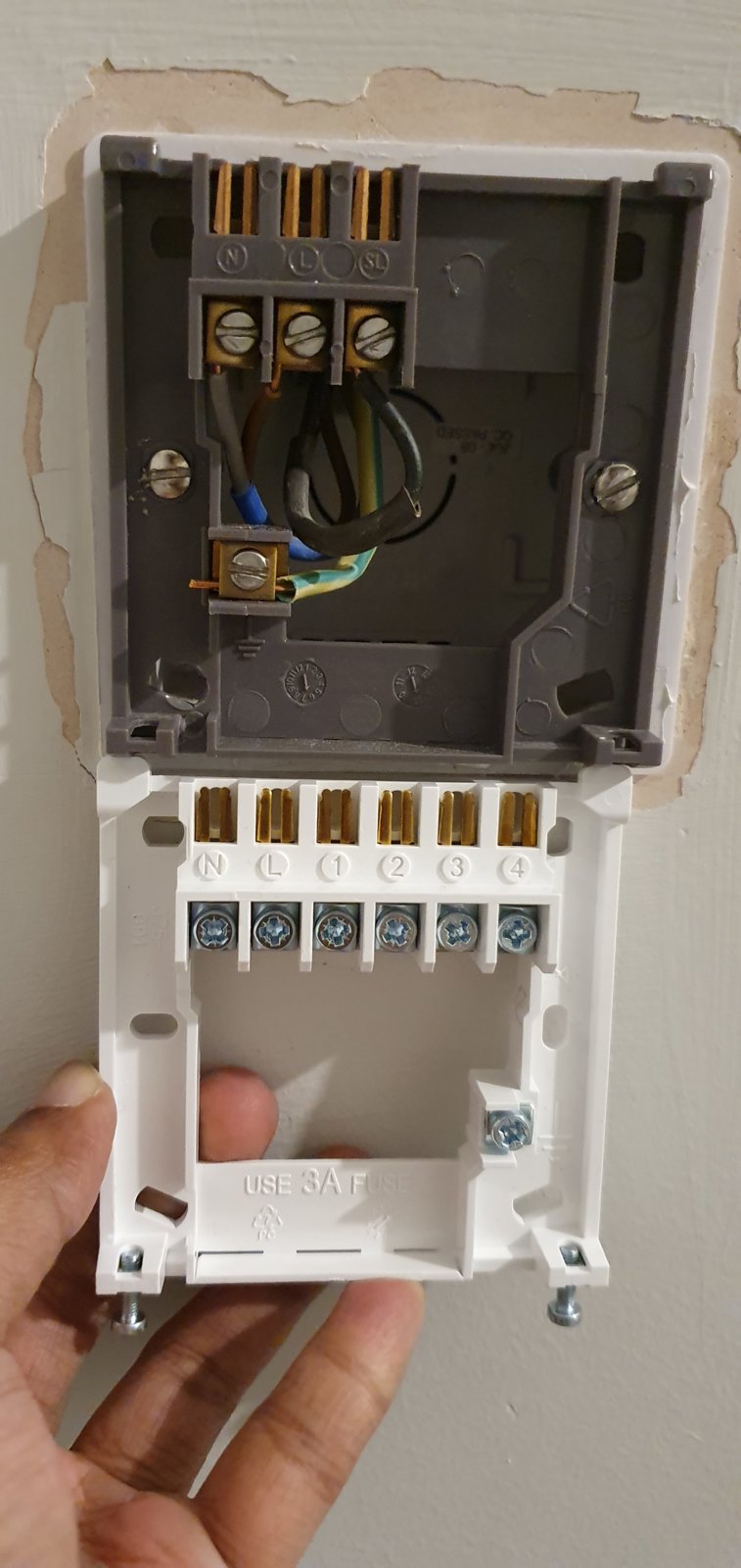

I recently bought the drayton wiser kit1 installed the heat hub and configured the smart thermostat as well. The ap pshows the fire sign when i increase the temperature but nothing happens.
I hooked on the heathub to my existing wallclock from the glowowrm flexicom30cx boiler because the wiring is same. Do i have to install the wall clock supplied by drayton wiser and if so which wire goes where. Can anyone help?
See image attached for more info.

I read the numerous threads and figured out the solution. For the benefit of others, the Switch live had to go on terminal 3 and not sure of I needed to do this bit I linked L with 1.
Hope this helps. Thanks for some great advice on other threads.
