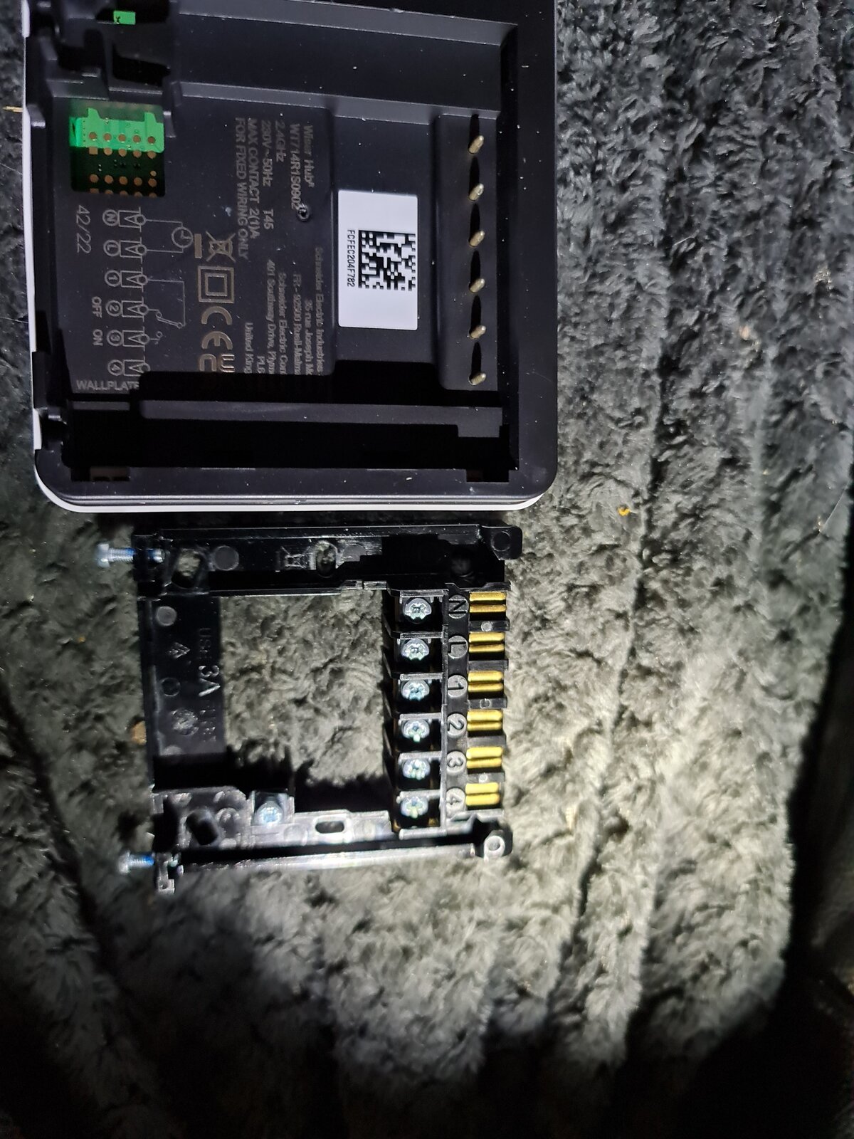

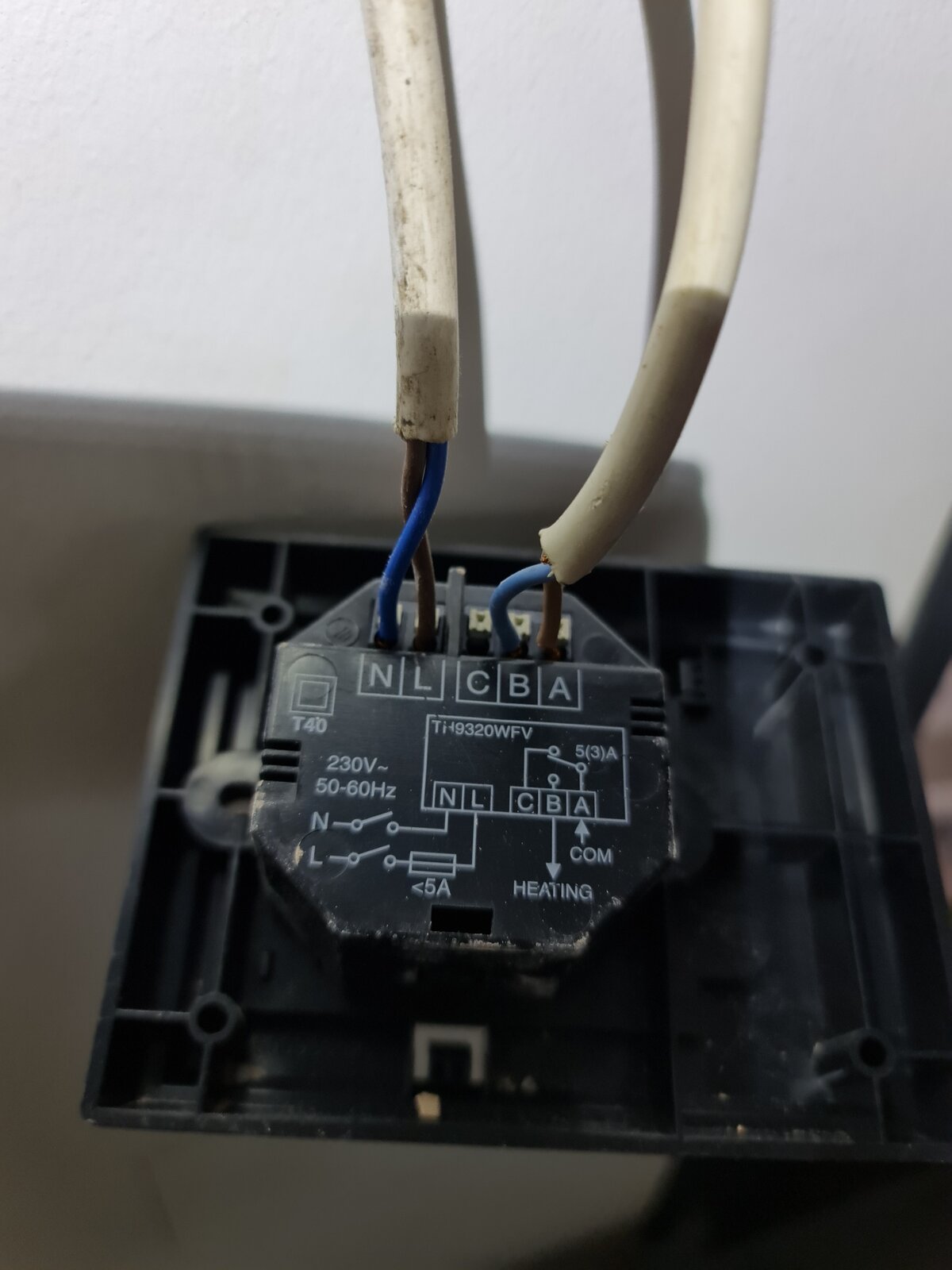

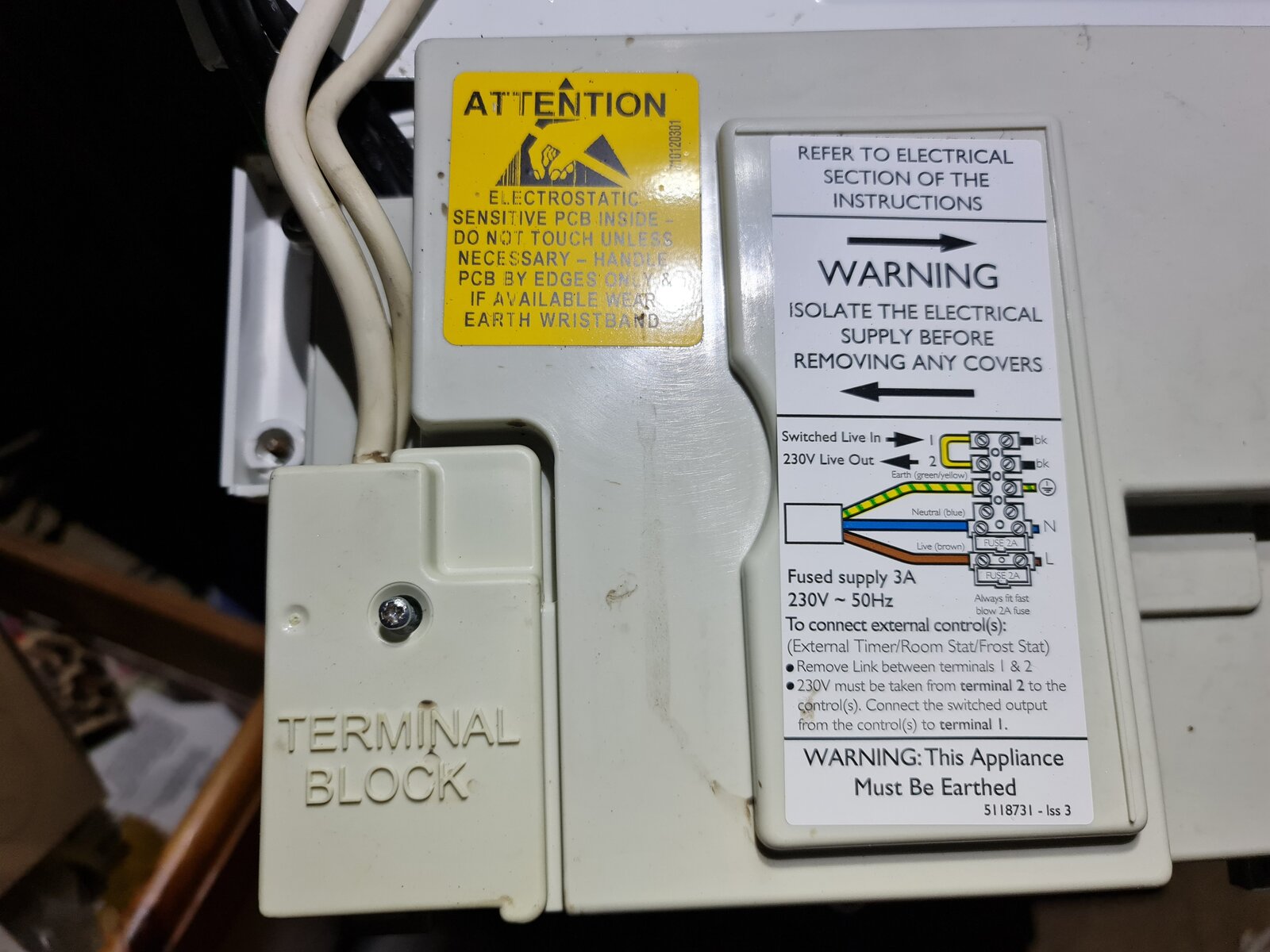

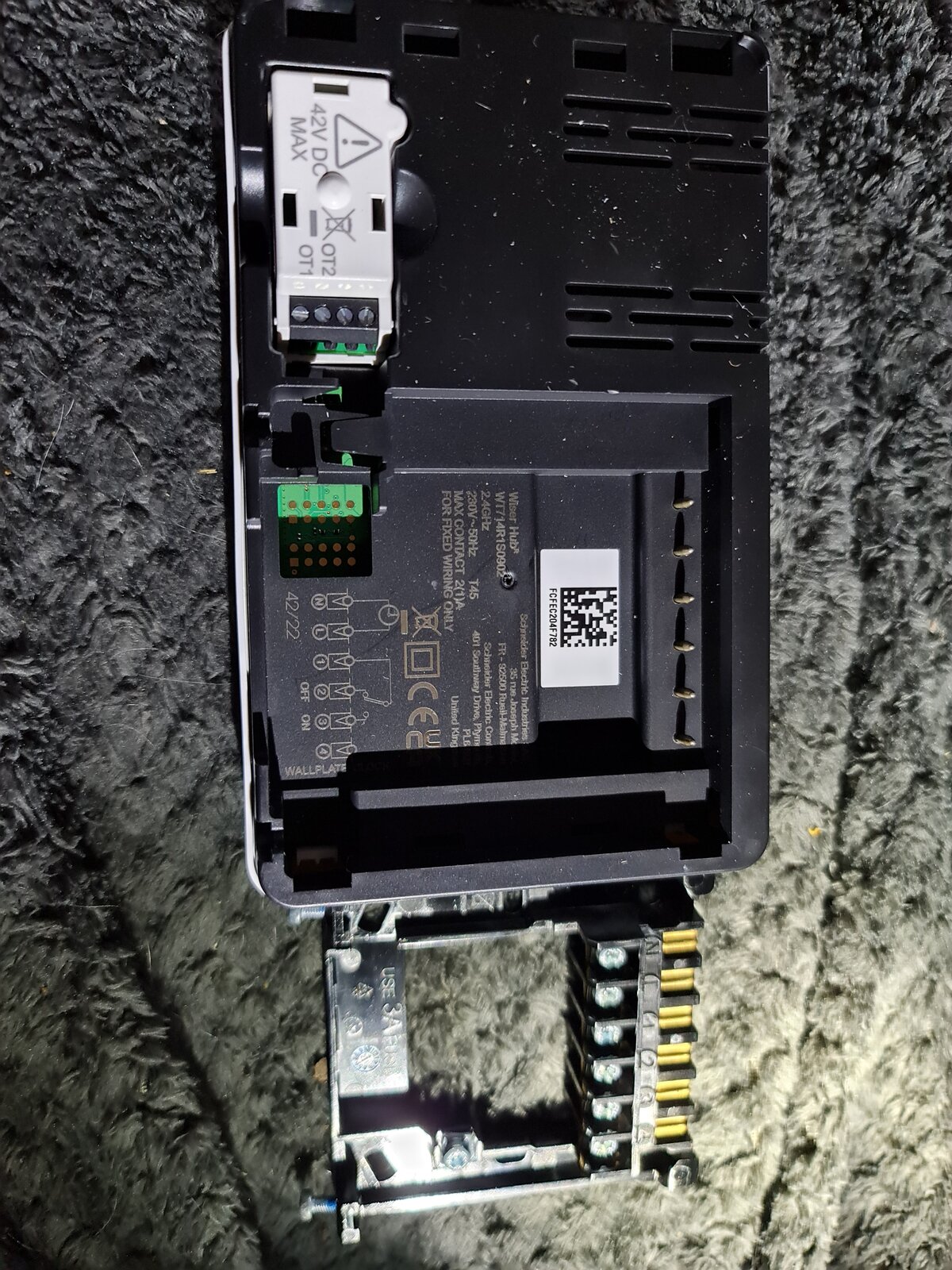

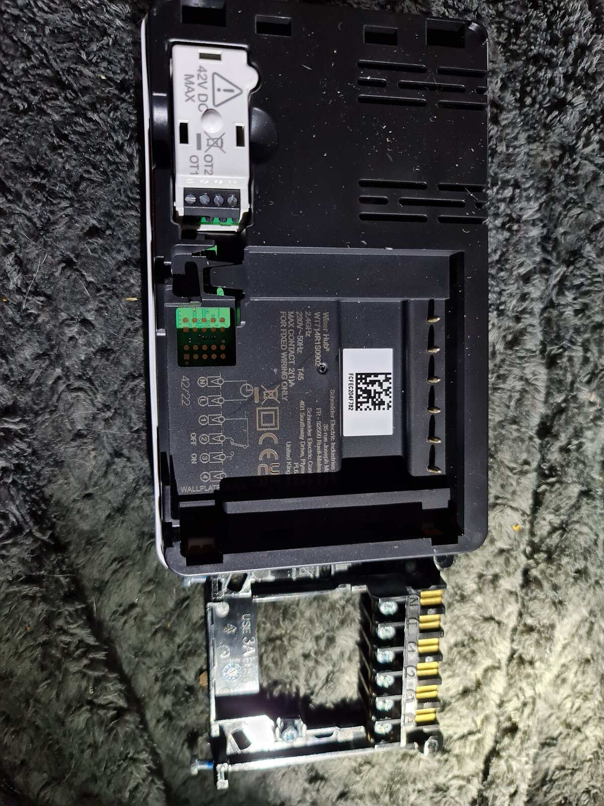

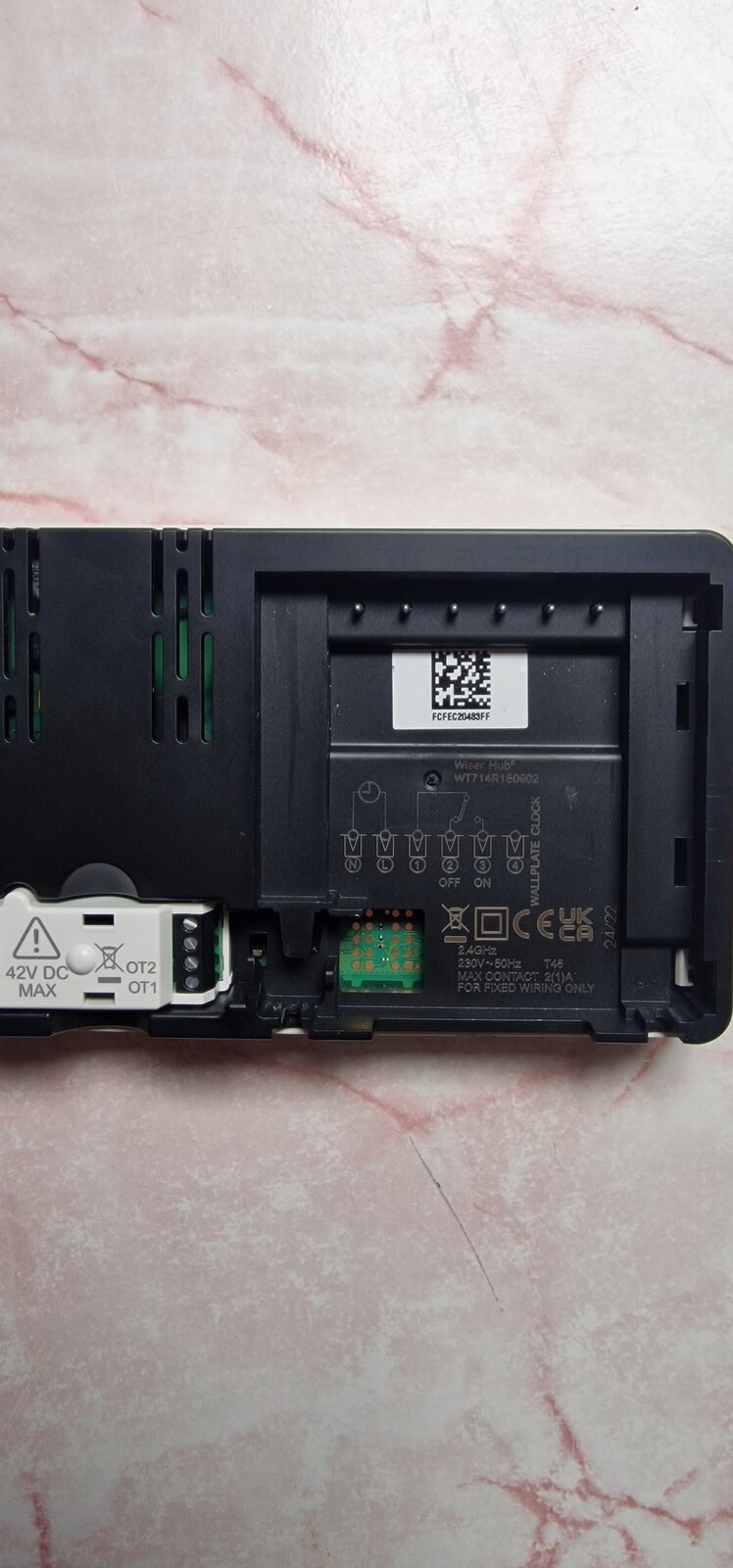

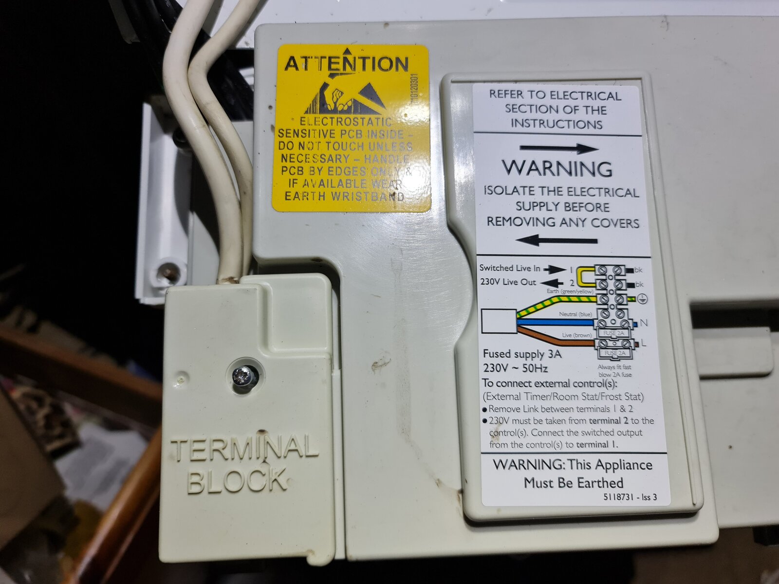

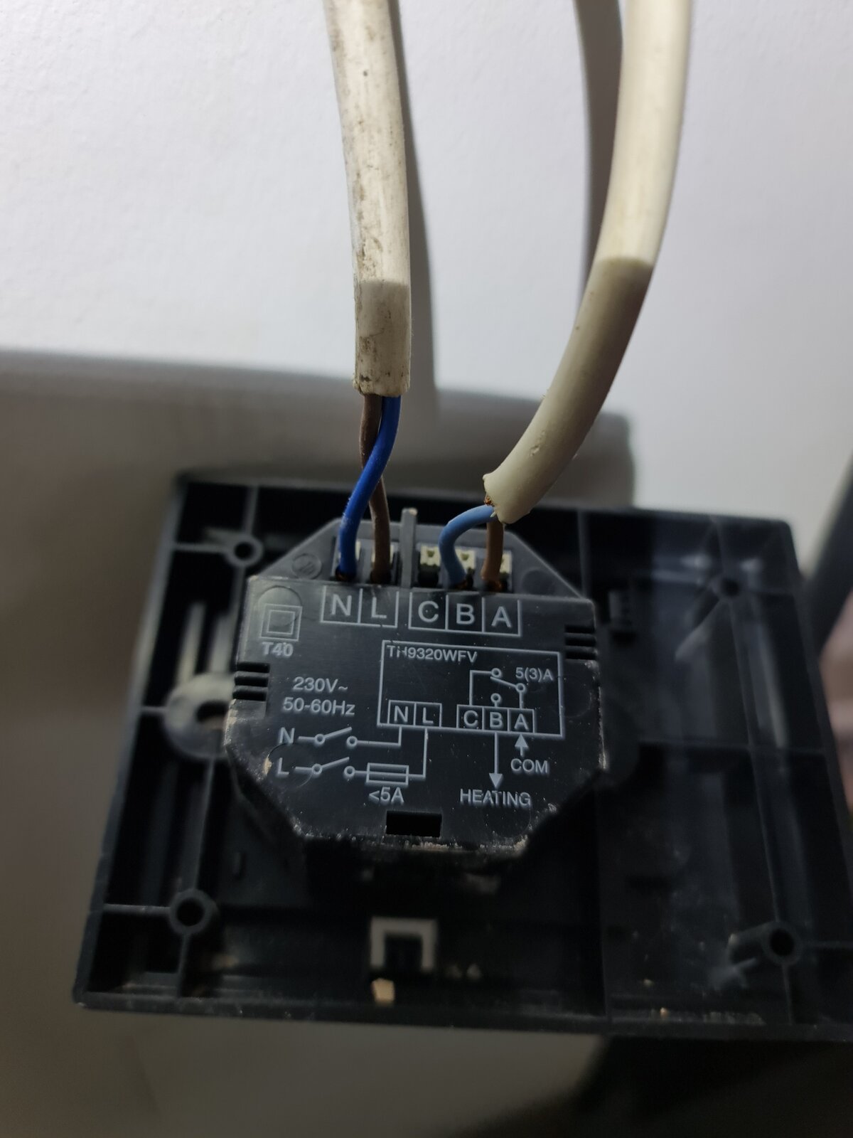

Hi Yall, just got new drayton wiser kit 1, see attachment 1st pic is model
" " 2nd pic is current honeywell
Vioce activated stat wiring.
L n N feed 3amp and other from
boiler.
3rd n 4th pic is wiser new back plt
My ask is how should I wire this up myself (not electrian) but I know enough. Justva tad wary I may blow combie boiler pcb if it's wrongly fitted. ( Baxi Main Eco) 5thn 6th pic boiler wiring . Plz advise. Polite regards John.

L and N self explanatory, A and B either way round, doesn’t matter to 1 and 3 on Wiser, but can go A to 1 and B to 3 if easier. Shouldn’t blow pcb, as it’s mains switching.

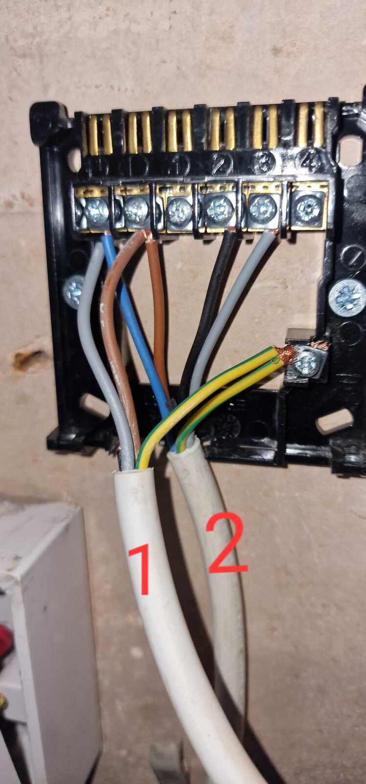

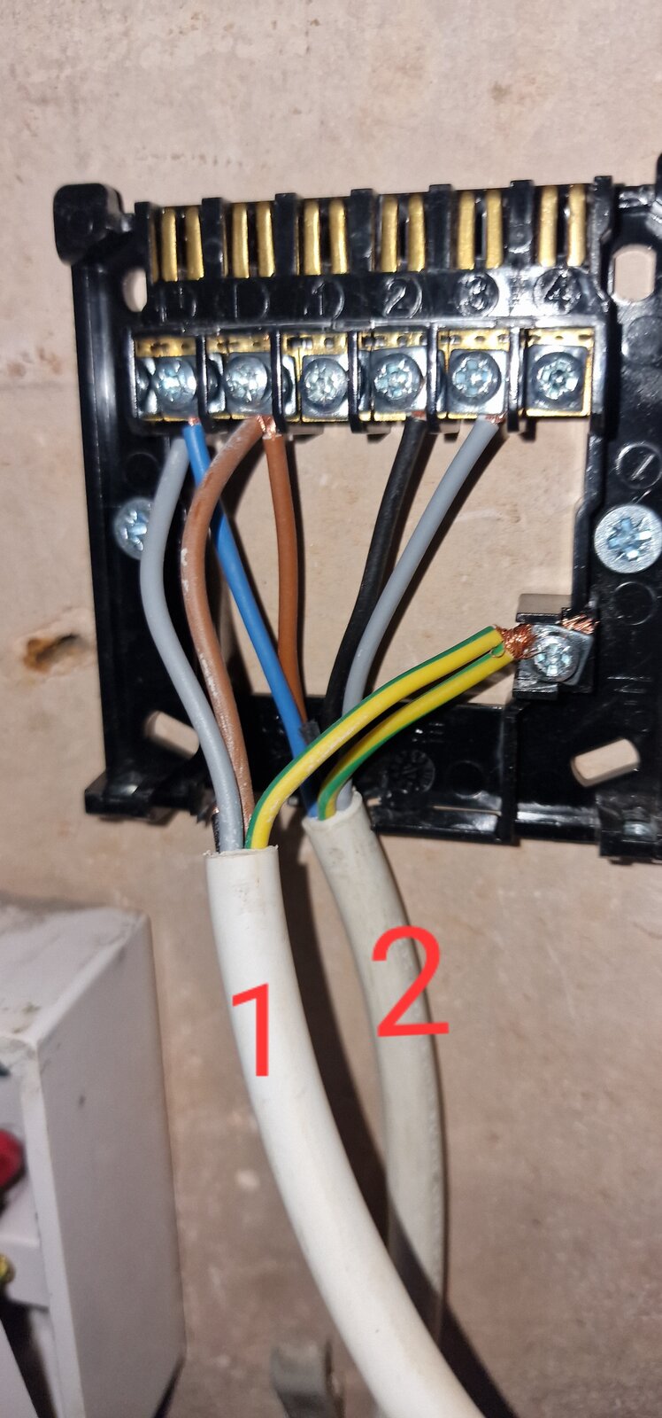

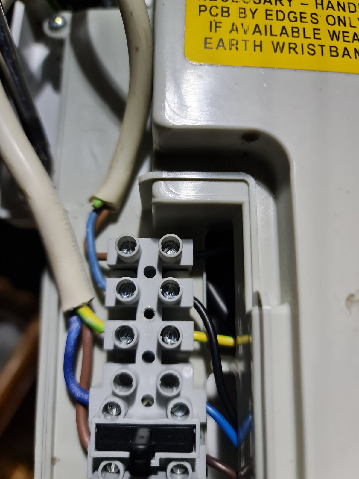

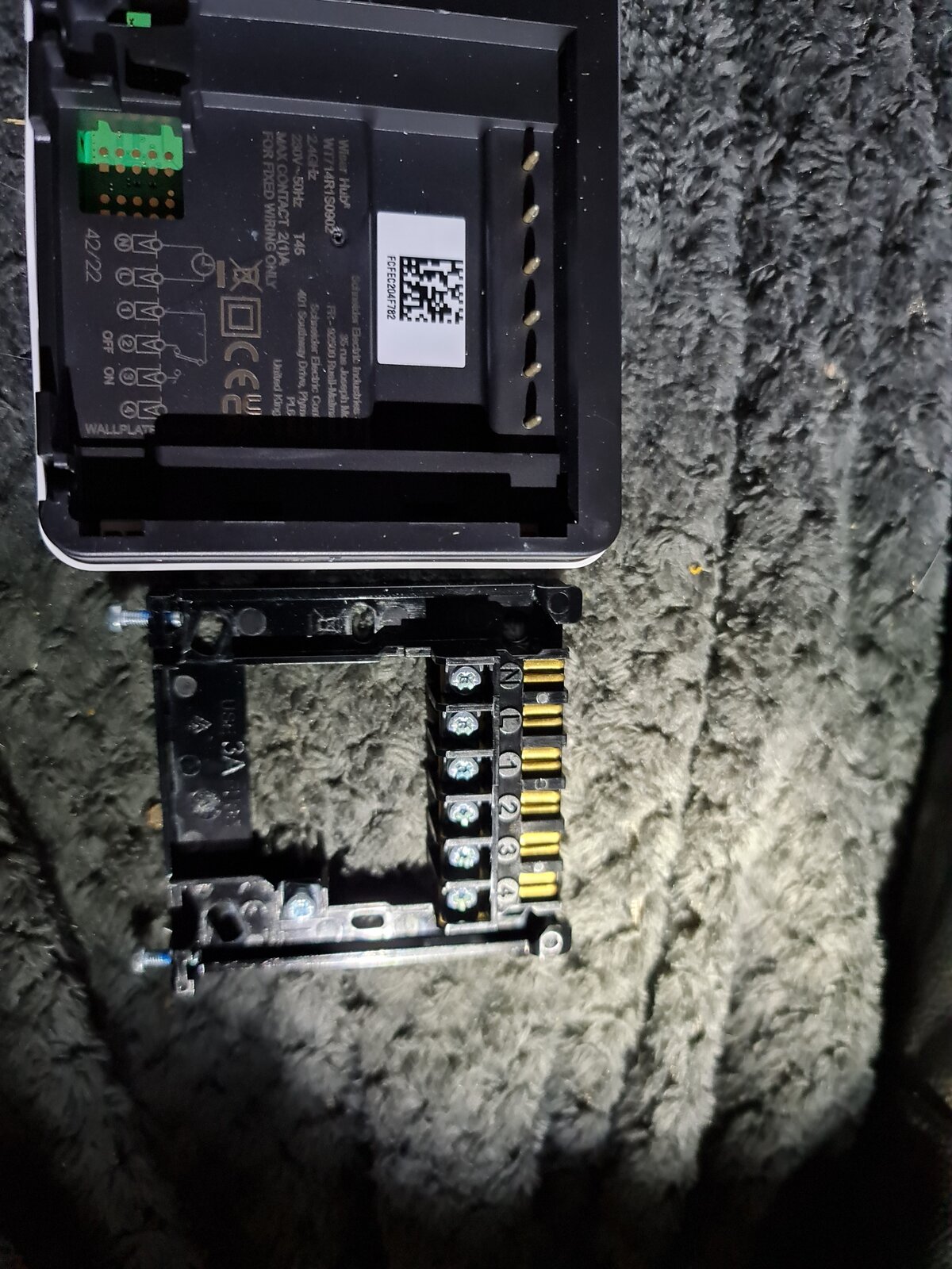

could someone advise me what my fitter connected wrong, that the HW is faultless, but the heating does not activate in any way. neither with the knob on the boiler nor with the thermostat. I already hosted three engineers who couldn't get it to work properly.. my boiler is baxi 800 and the system i am trying to connect is wiseR hub kit 1
On picture no.1 is a power supply, and no.2 is a boiler wires. Many thanks

it wasn't before. there was only a conventional hot water boiler aka water tank , and the heaters were electric
Is it the Baxi 800 Combi or System boiler? Is it definitely the Kit 1?
Yeah sure . Yes. as the first set, I had kit 2, then the heating started when it wanted, mainly at night. So the engineer suspected that switching from kit 2 to kit 1 would solve the problem, and only made it worse
Damn, I missed it from your 1st post the wiring is wrong. You need live in on terminal 1 (common) and live out (switched) on terminal 3. Put the Black into terminal 1 and see if it works.
about 2-3 weeks spent looking for the problem, plus the involvement of some engineers, and thanks to your help, I just solved the problem. Thanks a lot Appreciate
