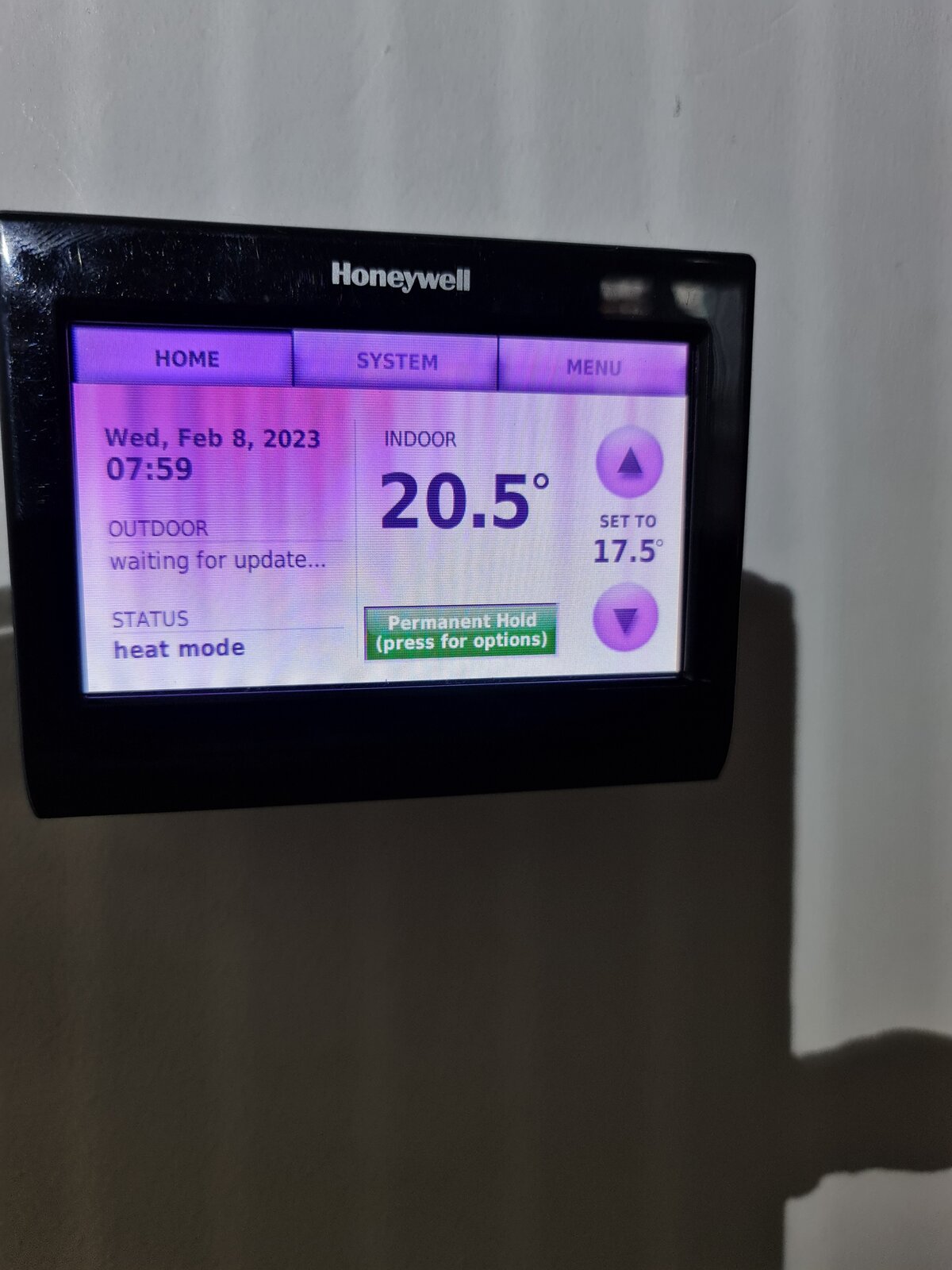

Hi Guys n Dolls, 1st time on Diynot, nearly retired ,kitchen &bathroom installer S.Employed. (North East uk. )
Cutting to the chase ,needing to replace my crap Honeywell vioce act. Room stat/controller, with the Drayton wiser kit 1,as photo. At 1st glance was going to attempt to install it myself, but now worried im gona blow pcb brd in my Baxi Main combie (as at this point I'm unsure if its 240v feed or low voltage. So many youtube vids. Kinda confused now.
Basically photo 2 is my current wiring into the Honeywell N&L obviously is my 240 v from f.spur in loft 3amp and B C is which i take is the switching and call for heat. Please be kind I'm not a electrician but with a little help I can save a few quid. Fingers xd
Recaping pic 1 new Stat
" 2&3 current Hwell stat/controller . " 4&5 Hwell back plt.
" 5&6 new Drayton backing plt.
Looking fwd to your views or should I get a sparky.

It’s 240/230vac switching. Take Brown to Wiser 1 and blue (apply some brown sleeving/insulation tape to this and take to Wiser terminal 3 (heating on).
