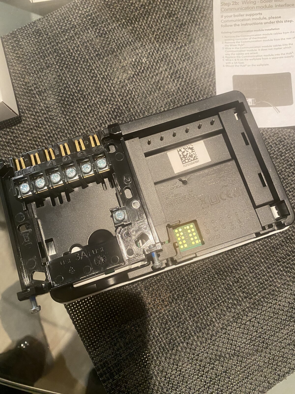

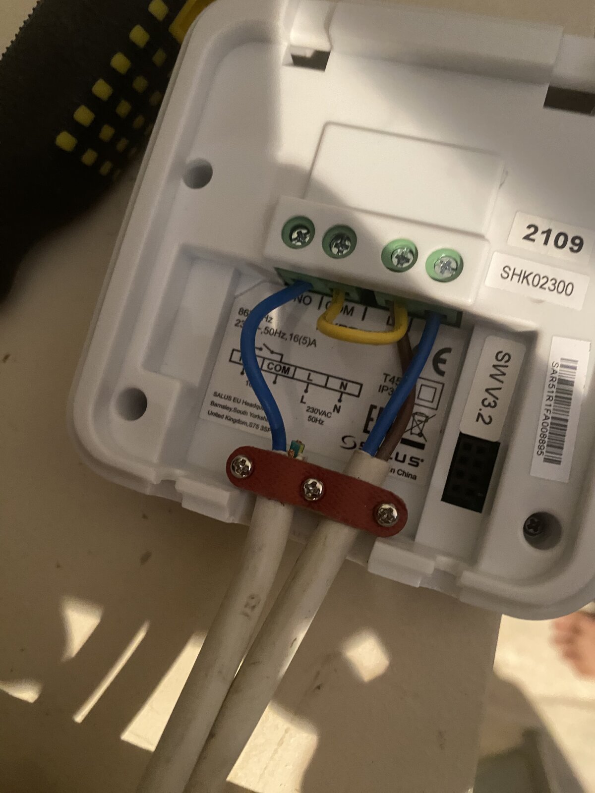

Hi,
I have just bought a Drayton Wiser kit 1.
I have a Salus and trying to replace with the Drayton Wiser.
Please could you help me switch the two over?

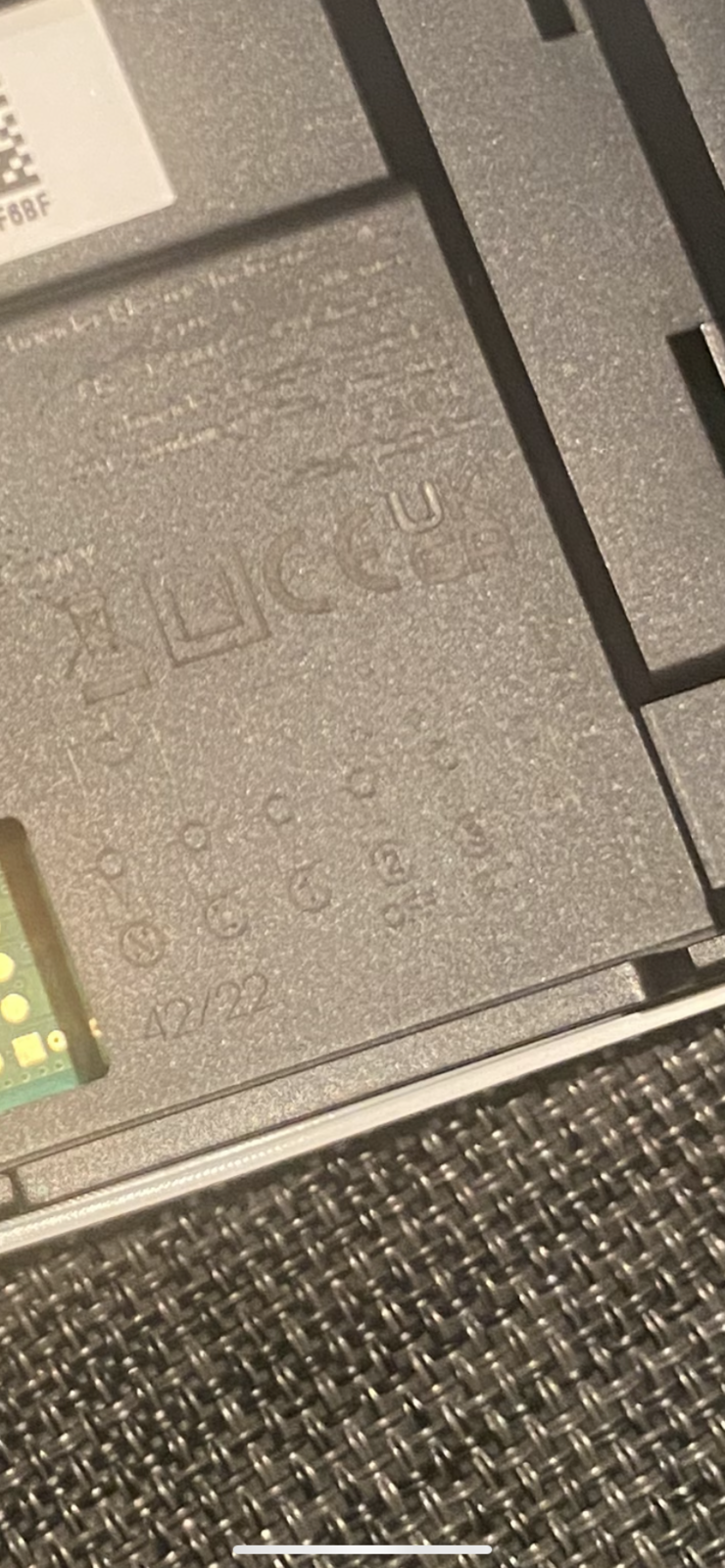

Going right to left move the existing Salus cores to the Wiser backplate
Blue (N) to Wiser N
Brown (L) to Wiser L
Existing Yellow linking L-to-COM goes between Wiser L & 1
Blue NO to Wiser 3
