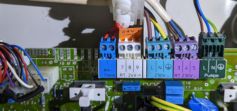

Hi there..
When wiring the universal backplate, would you take the live and neutral feed from the boiler circuit board or would you wire it separately from a junction box?
I've seen both methods described, and wonder which is best practice (if any)? Thanks...
I'd take it from the junction box, which should have a 3 amp fuse.
Not sure it matters that much though as long as it's a reliable power supply.
The boiler, programmer, pump and other heating controls should be fed from a common source which is protected by a 3A fuse. Generally that would be a fused spur located near the boiler. The intent is that the entire CH system can be isolated from a single location for safety purposes.
Taking the L, N & E connections from the boiler is OK but that may not be the best choice.
What controls does the boiler currently have?
Thanks Harry and Ian. I have followed your advice and my mounting plate is now live. I fed it from the existing fused wall mounted box that serves the boiler. Currently the boiler is controlled by a cheap and nasty wired thermostat in the hall. TUV? At least it's programmable!
Sounds like good progress. You just need to wire up the control side now and bypass current thermostat
I just need a little more help and advice please. This seems to be switched by 240v. In the photo the originally mis-labelled 24v block is wire free, and the cable coming from my old thermostat goes into the purple block. I might just use that cable for my purposes. I gather L and 1 on the mounting plate now have to be connected, but I'm unsure where my feed wires need to go. Is it 1 & 3? I was expecting a low volt switch but I can't tell you why!

Just checking you have the 1-channel version of the Wiser. If so..
Easiest is to use the existing cable going into the purple block and connect the other end into 1 & 3 on the Wiser. Whilst it does not matter which way round the cable goes on the Wiser, I would recommend brown into 1 & blue into 3. Then add a brown sleeve on the blue to say it's a "switched live". This will leave Wiser terminals 1 & 3 as potential free, i.e. no voltage is being added by the Wiser Hub. It is merely closing the circuit between 1 & 3 when "on" and opening the circuit when "off". You should NOT bridge L & 1 on the Wiser.
If you look at the Vaillant installation instructions, the 24V block is not mis-labelled. The crossed out 230V is intentional. See page 23
Another thing I would check is any strain on the cables going into light blue (L/N/E) and purple (3/4/5) ports as they do seem to be at a bit of an angle.
I should have enquired before, presumably your existing cheap and nasty wired thermostat is battery powered?
Wiser single channel is volt free, and can have an opentherm module, but the double and triple channel can only work at low voltage (230 volt) I personally think using the same back plate for all three is wrong, it is asking for problems, however it has been done like that for years, by many thermostat and programmer manufacturers not just Drayton.
The idea of using the same circuit for all 230 volt central heating items seems good, but a circuit is an assembly of electrical equipment supplied from the same origin and protected against overcurrent by the same protective device(s), so if there is a fuse inside the boiler, then to be the same circuit means it needs to be supplied from the boiler, however a supply, is what runs the whole house, so it will always be the same supply.
As @ian1182 says "The intent is that the entire CH system can be isolated from a single location for safety purposes." but this is only really a problem when not using a volt free thermostat, the Nest thermostats are often supplied from a separate step down power supply, or USB module, but really there is no difference to if the power supply is integral or separate, if the contacts are volt free, it does not matter if supplied from same circuit or not. Only when using the non volt free is there a problem, one expects if you turn some thing off, then there is nothing live after that point.
The problem comes when volt free is replaced with non volt free, but one can't stop those who come after you not to do some thing daft.
