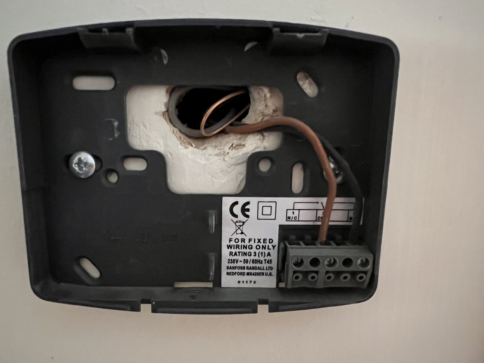

Hey folks, I’m in the Uk and looking to replace my Danfoss 5000 with a new Drayton Wiser Smart Thermostat.
I bought this thinking I could just swap one by the other but upon looking, it seems the Danfoss doesn’t use the standard backplate as expected
So looking at what’s already there and I see a couple of wires going into it.
The standard backplate seems to expect a lot more cables, so was wondering if anyone could help me wire this thing up? Do I just need to connect them two and push the new box in? Or am I missing things?
System: Combi Boiler (Ideal)
New thermostat: Drayton Wiser Smart
Product: WT714R
You don't say which Wiser product you have but if it's...
Then it will require 230V operating power [the Danfoss you want to replace is battery operated so doesn't have a 230V supply]
The two wires you have in the Danfoss COM and N/O would go to terminals 1 and 3 respectively in the above Wiser example. Then a 230V supply from the same 3A fused supply as the boiler would go to terminals N & L to provide the operating power.
It may be that the brown wire is actually a L (this can be tested with a multimeter to confirm) if it is, linking L and 1 would provide you with the live supply.
Regarding the neutral, the grey wire could be used as the N (fit it with a blue sleeve to identify it as such) and it will need to be connected to a neutral at its other end.
If your Wiser product is different to the above, please provide details of it.
It would be beneficial to state what type of system you have, Splan, Yplan, Combi boiler et al.
So basically the wiring for your thermostat will come from the boiler, I would have a look at the fused connection unit and see if it’s possible to locate the wiser receiver from there rather than opening the boiler as the cover often forms part of the combustion circuit, needing a gas safe engineer or someone competent to check for safety afterwards. If it can be done at the fcu, then just piggyback the L and N from there and then just add in the live to common and switched live to the heating on (NO) and that should work.
@mplacona I am in the same predicament and just wondered how you got on with this? I have no "main" boiler controller only two Danfoss 5000 one upstairs and one downstairs.
I did. All I had to do was get an electrician to connect two blue wires near my boiler (they were just not connected with each other), and this made it so that I could now use the cable that is in the back as a ground. Hth
