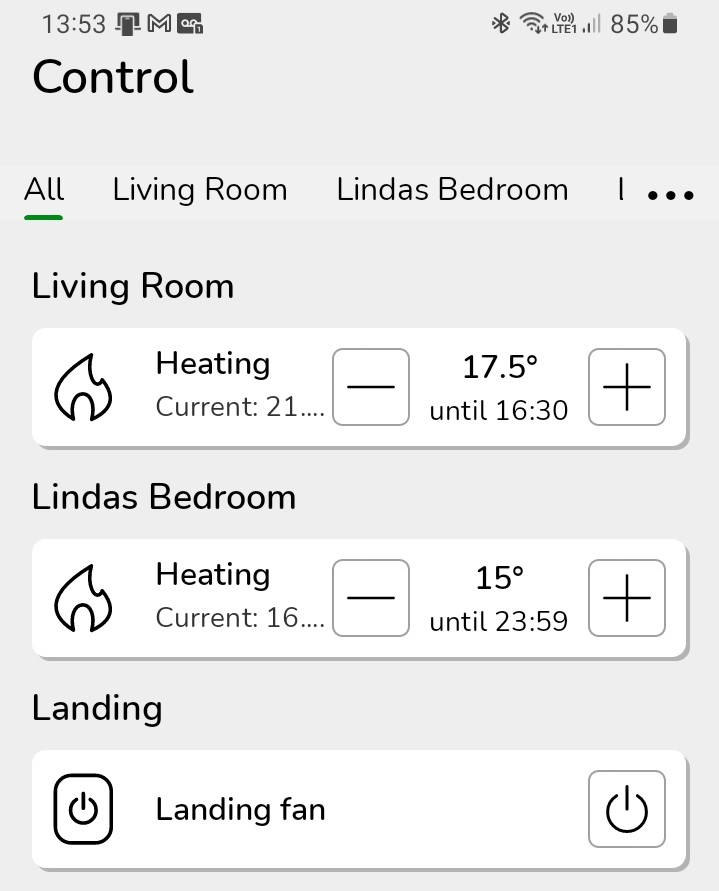

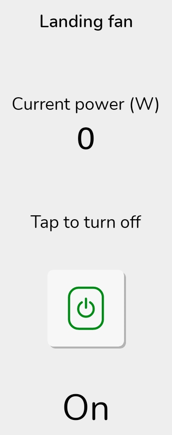

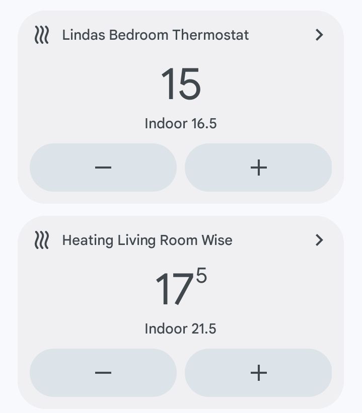

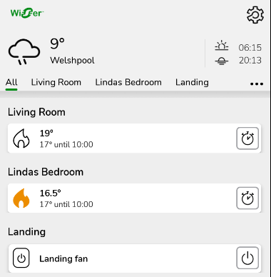

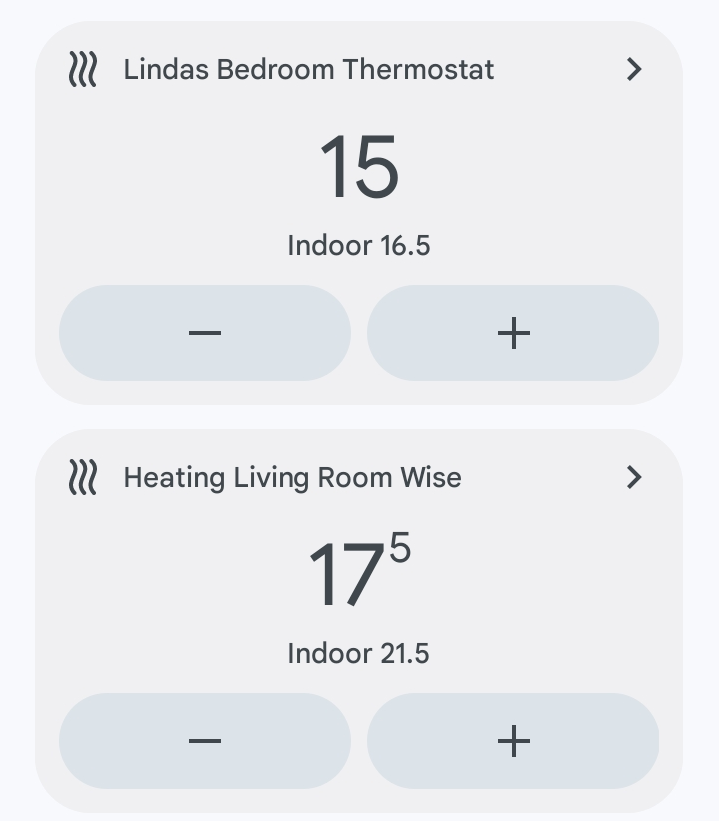

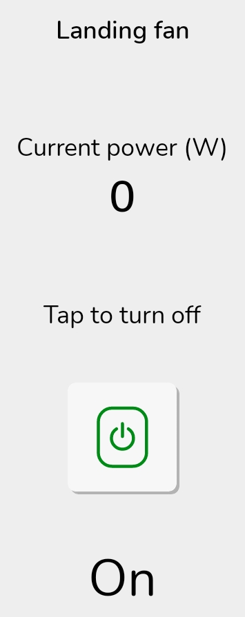

1743170835540.png1743170927229.png It works, both with Nest/Google, and Wiser own app. The socket adaptor 1743171159416.png it seems shows the power being used. Not looked further as yet, in summer we normally put a fan on the windowsill and use a smart socket adaptor to turn it on/off.

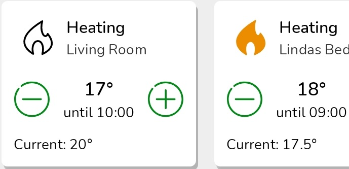

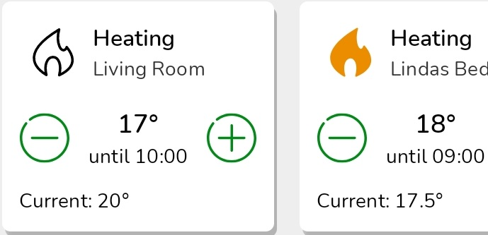

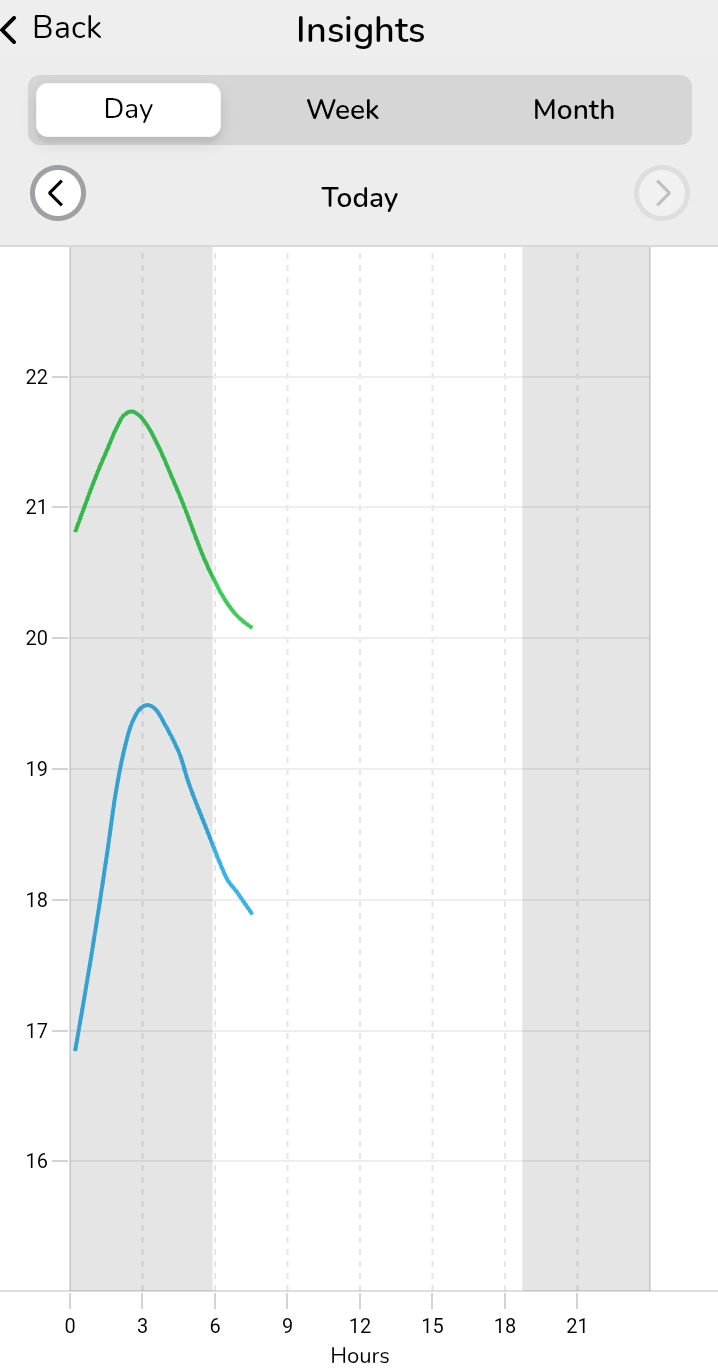

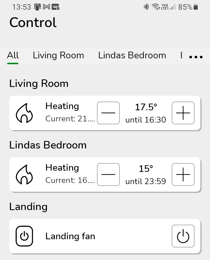

1743234698340.png1743234803139.pngIt seems to be working well, may need to adjust temperatures, but when my wife's bedroom is in use and under temperature the boiler is firing up, even when not required by main thermostats, so just need to give it some time now to settle in.
Now I see how cold my wife's bedroom gets, no wonder she was complaining.

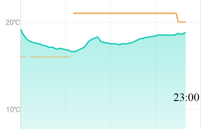

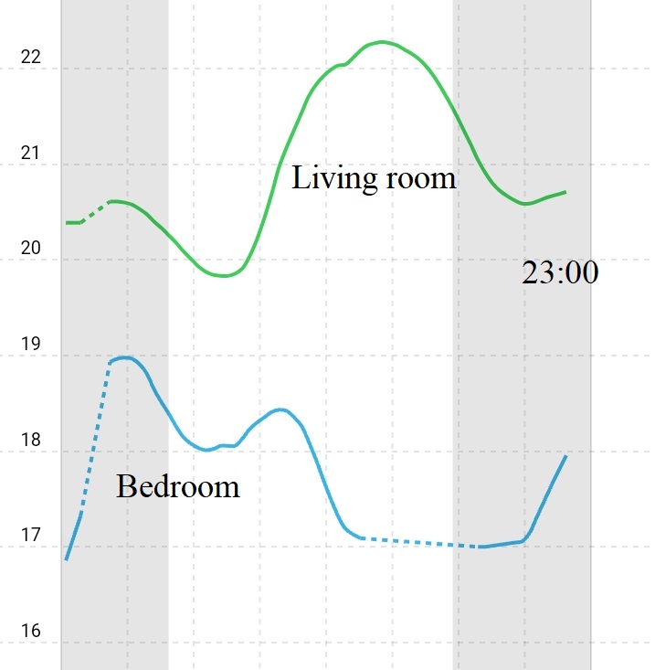

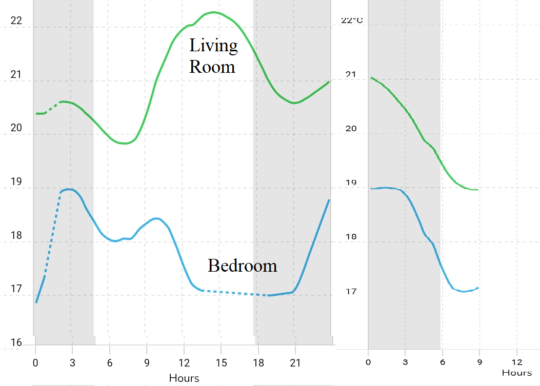

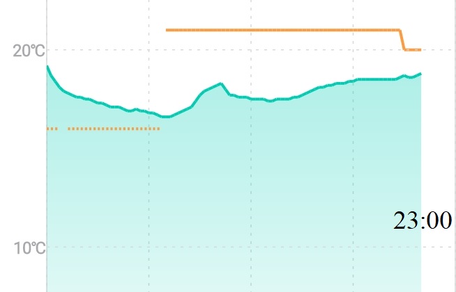

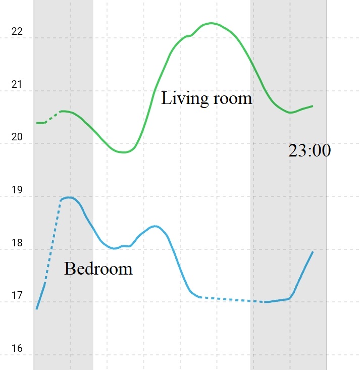

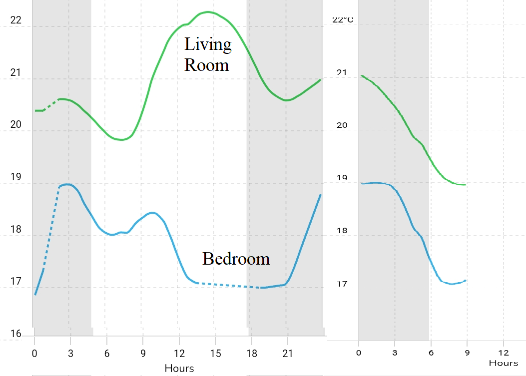

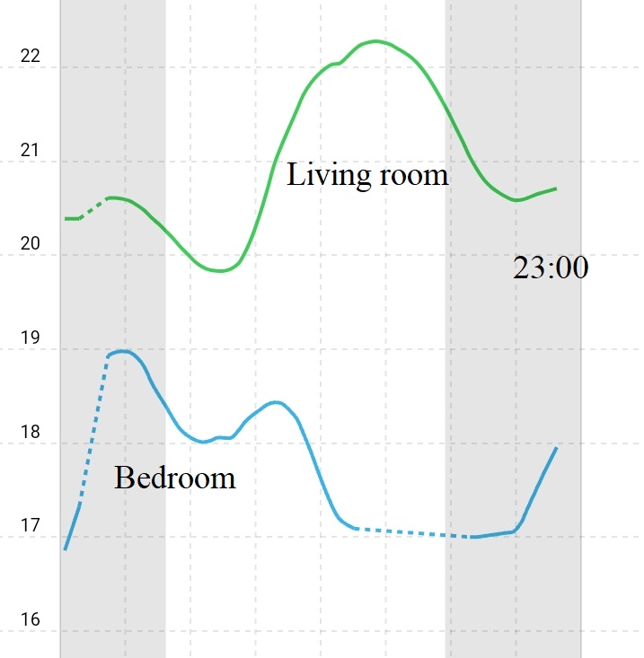

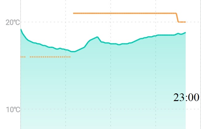

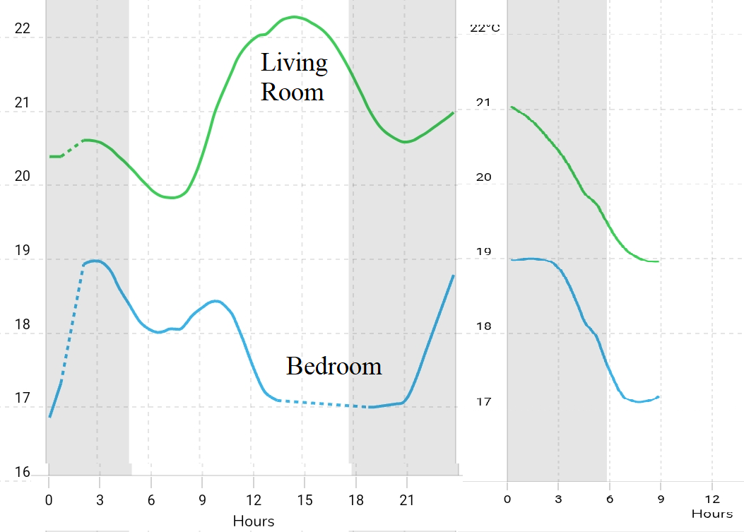

I am now looking at cost, three thermostats give a record of the temperature Kasa living room.jpgWiser living room and bed room.jpg and the schedule for the bedroom is firing the boiler when no other rooms need heat. As expected with sun in living room, the living room is warmer, when I look at the two 1743408029564.pnghow the new TRV is firing the boiler latter at night, and I have set bedroom heating to come on earlier so around 10 pm, so using boiler at same time as living room, rather than bedroom only. I now wonder if a wall thermostat and separate TRV are better? So the radiator can get hot if the boiler is running, but the boiler is only started if the room is too cold.
If I had a modulating boiler, maybe different, but a 20 kW boiler is firing up to heat a 2 kW radiator. Not sure any more?

What you are experiencing is exactly what I was saying in your other post. It’s a waste of energy to heat one room/radiator hence why I grouped together enough radiators TRV’s so that when the boiler fired it was worth it.
I now believe it is better to allow a master thermostat to fire the boiler and radiators then warm as required. If you have distinct areas to heat then having a couple of thermostats each controlling an area is the way to go IMO.
