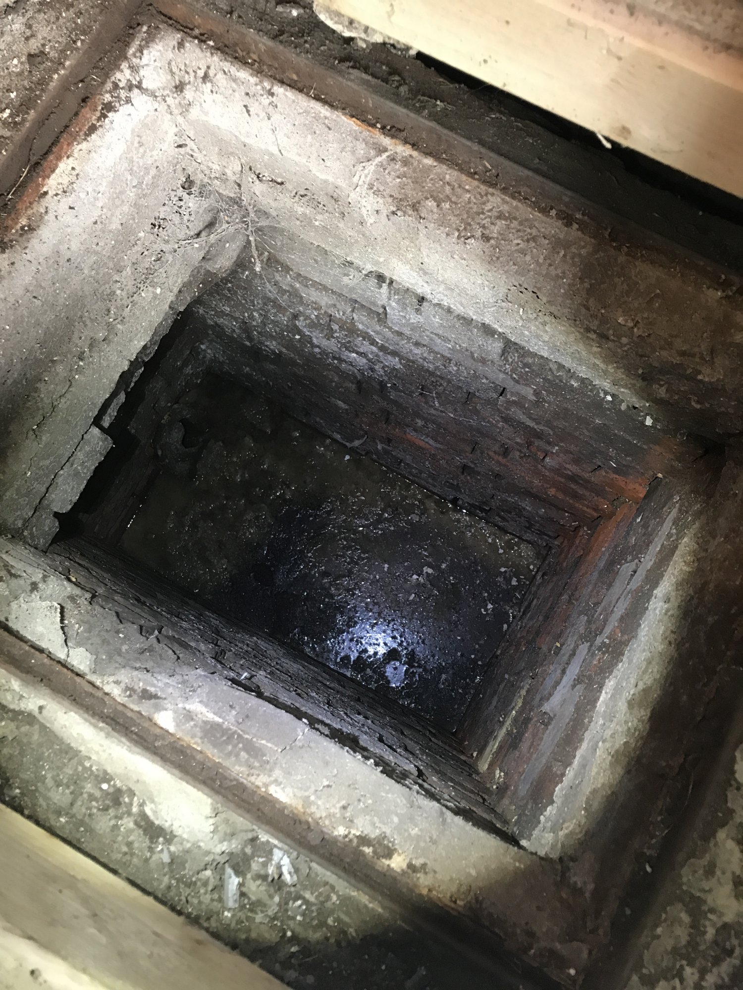

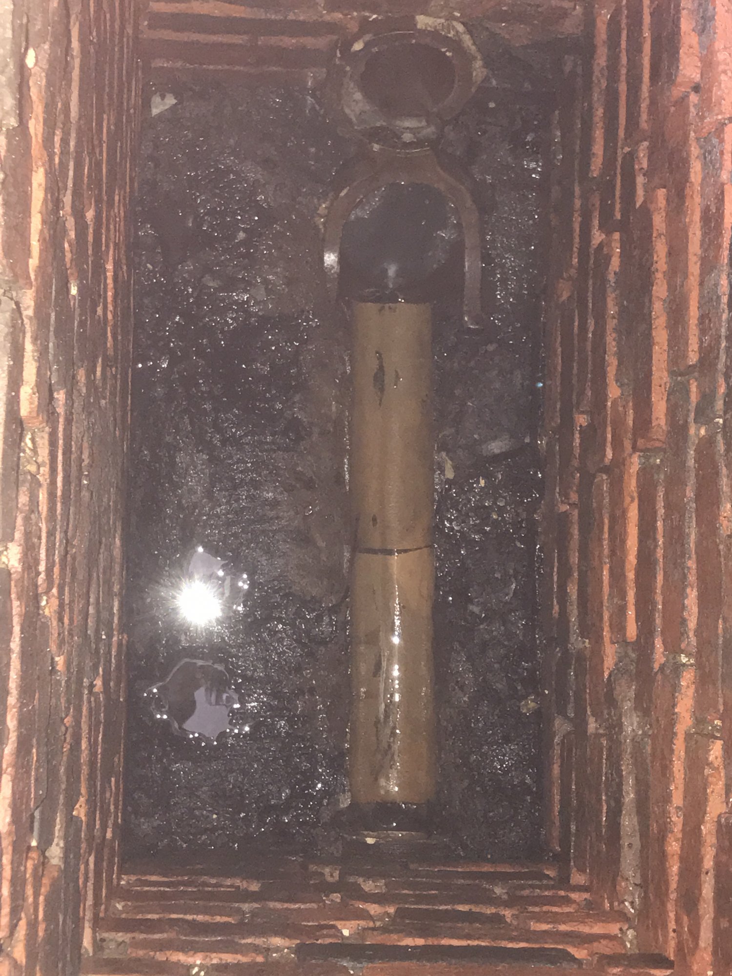

If anyone is ever interested. So after a lot of inspection and what not it was not actually broken and misdiagnosed. In the end we ended up keeping it as it was in perfect condition.
Had been blocked up for years they reckoned, relics of a renovation circa 2007 were found. In the end the trap was cleaned properly by hand and back jetted. The chamber however needs a lot of work, one of the benches was fixed urgently as the adjacent chamber was leaking into ours. I will do the rest myself with Jetcem (needs rendered etc).
Was in there myself today, learnt a lot and actually can do a lot of it yourself with a strong stomach!
Try the rest then try the best!!
It was so bad because the neighbouring chamber was also blocked and had caused all the pointing to have fell out and thus the chambers were basically leaking into each other. Years of neglect on both houses basically. Chamber looks original from when house was built too. Apparently if I pop down every several months or so wth a gauntlet glove is enough to pick up debris from trap, and keep an eye on it periodically.
We found a broken bottle with a 90s date on it, mortar, screwdriver, loads of baby wipes (previous owner!), tiles etc.
Before and after cleaning below. Rebenching in progress
Nice photos ! Seen many chambers a lot worse.
