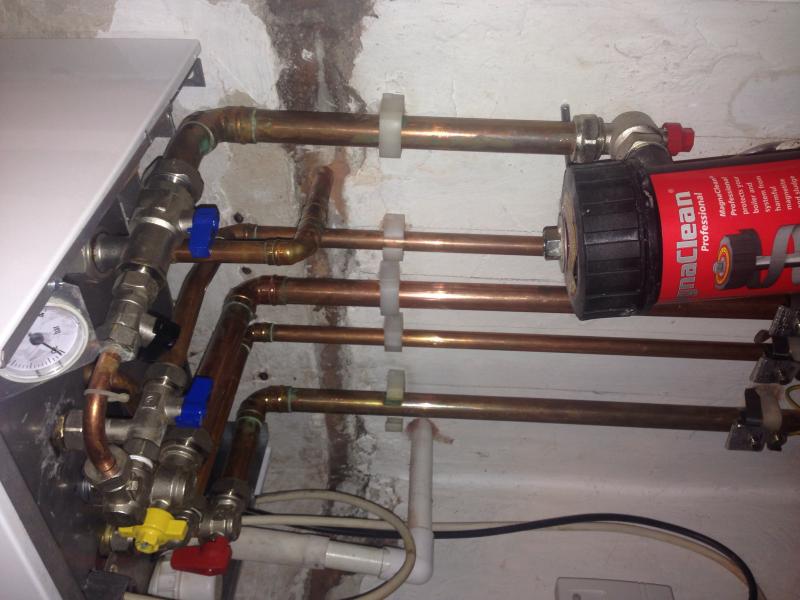

the filling loop on this boiler is a fixed piece of small bore pipework
its not the flexible type blagard
Got it - So a built in filling loop! with removable copper link bent through 90 degrees. Black handled valve on either end.
That sinks the idea of a simple water flow check through the loop!
So the OP can only check that both valves at either end of the copper link are open.
Here is the boiler pipe work. I have a magna clean fitted and have now notice a leak coming from that which I think may be causing the problem. I'll see if I can find a way of taking it off to empty it out and refit it. Do you think that could be causing the problem?
