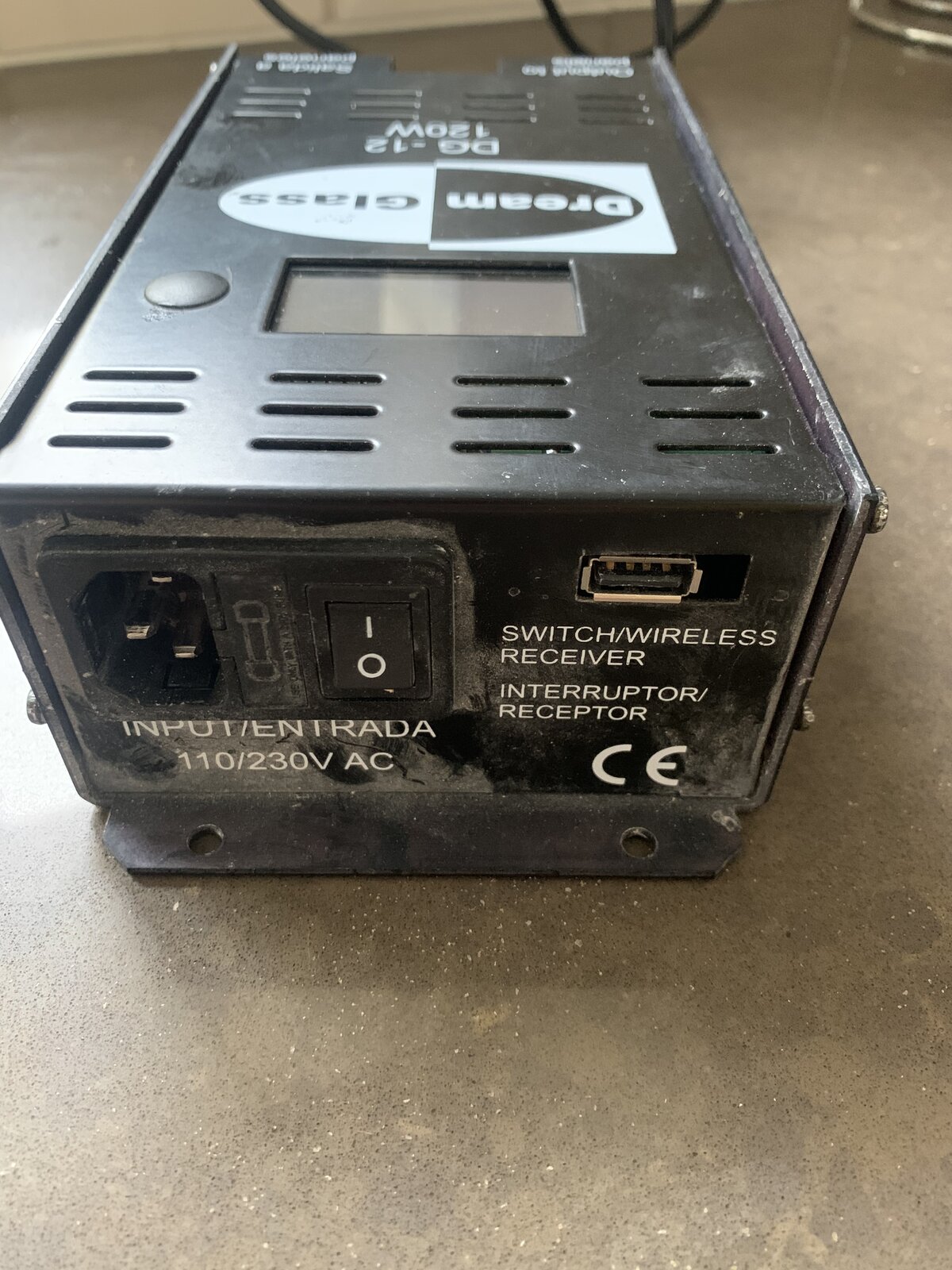

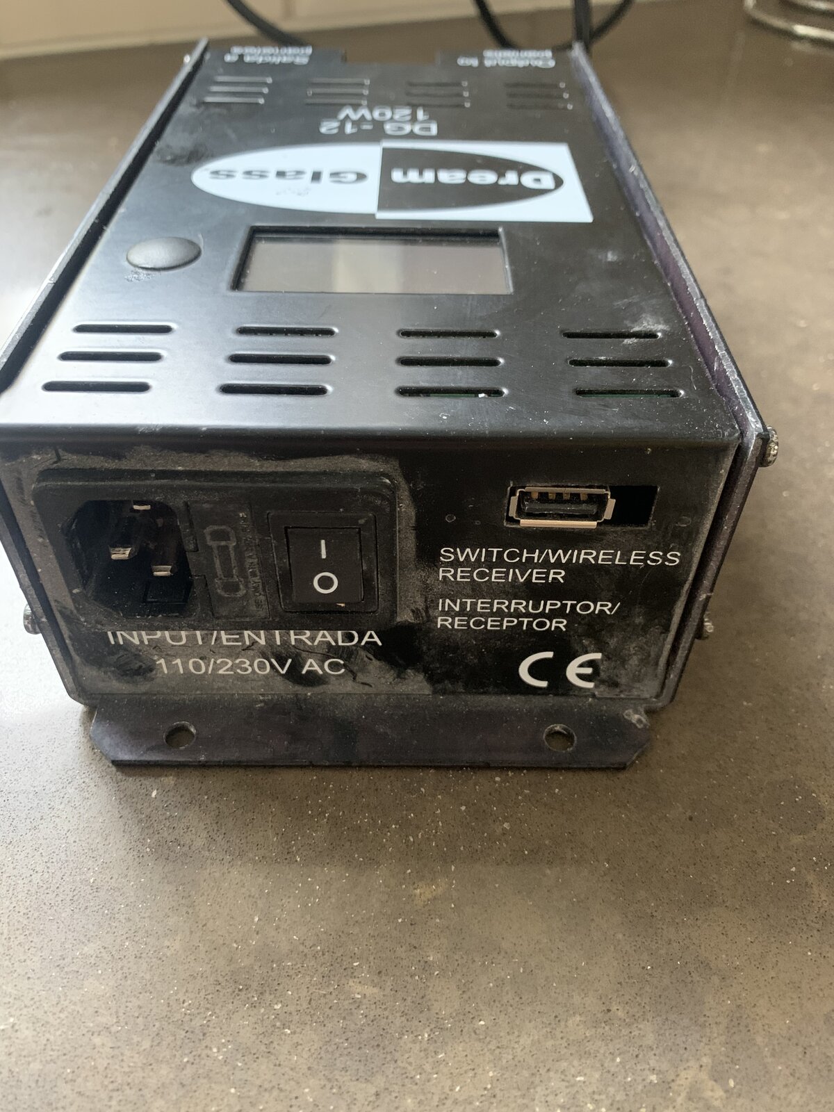

Does anyone know how to diagnose a fault on a dream glass dg-12 controller? Seems to be dead. Fast blow fuse had failed replaced and still nothing. No obvious caps failed inside.
not sure where a replacement unit can be obtained as the company doesn’t seem to have a presence in the uk

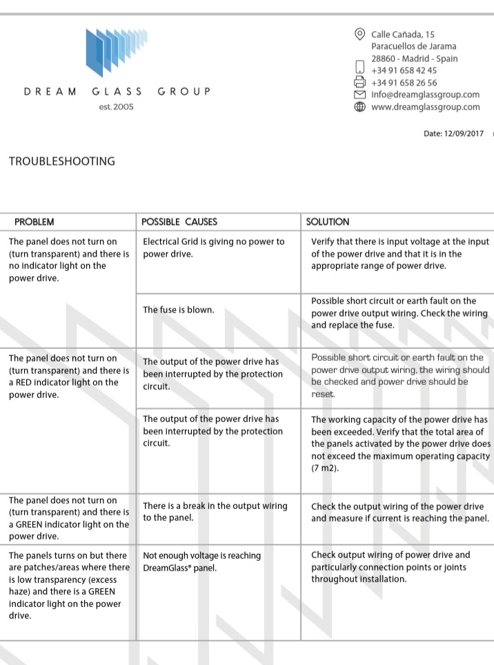

I can't find any information about the item you list, but the installation manual for the modern controllers states: if a fuse blows; 'possible short circuit or earth fault on the power drive output wiring. Check the wiring and replace the fuse':
Not exactly helpful!
Other than that, the power supply should supply a 60V AC output. Have you got a multimeter to investigate?

There's definitely more to the unit than just a power supply, there's a lot of electronics inside it but no sign of anything obviously wrong like a blown cap.

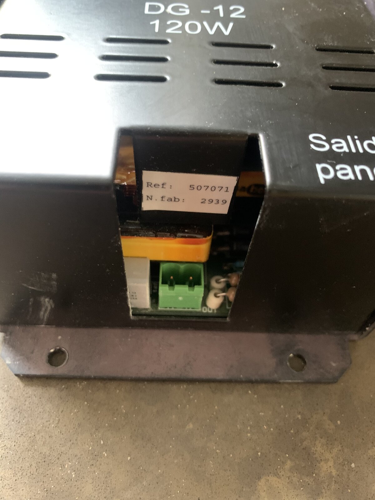

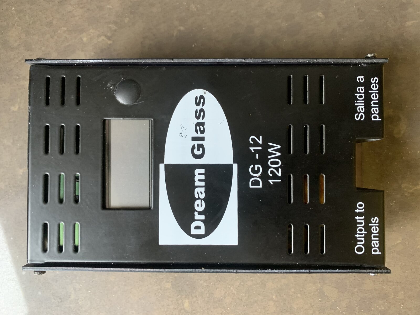

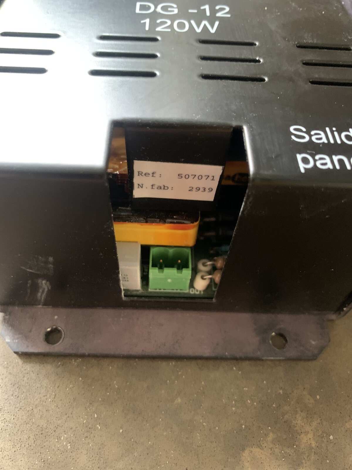

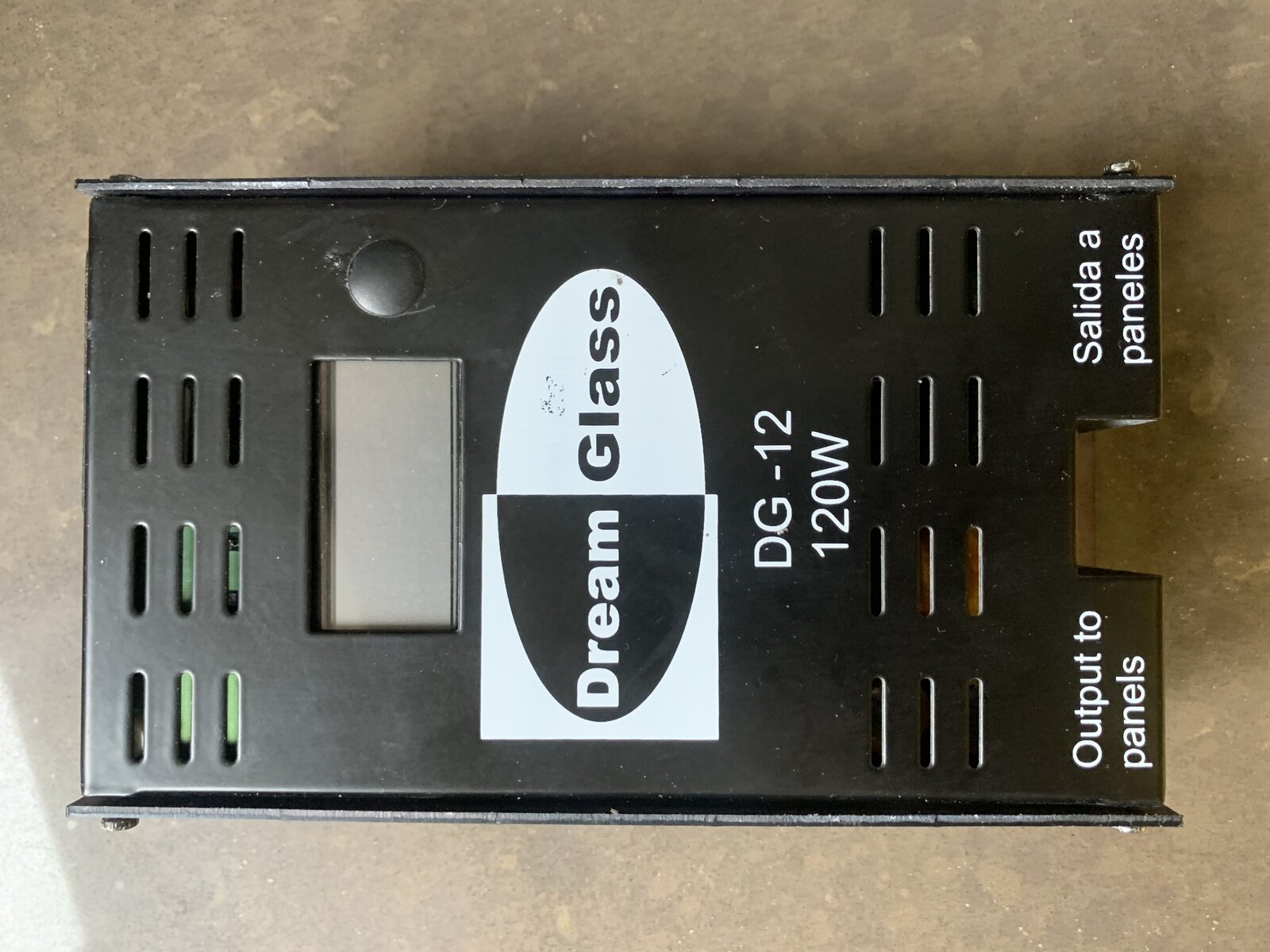

here’s some pics of the unit:

Well the 120W ties in nicely to the expected 120VA!
It is an integrated controller and PSU.
There appears to be a display on the front - I guess this would normally display something if it was working?
You have probably tried this already, but have you plugged it into a different socket with a different lead (and without the load)?
If that doesn't work, then the PSU has probably failed.
However, the resistance of the panels will still need to be checked, or a new PSU could also be damaged!
