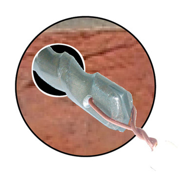

On the drill front, up to 350mm through a wall and I use a 10mm Armeg Cable Guide drill bit which has a hole drilled through it so that you can thread a cable through the hole and pull it through by simply withdrawing the drill from the hole. They do bigger ones such as a 16mm diameter x 600mm as well
