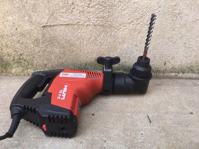

I need to drill a hole through the side of a chimney breast. Thickness of the wall is in the region of 400-500mm. The outside face has a 600mm wide alcove next to it. My sds drill is about 400mm long. This obviously doesn't give me enough room to get a long masonry bit in. Hole size needs to be about 30mm minimum.

That's the problem. I can't get at it with a long bit because the space available is only 600mm. My drill is nearly 400mm long.

You need to start the hole with a shorter bit then, 260mm SDS. (200mm actual drilling depth)
Once you've drilled 200mm, then you can put a 410mm bit into the wall before putting it in the chuck. If you still don't have room, you'll want an intermediate 310 or 360mm length bit in between.
Seeing as you want a 30mm hole, you should use a dry diamond core bit once you have made this pilot hole. Whilst some places sell 30mm, you'll find it much easier to find/buy a 32mm core bit, because it's the equivalent of 1¼ inch in old money. You'll want an extension (maybe two) for the core bit arbor also.
Don't ask how well they perform because I'm doubtful and unaware but Hilti do make them.
Other than that I'd do and have done what rsgaz has suggested.
