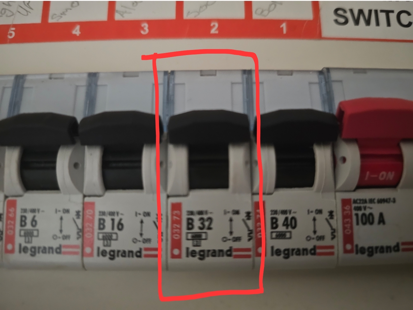

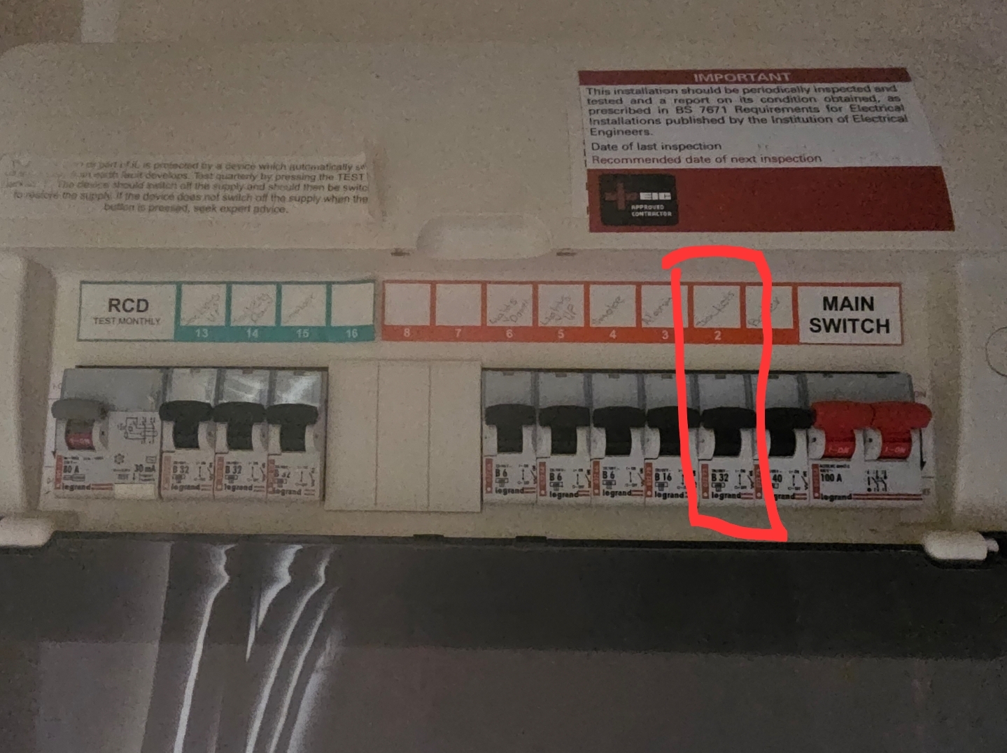

I've attached photos so you can see the exact one that tripped when I drilled the holes.
Before I opened up the wall to locate the cable I drilled I was able to turn it back on without anything tripping.

Ok. That is an MCB so would not have tripped by just touching N & E with the drill, so you must have touched L & E thus causing the spark.
SO now you have repaired the cable do the appliances you mentioned stop working when you switch off that MCB?

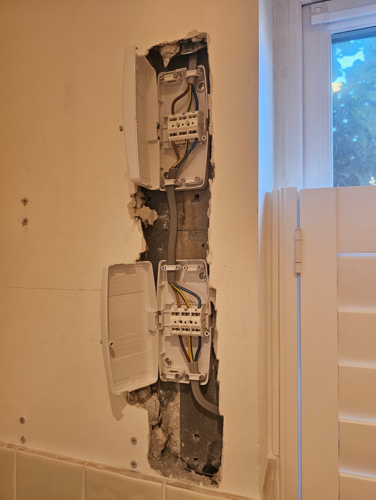

I'm attaching 2 photos of before I added the 2 maintance free boxes and after.
Ok. Can you repair it without burying the JBs in plaster?
Yes switch and fuse panel. That is from the CU
No I need to bury the jbs in the wall as the shelves still need to go up.
I'm not a person to give up on my original goals long as its safe!
I'm keeping it open for another week or 2 before I seal them in the wall just incase we find there is an actual issue.
