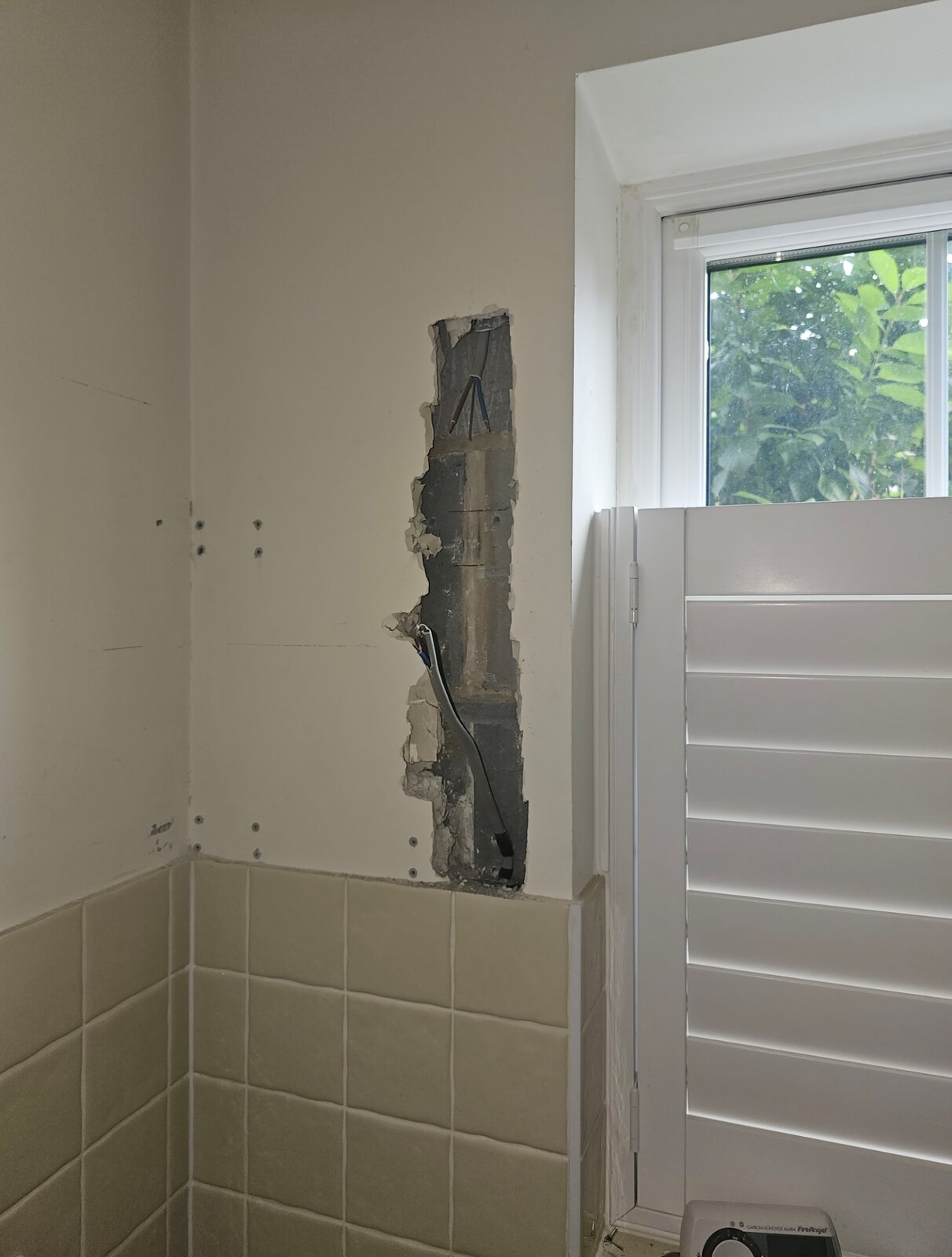

Drilled through cable in wall
Is the grid switch arrangement anywhere near the area you damaged the cable?, if not, then that must be the far end of the cable, and where you see it sneaking off towards the door must be where it is heading to the socket that is supposed to be the washing machine, any chance of any wider angle shots?
No I need to bury the jbs in the wall as the shelves still need to go up.
Yes, but I just meant that there is a difference between covering the JBs with plasterboard or similar and sploshing wet filler all over them.
I'm not a person to give up on my original goals long as its safe!
I'm keeping it open for another week or 2 before I seal them in the wall just incase we find there is an actual issue.

What lies above the damaged cable?
It would be better, as EFLI says, to draw an unbroken new cable in from the outlet under the worktop to the floor above, where you can put a MF junction box in the void.
With a bit of luck, you should be able to draw the new cable through the capping. Just be careful not to damage the sheath on any sharp edges.
