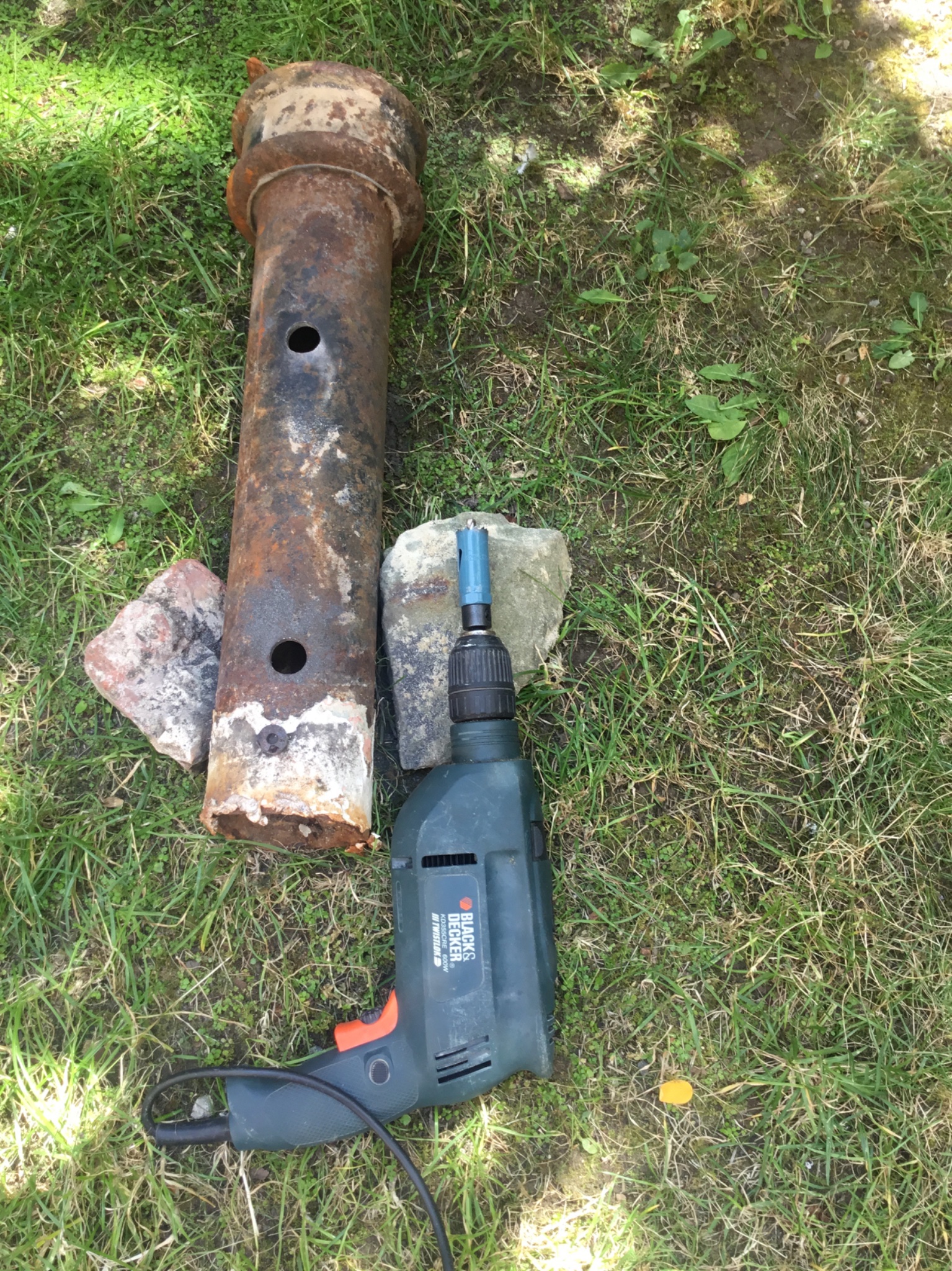

Dear Experts,
How hard is it to drill a cast iron soil pipe? This is to connect a condensate drain from a new boiler. The options are:
(1) Outside to a cast iron rainwater pipe.
(2) Inside to a cast iron soil pipe (which involves opening up some studwork). (I'm in a ground floor flat, it serves 3 flats above me.)
(3) Pump, running to a kitchen sink drain - which would involve poking pipes under floorboards and behind kitchen units.
The aspect that is totally unknown to me is drilling into a cast iron pipe, in order to fit a boss for the new 22mm pipe, for (1) or (2). I've had a heating engineer visit to look at the boiler installation generally and he seemed unenthusiastic about it. Is there a danger of breaking the pipe, for example?
Please share your thoughts.

I’ve just found that McAlpine have bosses for cast iron specifically for condensate that only require a 22mm hole to be drilled:
This feels somewhat less “exciting” than drilling a 40mm hole through the cast iron!

I found someone with a bit of rusty old pipe in his garden that he was happy for me to take away, and I’ve been practicing;
That’s a cheapo Erbauer hole saw, in my old corded drill that I’ve not used for years, set to speed 2. Success; it cuts reasonably quickly with not much force applied and no catastrophic failure.
So do I dare to drill my actual soil pipe???
Adding plenty of lubricant as you go, i'd add.
I’ve done this dry; what exactly would you use for lubrication?
You can get cutting oil but a medium grade mineral oil will do, 3-in-1 is great for that. Another option is to cool it while cutting and that will save the cutting head too - water in a squirty bottle will do the job.
If it's cutting well dry though then great, all the oil/water does is saves the segments from wearing too quickly.
