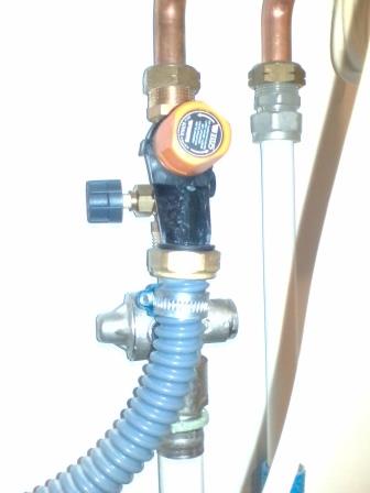

Hi, I live in a block of flats and I recently got the Bulex/Valient same company, serviced.
My question is, there is a drip from a pipe into another pipe which has been cut to receive this water, but I have never noticed a drip before. Is it OK or should I get the service man out again? Thanks.
It's an indication of a fault.
Give him a call and tell him that you can see water dripping into the tundish from the PRV. (y)

You need to be more specific about the exact appliance you have.
However, regardless of this, the photo you uploaded shows a pressure relief valve (PRV) and a tundish (open pipe) connected to a discharge pipe (ribbed pipe in the photo).
This setup is designed to handle the "uncontrolled" expansion of hot water within a sealed system under fault conditions.
Normal expansion is handled via an EV (expansion vessel) and this should cope with pressure increases thus preventing any "let-by" at the PRV, into the tundish.
Next time there is a demand for heat (either Central Heating or hot water) check the tundish again for let-by. Also check any pressure gauge you have for pressure readings above 3bar.
I would call the engineer and inform him of what you have witnessed.

I'd still let the engineer know about the drip and the F1 fault. Your EV needs checking for air side pressure (should have been done during the service).
But, for now, if you're going away then yes, power it off and it also would be good practice to turn your incoming cold stop cock off. You should have one in your flat... Under the sink or in the boiler cupboard perhaps.
as an addendum .... the engineer may also have tested the PRV when the appliance was being serviced.
It is sometimes asked for by manufacturers that as part of the service procedures the relief valve is tested but an experience engineer will know that an older valve can sometime not seal again properly and can let by if it has been lifted. If the engineer did do this test then he needs to know the valve is now passing
