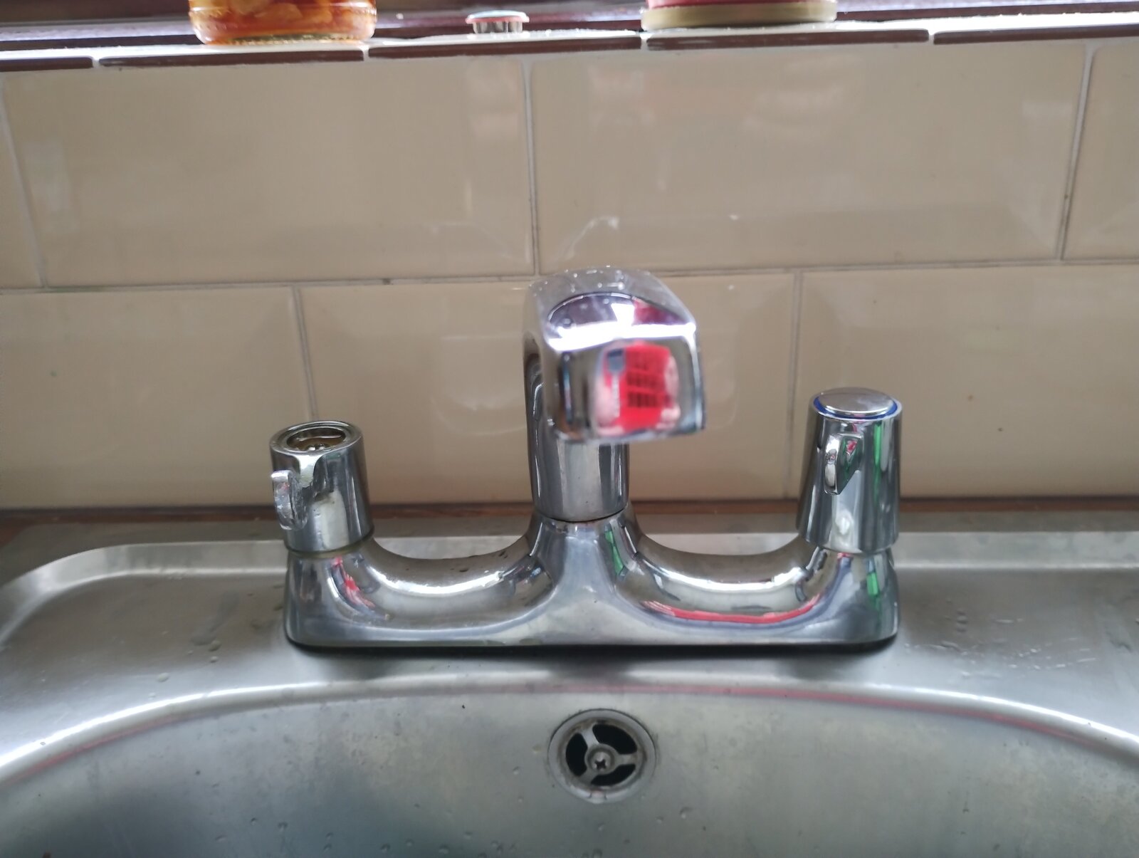

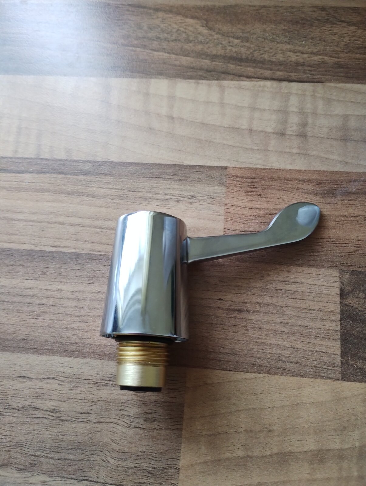

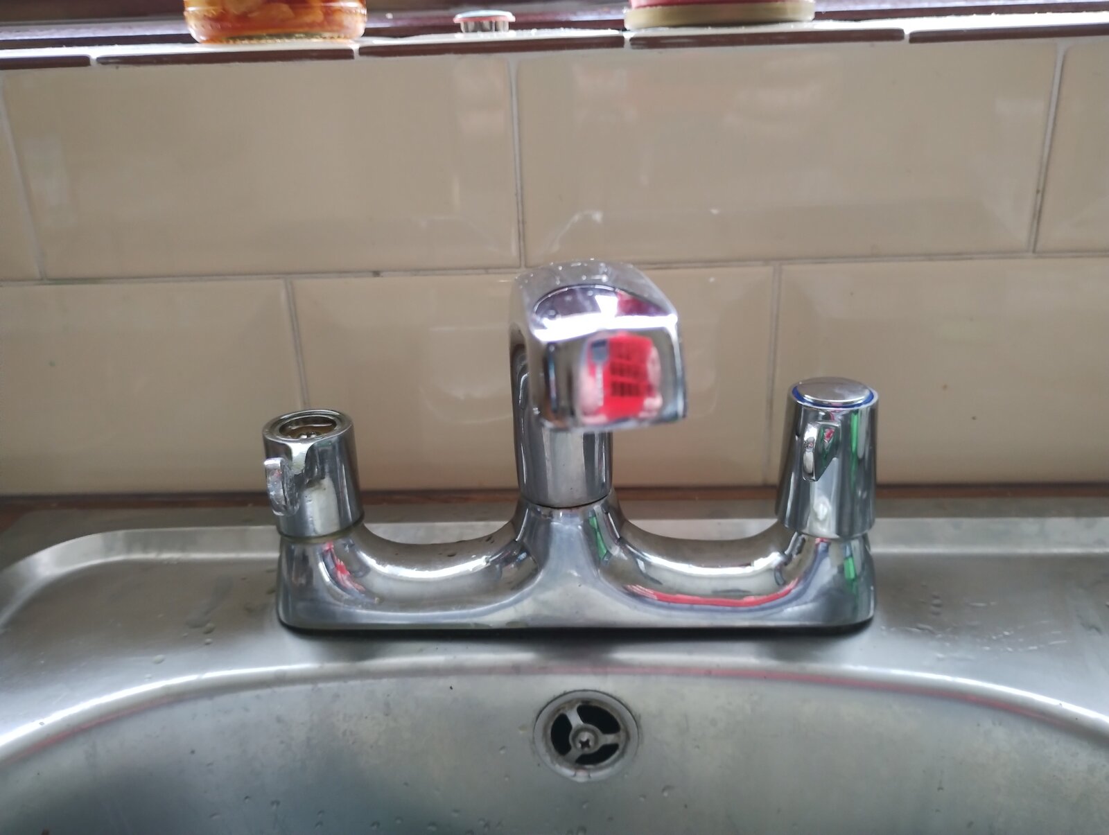

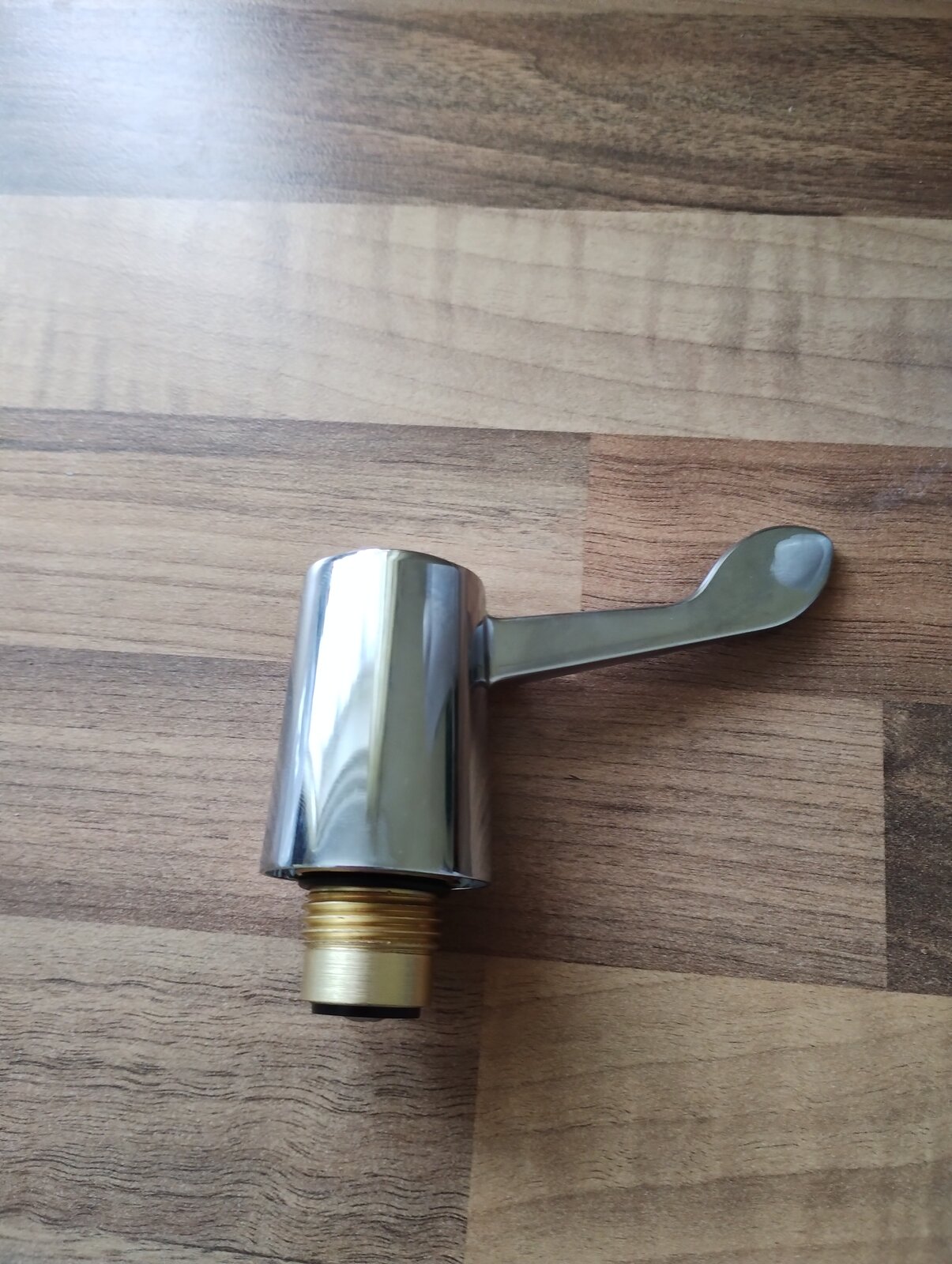

I have a dripping Kitchen tap, I was able to shut off the mains water to replace the cold tap but
there is no isolating valve to the hot tap.
I live in a concrete floored bungalow and the pipe goes under the floor in the kitchen but I cannot see where it goes to,
I would have thought to the cylinder in the bathroom although I cannot see the pipe.
What would you do now in order to change the hot tap?
Thanks for any help.

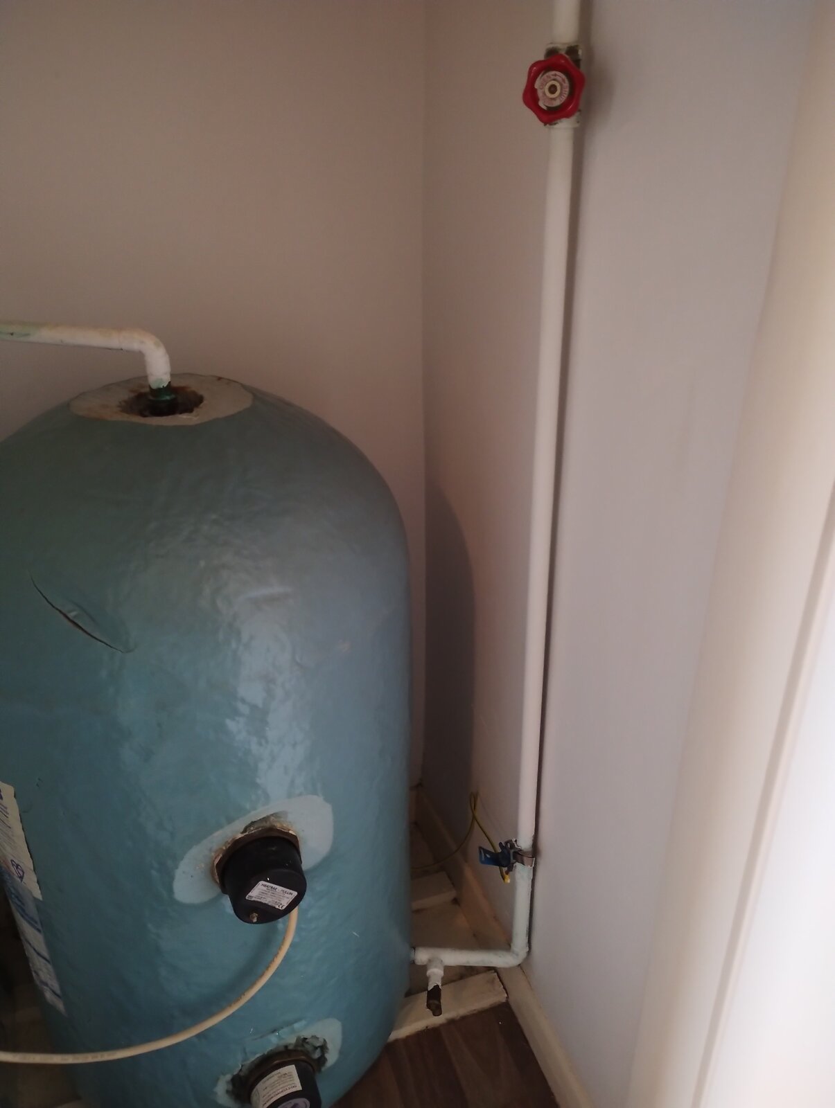

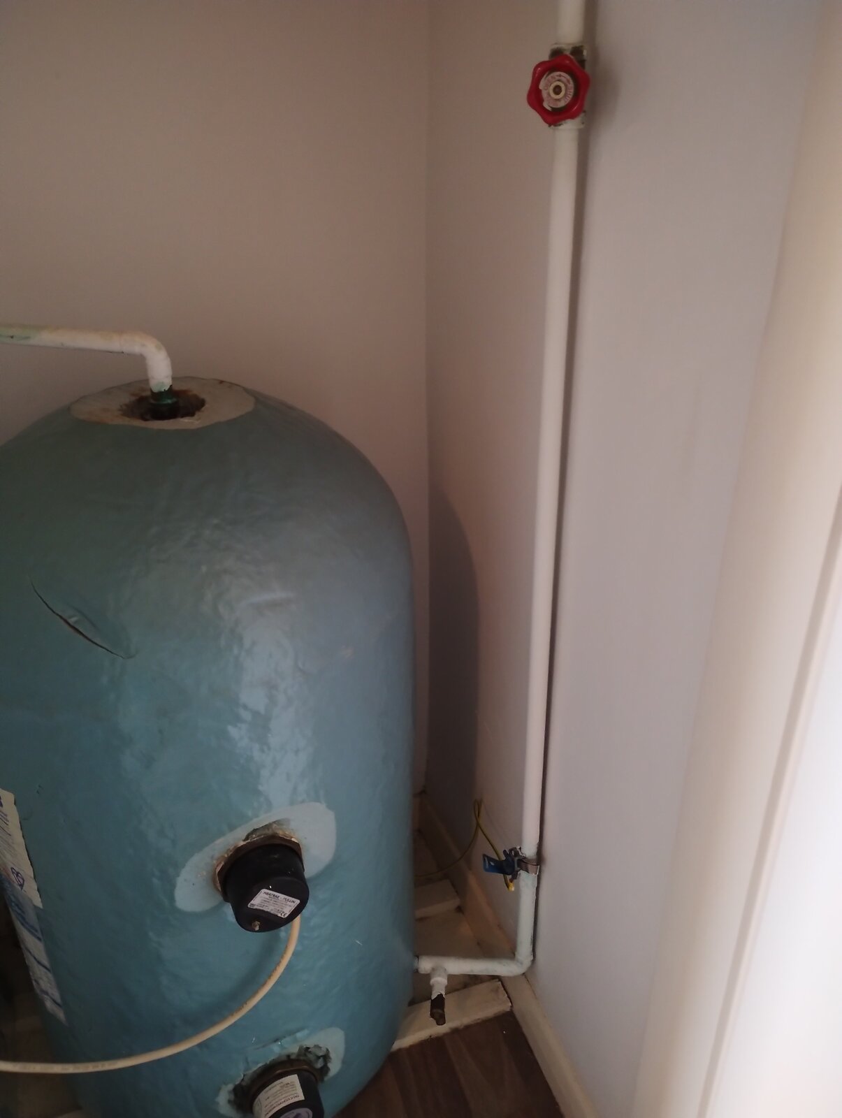

I had a look in the loft and there is a pipe coming from the bottom of the water tank in the loft to the bottom of the cylinder, see picture.
The red valve is completely stuck so would I need to prop up the ball valve in the tank to stop more water coming in and use all of the water in the tank and then change the tap?
You could ,but the entire contents of the hot water in the cylinder would be lost ,and replaced with the cold water from the loft tank.
You could fit a bung to the loft tanks outlet ,that will save all the water loss.
Thanks, great idea. I did not know they existed. Watched a couple if videos in the type to get.
You would think plumbers bungs would not be hard to find on either ebay, screwfix, b&q or toolstation but none of them have the continuous type.
