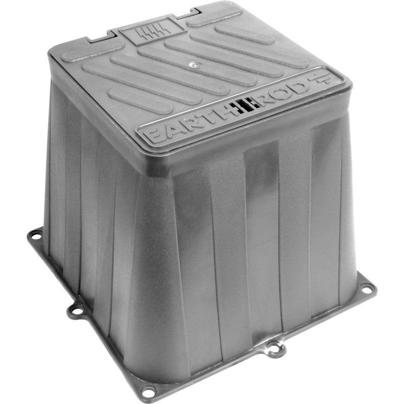

The problem is the land dries and gets wet, so the resistance changes, and the soil normally slowly gets better over time, so return 6 months latter and normally the reading is better, but not always. But in the main by time the rod is low enough to fit the cover over it, 1659687243468.pngas you want to stop anyone being able to touch it when in a fault condition, one rod is ample to make a RCD trip.

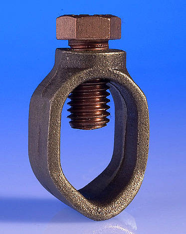

Previously had clamps that screwed onto end on rod, then the clamp this time is as per pic.
Do you just strip end of earthing wire, an put it behind the rod (opposite side of screw) so no need to crimp on a Lug?

Previously had clamps that screwed onto end on rod, then the clamp this time is as per pic. ... Do you just strip end of earthing wire, an put it behind the rod (opposite side of screw) so no need to crimp on a Lug?
I would think you probably have no other option with a clamp of that type. Without a long screw and an additional nut on the clamp, I can't see how you could attach a lug to it (but maybe I'm missing something!).

Same thoughts on the clamp. :)
