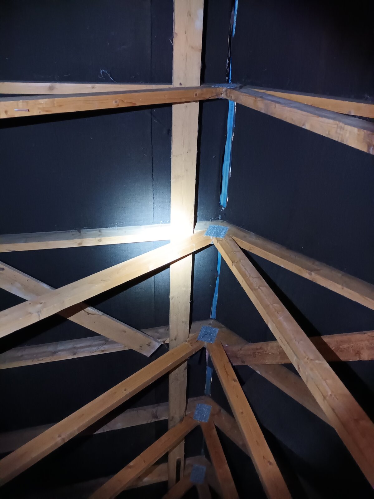

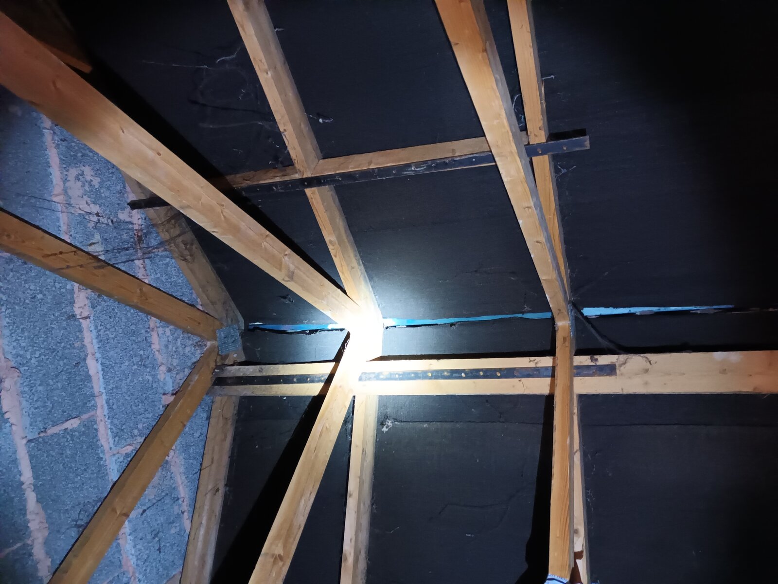

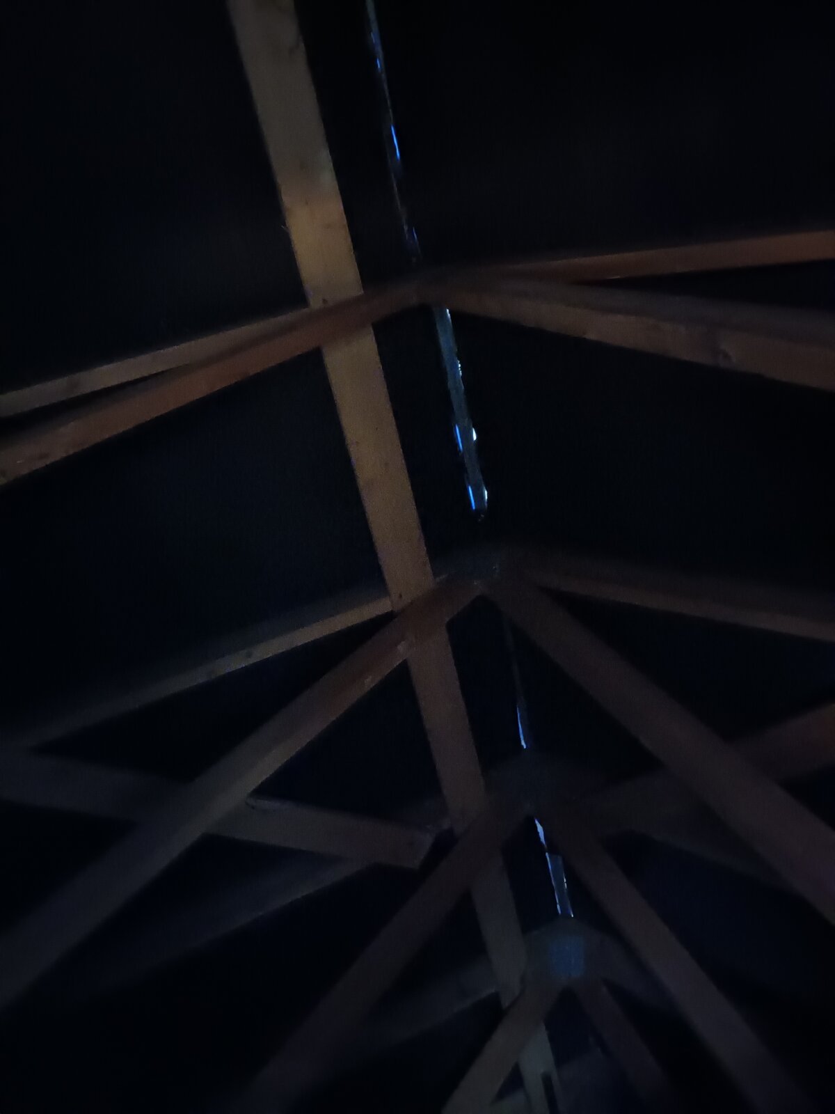

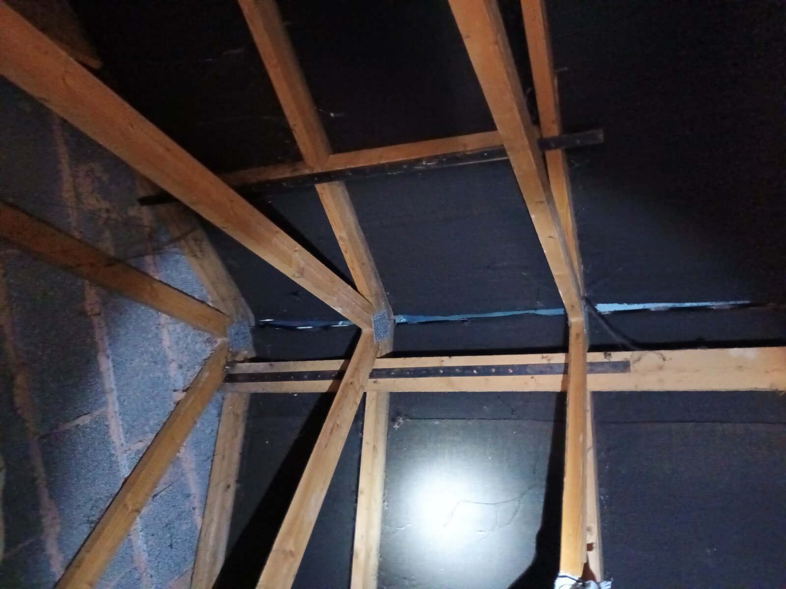

Hi, just had a dry ventilated dry ridge fitted. We had bitumen felt and not surprised that it needed a cut at the apex to allow for ventilation, but a little surprised at this much, is this usual, and I guess it's normal to see daylight which is where the air will flow?

I'm only a DIY'er, but that looks ok to me.
Do you know what kit they used?
The instructions will tell you how much felt to cut off.
This might give you a bit of an idea:
And as in the video, if you have a tiled roof, there may be quite a lot of light coming in :)
Thanks, I'm not sure what system they installed but we've had our first rain and all seems ok, and the condensation is no more, so it's doing it's job!
