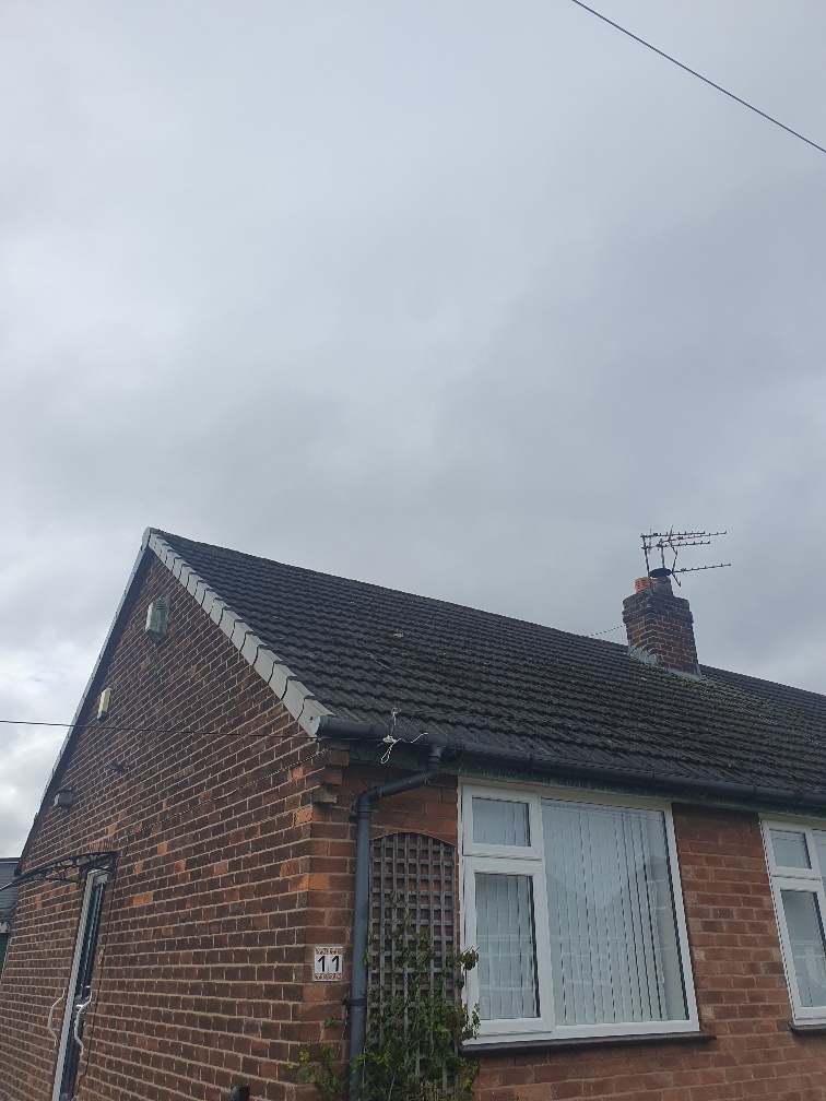

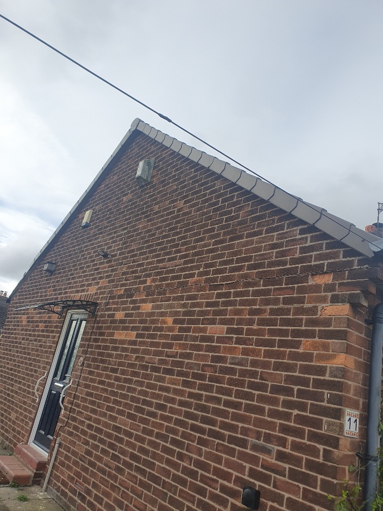

I need the dry verge re-installed and the ridges replaced/repointing.
( The dry verge has been screwed to the mortar so some of them have started flying off! )
All tiles are intact and the ridges are there but there are missing mortar chunks from it.
This is for a small bungalow.
I have been quoted £1800 for the dry verge and £1080 for replacing the ridges.
They said they cannot repoint the ridges cause they crack when they remove them.
The roof has the old bitumen felting that has only slightly started ripping in a couple of places.
Is it worth re-reroofing it if the cost is up to £5000 although I have not had any quotes for reroofing yet. re-roofing will add the breathable felt that won't get affected with time. All the current tiles are fine and no broken tiles.
I'm now 50, I'm wondering if I change the roof and never have to deal with it until i die as this is fr a rental.
QUOTES I received:
ESTIMATE: For reparation work necessary to the above property.
DRY VERGE
To strip of old dry verge and barging to the apex at the side of property
To timber out apex
To supply and fit 11m of black soffit boards
To supply and fit 34 new black dry verge
2 days
34 dry verge
2 black soffit board
11m 3x2
11m laths
Cost £ 1,495.00 + vat
RIDGES
To take of all old ridge capping
Supply and fit 23 new ridge cappings
Cost £ 895.00 + vat
Ensuring waterproof and leaving site neat and tidy
Strip the roof , junk the plastic verges and get more quotes.. some ones trying to have you over imo
