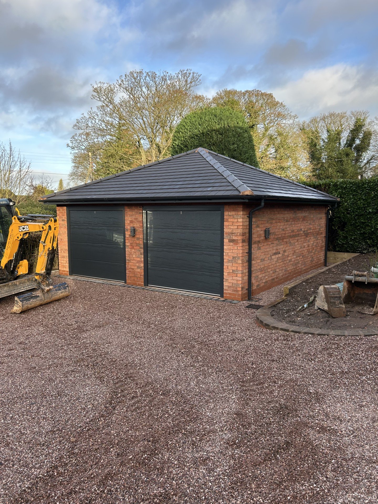

We used the Manthorpe (universal) for these. Piece of cake.......
+1 for the manthorpe system. It was recommended to me by my local roofing supplier, and I've used it on a couple of buildings now. Easy and decent quality.
Thanks, my local merchant JT Dove seems to stock Manthorpe, they can provide the suitable ridge tiles and end caps too. £45 per 6m kit. Looking forward to a warm April day and a few well-earned ales afterwards.
