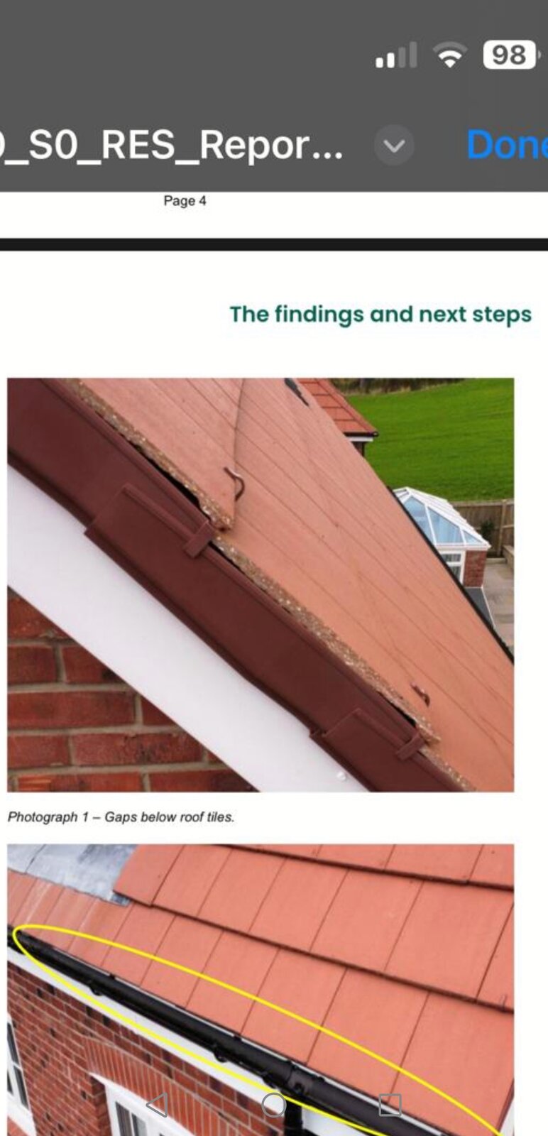

Hi all, my partner and I bought a new build 2 years ago, and continue to suffer from draught coming in behind our bedroom wall which has not been resolved by the builder (Anwyl). I feel like I've located the area outside where it is coming in. Could the dry verge be the cause of our issue? Could it be coming under the tiles?
Many thanks in advance.

WTF are those dry verge units???? :confused:
IMO and it's an old fashioned one, but I much prefer a verge where the tiles are secured and sealed-in by a good well mixed cement mortar, then you know the roof's integrity is complete(y)
I did mine that way, 40 years ago, and it's still fine. I simply made up a guide, from two lengths of steel angle, welded together. That rested on the tiles, and against the wall, then filled in to level with mortar.

It's good to read that your roof is still sound 40yrs after you completed it, but unfortunately many verge 'repairs' are purposefully made with a weak and poor mortar mix in the knowledge that the repair will not last long and they or another will be back in a few yrs time repairing the verge again.
