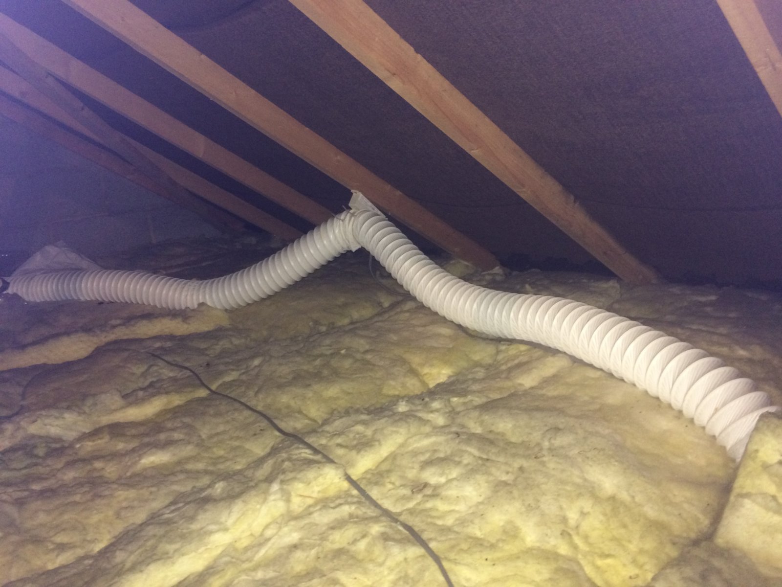

So, I moved house last year and all has been relatively good so far - however, a slight snag has been that in the recent poor weather we've had a leak in our loft.
Upon further investigation it seems that the ducting from the bathroom extractor fan to the external wall has served as a mouse house at some point and repairs were made with tape that finally has given up the ghost.
When it comes to replacing the ducting, do I just replace the whole ducting (using something like Manrose PVC Flexible Ducting Hose) - or does it depend on the extractor/vent in question with regards to how you'd approach this and suitable fixings?
Thanks for any guidance
You might as well replace all of it; I doubt you can get short lengths.
Make sure it has no dips where condensation can accumulate.
please show us a photo of your current arrangement to see what will fit easily.
If you can run (most of) the duct in rigid tube, you can slope it slightly downwards as it goes outside, so condensation drips out. Rigid tube doesn't accumulate so much dust and fluff, and rodents can't gnaw it.
Condensations only a problem with low powered fans , a decent fan shifts the damp air and also evaporated any moisture in the ducting.

Attached is the only photo I have of the loft (currently away from home), I hope that the fact that the duct goes up and then down is nothing of concern (the one on the other side does a similar thing), but the biggest issue I imagine will be the lack of easy access.
So, under the insulation it's connected to the fan, and then leads away to the outside (which is where the tear was).
