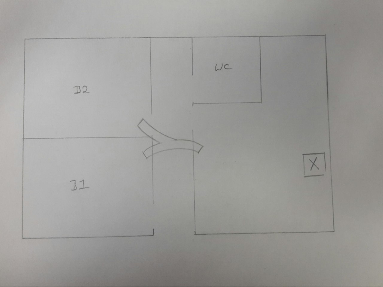

I wasn't sure where to post this, so apologies if it's in the wrong place.
Single storey cottage with two bedrooms and living/dining room. I have a wood burner in the living room which makes that room nice and warm. Warm air doesn't circulate around the house particularly well, meaning the living room can be 25C and the two bedrooms significantly colder, down to 12/13C in the winter. I was wondering about putting a louvre in the living room ceiling and running a 150mm insulated duct to a similar louvre in one or both bedrooms, assisted by an inline bathroom extractor fan. The idea being warm air at ceiling level would be extracted from the living room and moved to the bedroom/s, which would slowly push air out of the bedroom back along the hall towards the living room . Duct length would be around 3m. Would plan to have the inline fan controlled by an on/off or timer switch in the bedroom.
Is this likely to be completely ineffective, or have some potential?
Any building regs I need to be aware of e.g. breaking a fire barrier (plasterboard ceilings)?
Total cost probably around £50 which I'm happy with, but don't want to spend hundreds.
As it's single storey, loft access it easy and I have spare insualtion I can simply drape over the ducting. Is it worth doing?
X is the fire in the living room. B1/B2 are bedrooms. Ducting location shown, going over the hall ceiling and down through bedroom ceilings.

Extracting air from a room with a log burner can be hazardous. If there is in-sufficient ventilation and replacement air cannot get to the room then the log burner will not have adequate air for proper combustion. It maybe that air flow in the flue is compromised, worse case reversed, and fumes escape into the room.
It may be better to extract cold air from bedrooms and send it into the room with the log burner thus creating a slightly positive air pressure in that room with passive ducting allowing warm air from the room to reach the bedrooms

There is plenty of ventilation in the draughty old house, but thanks anyway. The reason I wanted to move the hot air is I can easily duct from the living room at ceiling level (where the hot air is) and move it into the bedroom at ceiling level. The air cools in the bedroom, sinks down and the air is moved back towards the living room by the tiny positive pressure in the bedroom. Ducting at low level for cold air would be much harder in this house, but would be neater... I'll have a think about it, thanks for the idea.

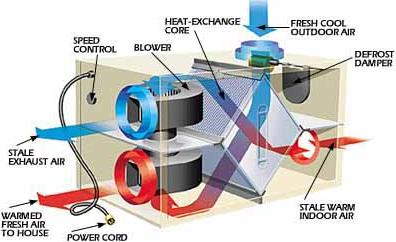

My first house was hot air heated, there were ducts taking air to each room and vents in every door for it to return, I would think a heat recovery unit could remove warmth in the air from one room and return that warmth to another so heat can be transfer without transferring the actual air.

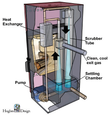

From what I understand modern wood burners also need doors to run both efficient and without producing particular emissions, there has to be an after burn and the output is very controlled, as a result the old idea of banking down a fire or having a roaring fire has gone, to stop emissions it burns at a set rate, which is not what we want, so the normally way is a heat store, so you can light the fire in an evening and then use that extra heat during the next day.Hughes Condensing Stove 2 small.jpgThis fire is only one I found which was condensing but not as complex this one wallnoefer.PNGshows the twin air input of the modern wood burner, and this mechanical-heat-recovery-system.jpgidea of the heat recovery unit. Nearly every efficient wood burner today heats water, and clearly if yours heated water you would not need the duct to move heat, I have a open flue wood burner, but it is an emergency method of heating only, used if we run short of oil only, and maybe Christmas day. We would not dream of using it daily to heat the home. However likely when built that was the idea of the fire.

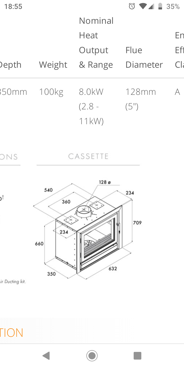

It's a stovax Riva cassette. I haven't fitted it yet so can't comment much more. I have got an external air supply for when I do as it's going in a modern airtight extension. Here's a picture:
My extension is massive so I won't have any spare heat to send anywhere else so I just have the basic unit - the heat comes out of the front.

So in this case, it's a small change like the one we're talking about (ducting) or nothing at all. I understand your point about identifying where the air supply currently comes from. In this case I can shut the door between living room and bedrooms and the fire happily carries on drawing air from all the other draughts in the house. Opening that door a small amount doesn't suddently introduce a gale though the gap, so I'm happy the bedrooms/hall aren't contributing a significant amount to the air demand. Assuming that's true, the ducts shouldn't be a route for combustion air any more than the hallway already is (isn't).
I think I'm going to price up all the bits and see if I'm happy with the appearance of louvres in the ceilings in the two or three rooms. If so, I'll give it a go, unless I find a building reg in the meantime that says that connecting rooms by ducts isn't a good idea. The alternative is a fan in the hall, but that doesn't allow for return airflow.
