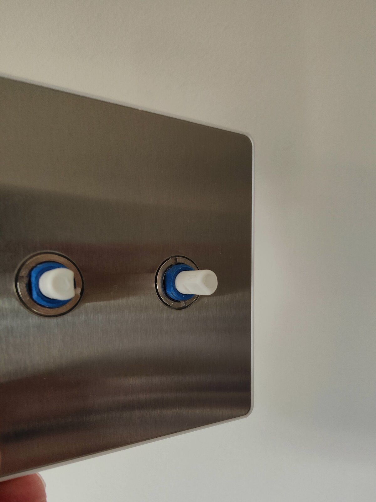

I have a 2 gang switch on/off controlling two sets of lights, and one light can't be dimmed. So I will be buying a new double gang dimming light switch but I will need to replace one of the switchs with a dummy dimmer to keep it looking the same.
Do I need to match the faceplate with the switch module or are different brands interchangeable?
BG DUMMY DIMMER SWITCH 2 WAY PUSH ON/OFF, 8A OFFSET SPINDLE
Have a look at your existing dimmer module and see if it is an offset or symmetrical design and buy the switch module to match. You will use the existing faceplate and push button. It really isnt that difficult.

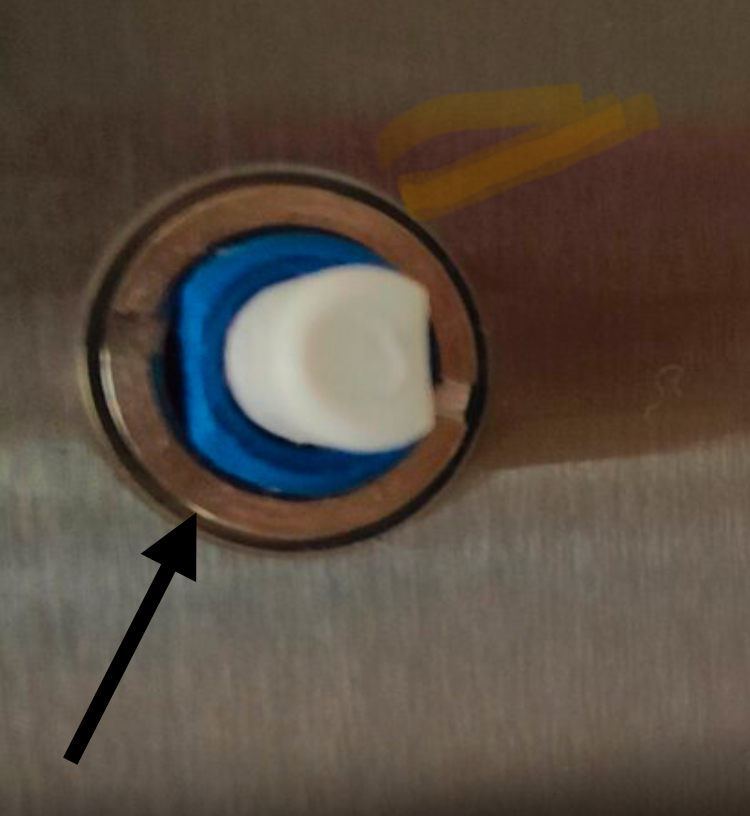

Thanks, how do I disconnect the module from the back of the faceplate.
