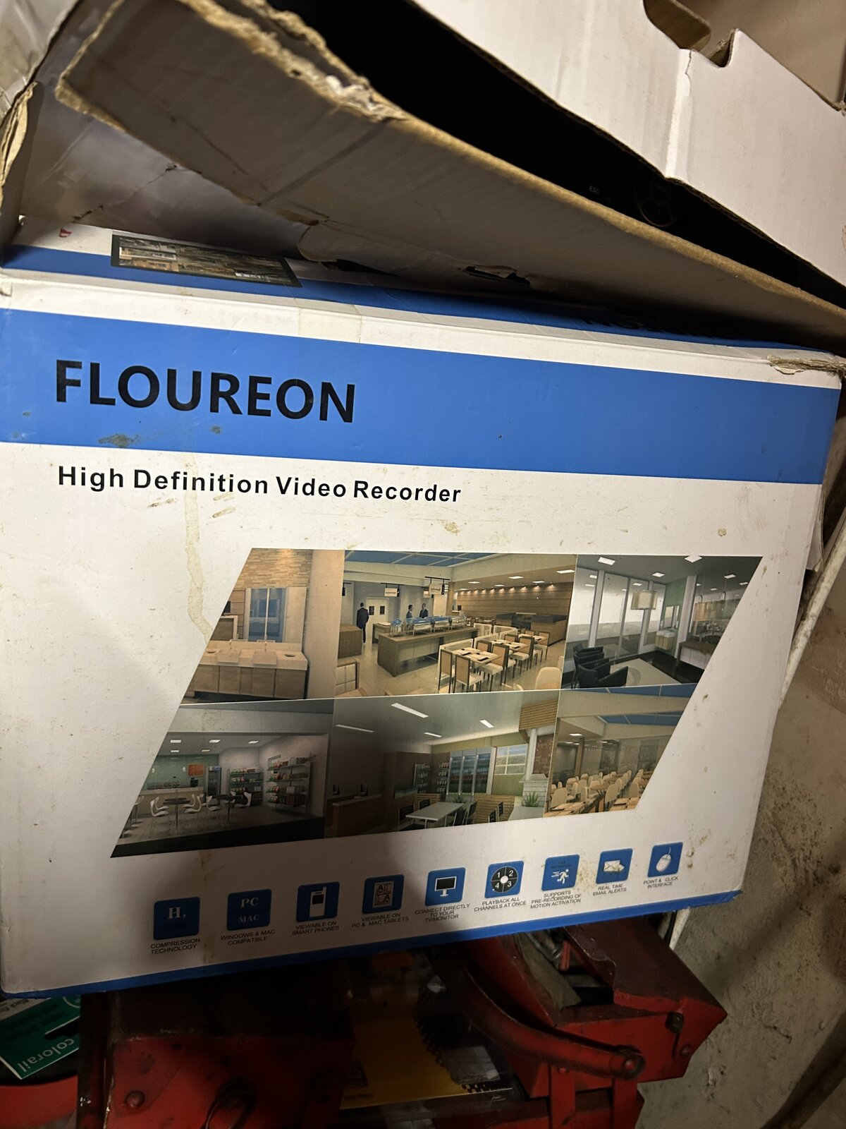

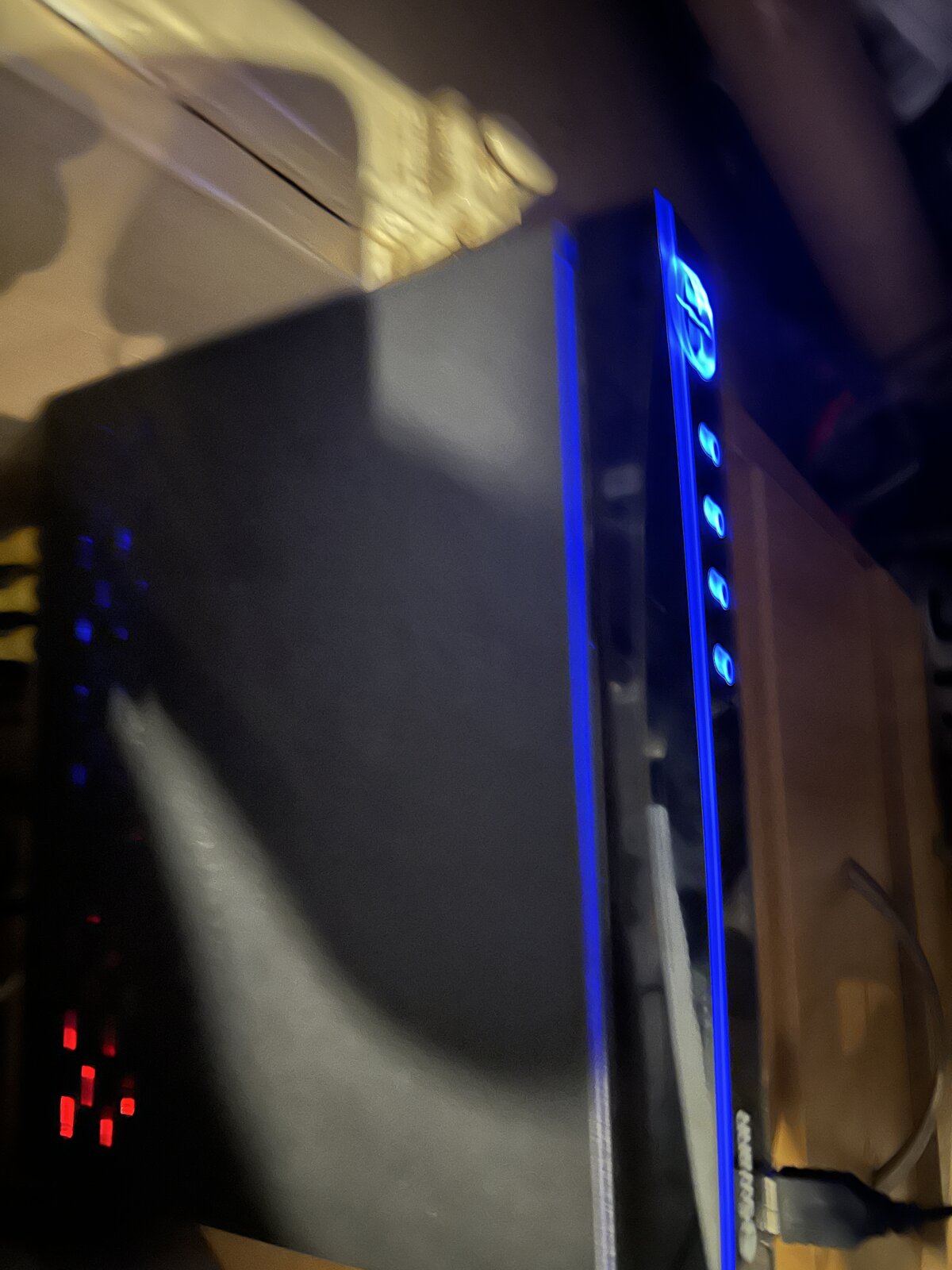

I’ve had a Floureon dvr for a while and it’s gone. So had a Swann dvr and changed it over , Only one camera is working ? Does anyone know if there is a setting what needs to be changed and if so where can I find it !thanks
5 are the same and one is a ptz camera .It’s one of the 5 what is working.

So the old dvr hard drive went (tried in others ) didn’t work ! So left it running till new one arrived.it then just died no pics nothing . Tried on really old dvr with no name and all apart from the one working now worked .Put the Swann on and only the one works . I personally think they’re not compatible .
