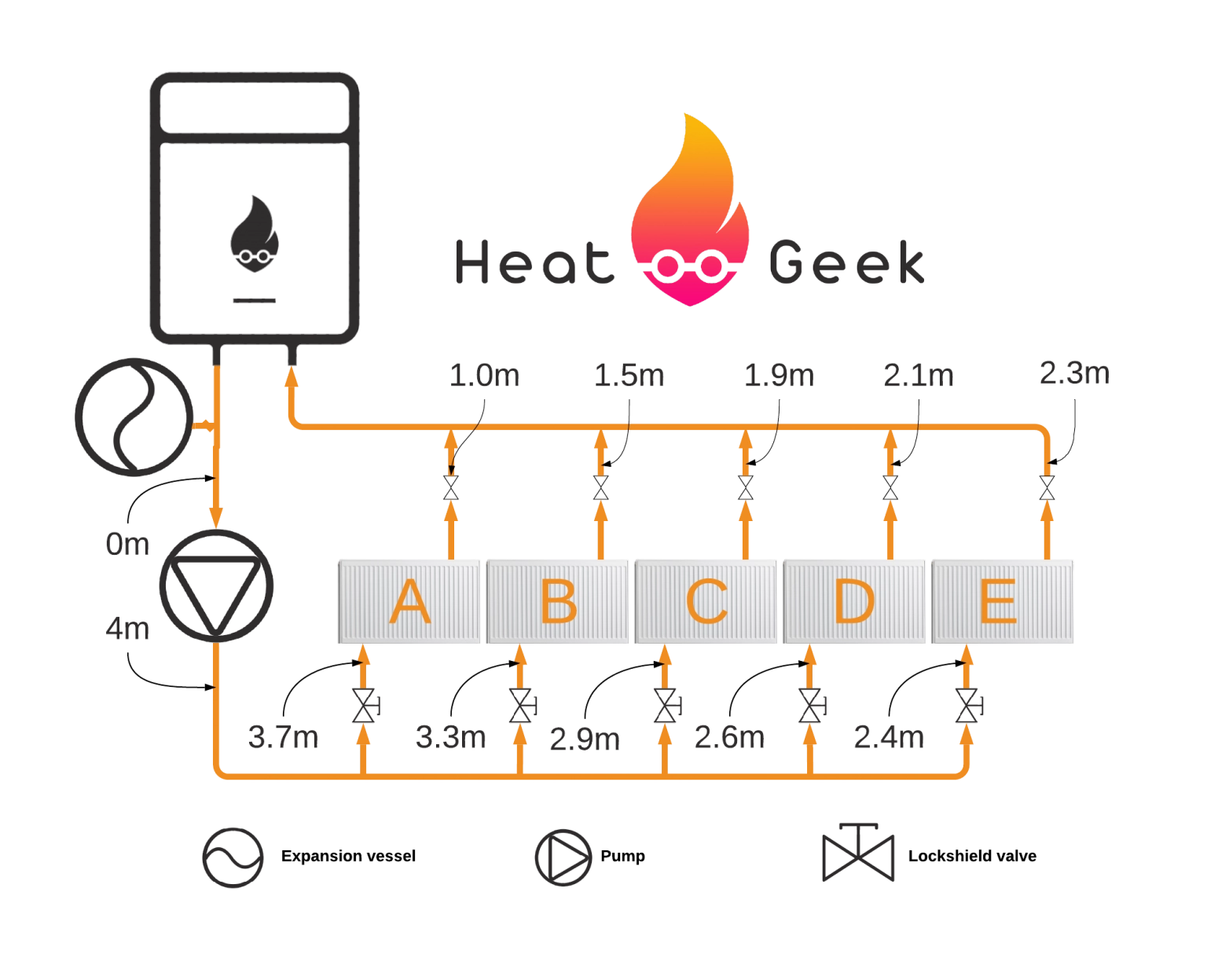

Most 15mm TRVs or LSVs have a Kv of 0.75 to 1.0, this means a flowrate of 0.75m3/hr/12.5LPM to 1.0m3/hr/16.67LPM at 1 bar diff head. At a 1M head this is 3.95 to 5.27LPM, the flow through a TRV+Rad+LSV is probably ~ 3.3 to 4.2LPM, this doesnt mean that 10 rads will flow 30 to 40LPM. I have 10rads, all with TRVs, no balancing and a pump head of 3.6M give a "average" rad dT of around 10/12C. and my A rated pump power of 22W = a flowrate of 12/15 LPM.
If you aim for a 15C rad dT then you should try and get a flowrate of 1.0LPM/rad.kw (actually 0.96LPM).

I thought balancing radiators was essential but if I have TRV’s on nearly all my radiators do I still need to balance them to even out the flow rates.
Yes, the rads really should be balanced, I have two zones with 5 rads/zone but one zone only normally on, so after the heating has been on for around 1.5 hrs in the morning the TRvs take over for the remaining 13/14 hours that my heating is enabled.

I have a nine radiator system, with TRV's on all but the hall rad, where the wireless thermostat is located. I have never, ever balanced them, they have always everyone one, got hot enough, even before I added TRV's. Now with TRV's fitted, I think I have even less reason to bother balancing them, because even if they were balanced, the balancing would only limit the maximum flow, whilst the TRV was wide open. Once the TRV begins to be satisfied, begins to close, the balancing makes little or no difference, in my view.
