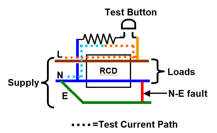

The reason why the manufacture has came up with this because I think this can be an issue with RCD test buttons, if the neutral is linked to earth at the origin and a fault links N-E after the RCD, then there is a current path which bypasses the sense coil in the RCD. Very small or no current flows in the coil so no trip.
Maybe I need to think more deeply but, at first sight, I don't get that suggestion.
As per the diagram below, as I see it the test current through the L side of the RCD will be the same whether or not there is an N-E fault downstream of the RCD, and the current through the N side of the RCD (zero if there are no loads) will also be the same whether or not there is a downstream N-E fault - so the residual current created by pressing the test button should be the same regardless of whether or not there is a downstream N-E fault/ What, if anything, am I missing?

That's what seems a bit daft about all this. They don't seem to be suggesting that the device is incapable of responding to N-E faults in the presence of loads (which, as you imply, would be crazy) but, rather, that a N-E fault may stop the device responding to the test button. being pressed However, if there is a significant N-E fault then if there are any loads, it's very likely that the device would trip anyway, regardless of whether or not the test button would work!

Are we not looking close enough?
Your diagram shows the RCD alone.
Reconsider with an AFDD stuck on the front end and a load on the back end, it may become more apparent.
I don't see diagrams for AFDD's that show any more than a black box approach, so that may have some bearing on the situation.
Are we not looking close enough? Your diagram shows the RCD alone.
It does.
Reconsider with an AFDD stuck on the front end and a load on the back end, it may become more apparent. I don't see diagrams for AFDD's that show any more than a black box approach, so that may have some bearing on the situation.
I suppose you may be right. I know very little about how AFDDs work and (although I clearly may be wrong) had assumed/guessed/whatever that the test button merely tested the residual-current sensing functionality - hence why I just considered an RCD.
However, regardless of thst, I think it's still true that the question is pretty moot, since the device in question is an AFDD/RCBO, and hence obviously should have RCD functionality. That being the case, one would expect that, in the presence of any significant load, an N-E fault would cause the device to trip, regardless of any considerations of the test button functionality, wouldn't one?
You would think so, but as the manufacturers have stated the potential issue in their instructions they must be aware of a set of conditions that would create the issue.
We can speculate from now until domesday, but the answer should come from them in minutes.
