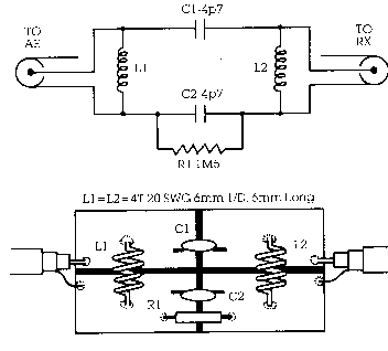

The problem is electrical storms are attracted to nearest earth, so to earth means more likely to get a lighting strike, with the long wires used for ham aerials this can be a big problem so a set of resistors and a spark gap is used to leak away voltage so when we reconnect after an electrical storm we don't get a shock from the build up of static.

Not so sure with satellite, but with simple aerials the aerial is NOT earthed, the distribution amplifier may be earthed, but not the aerial, normally there is a filter or braid breaker
both stops out of band signals which could swamp the amplifier/splitter and any atmospheric voltage going down the line, if you earth an aerial it will not work, and it will also increase the likely hood of a lighting strike.
You could earth a false ground plane, the aerial would still work, but it would still increase likely hood of a lighting strike.

I have seen the result of earthing an aerial, all that was left was a row of copper beads on the ground, to earth an aerial you would be looking at a cable size of a lighting conductor, as that is what it would become, this report for churches says 8 mm diameter rod, that's around 50 mm² so the earth to aerial would need to be size of welding cables.
P.S. the circuit is not mine, it was the old radio investigation service pre digital became DTi not sure what called now, so it has come from a UK government department.

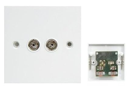

I would not consider a "Communal satellite dish" as domestic, it may feed domestic, but would consider the dish to be commercial. There are two types of aerial sockets, those with capacitors to stop DC used for connection direct to aerial, and those without used to connect to a booster, the latter I find are hard to find, required with the old Sky magic eyes, and with mast head amplifiers were DC is sent up the coax.
note the circuit board and components this is common, the combiner in the loft would likely be earthed, but not the aerial.
Those are not aerial sockets, they are unscreened rubbish. Never use those, they let interference in and will radiate if on a frequency translated communal system.
Capacitors are not required on a direct aerial. They are used on communal systems if not earthed to prevent fault voltages from one property to another.
