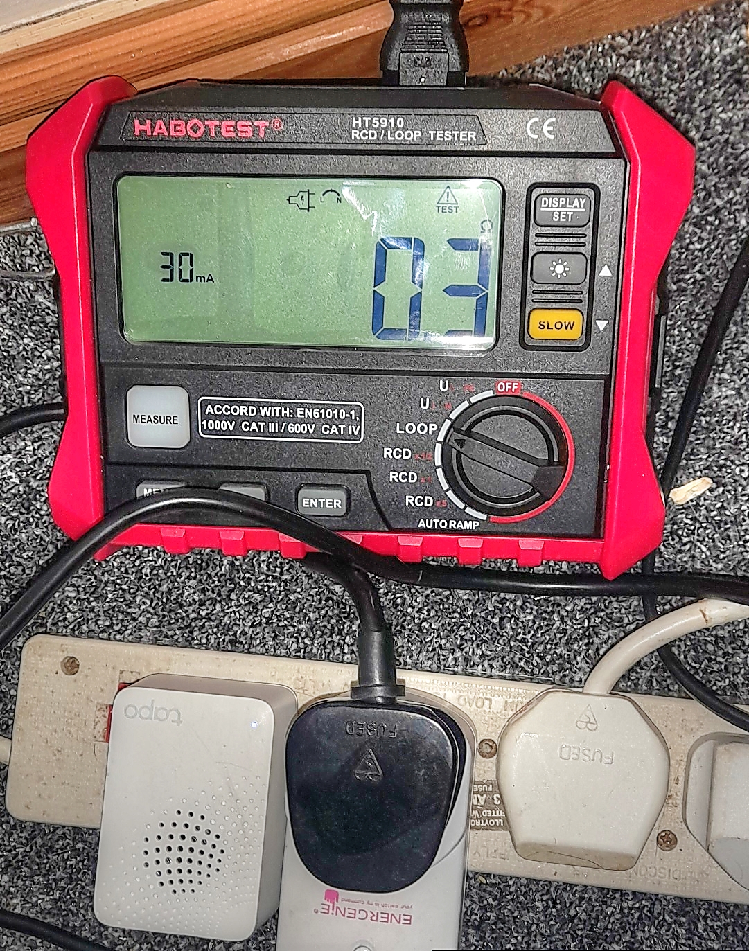

The earthing rule came out in 1966, to have wiring older than that, often means the cables need replacing anyway. The problem for most is to test the earth, my tester, Loop-test.jpg a socket is easy, as we have a neutral, plug in wandering leads and the light fitting also easy, but to test a switch with no neutral to run the loop impedance meter, means using a low ohm meter instead, so you need a reference point.
So yes, the switched cpc connects to light's cpc, but how will you test it?
