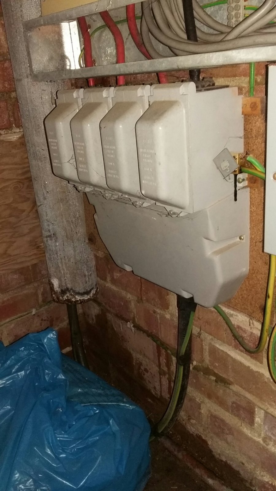

Is this a TN-S do you think.
Im sure a pro will be along, but in the meantime: Im not certain the information is in the picture........
It looks like TN however only the DNO can say if TN-S or TN-C-S as only they know is some where along the supply root is the earth and neutral have been combined or not.
A big clue as it if TN or TT is the ELI, although a TT supply can have a very low ELI in domestic unlikely to be under the 0.35Ω considered as limit for a TN-C-S or 0.8Ω considered limit for TN-S however with a three phase supply to commercial that does not really work. In one job I spent 6 months knocking in earth rods, non over 8Ω and main earth pit under 1Ω and the incoming earth connected through a large resistor to limit earth current.
So only real way to know is ask the DNO.
It looks like TN ...
It does, and if it were TN-C-S, one would expect to see a 'PME sticker'.

It looks like TT. You can see that that g/y is taped to the sheath of the supply cable, and is heading off somewhere - to an earth rod?

There's also a Brass connector block sticking out to the right of the Neutral with an Earth connected going to the MET, Perhaps the DNO just wanted people to guess :rolleyes:
I think TN-C-S .
Would like to see another photo taken back a bit more

Bit more info
Its central London (Westminster)
Ze of 0.09
PEFC 2.5 kA PSCC 2.5 kA
So doubt a TT
Readings made me think TNCS but connection/separation must be under the pavement
Earthing conductor taped to the supply cable disappears in a hole in the basement wall, seemingly connected under the pavement...
Readings made me think TNCS but connection/separation must be under the pavement. Earthing conductor taped to the supply cable disappears in a hole in the basement wall, seemingly connected under the pavement...
