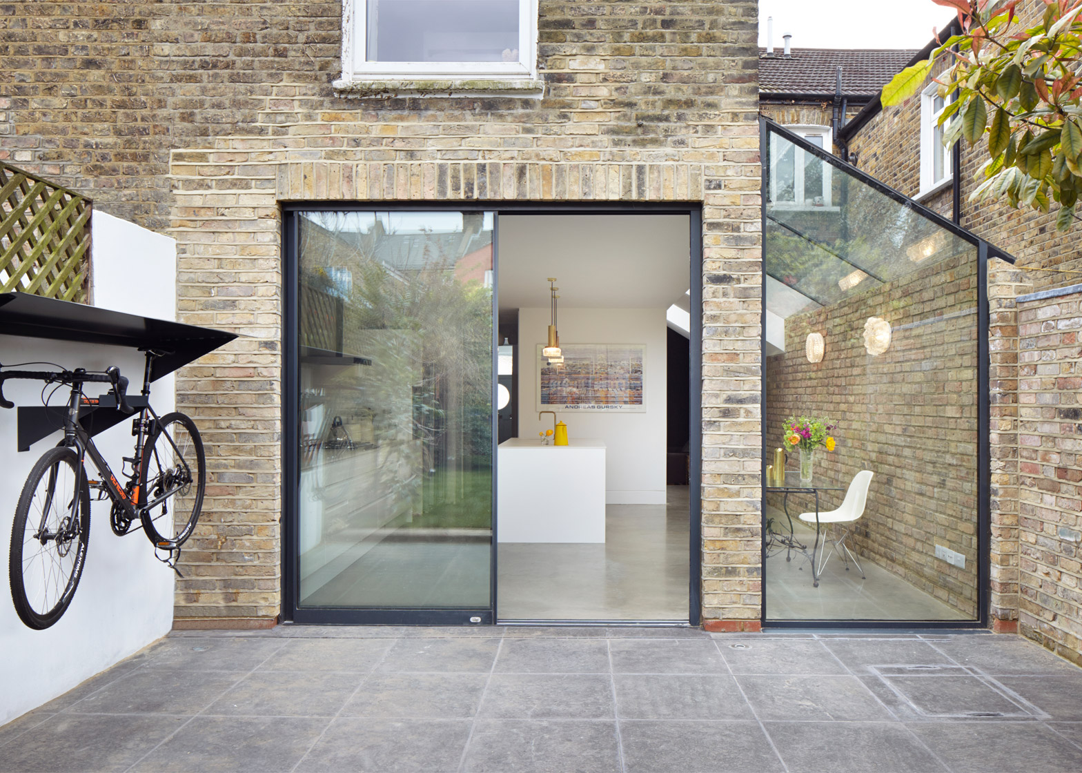

My only reservation with installing the proper doors now would be that a steel beam needs to be installed prior to this. See pic below. This is what we're ultimately after. Beam needs to go in, wall gets opened up and then the large windows/doors go in.

that looks very cold too! Why not have a proper extension done, with loads of insulation in the floor, walls and roof?
We considered a proper extension but to be honest the cost put us off. Just to replace the lean-to the cost of the extension itself would be around 35k. Perks of living in London I guess.

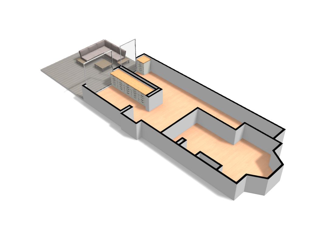

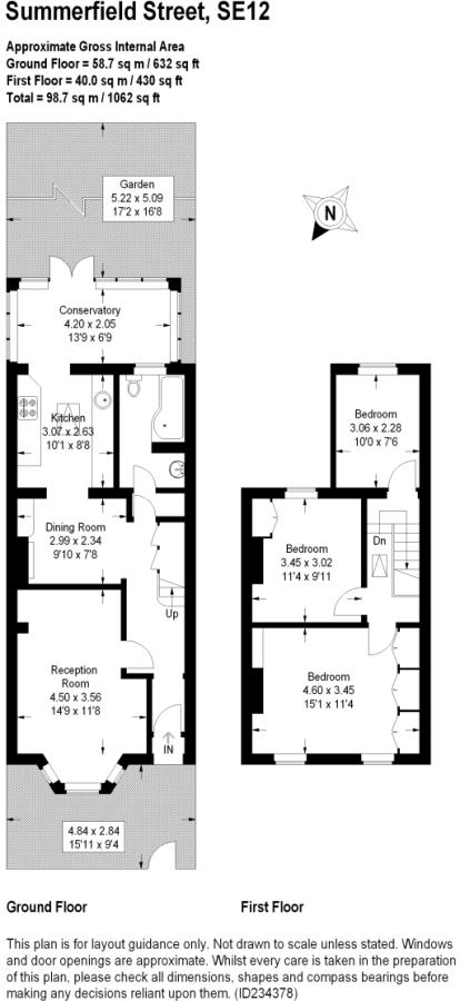

so you plan to open the wall up more than it is now?
Yes. I've attached our floorplan as I'll do a poor job explaining. It is how the property exists as of right now. I've also attached a mockup of what we'd like to achieve. The wall isn't completely glass. I don't want to boil us in the summer and turn the kitchen into a hotbox. The wall between the kitchen and bathroom will be removed to make way for one large galley style kitchen. There are other works towards the front of the property planned but these aren't relevant to this.
