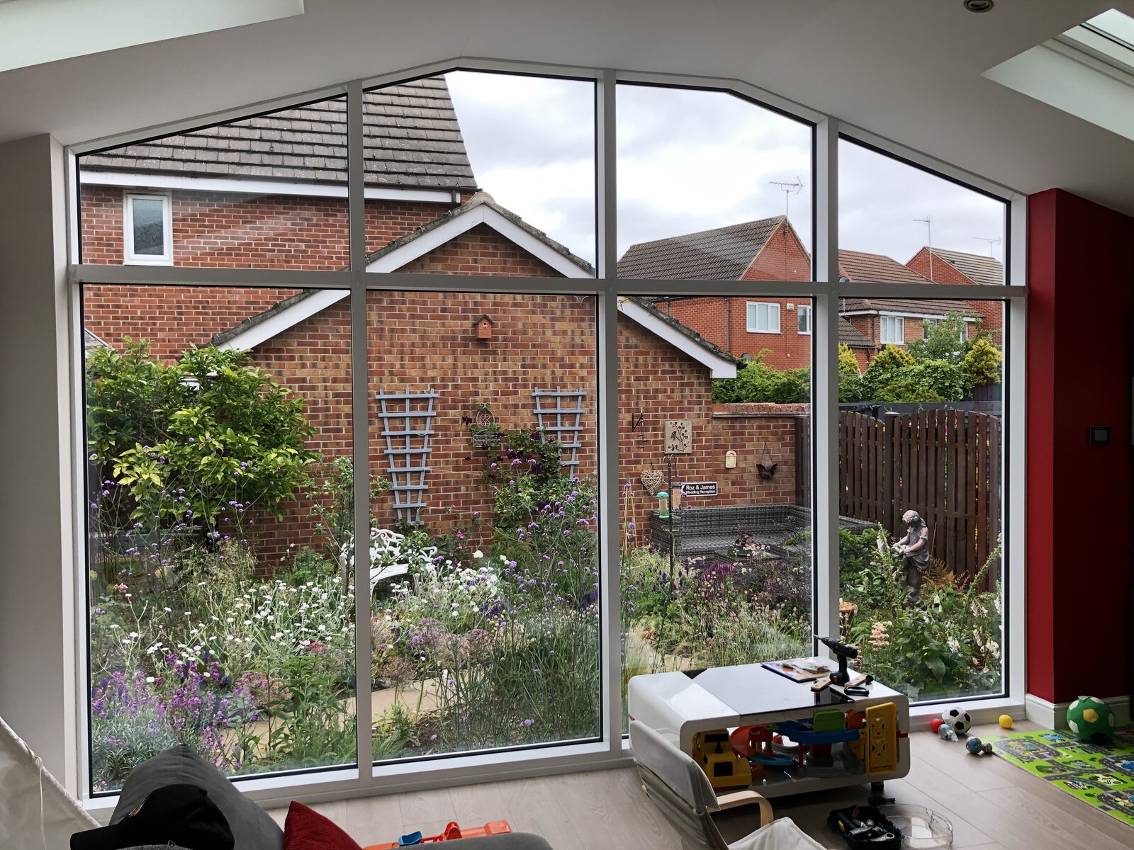

We’ve an open plan kitchen/diner/social space, that, as you can see, has a lot of glass.
It carries the same thermal delights as a conservatory. Scorchio in summer, freezing in winter. It measures about 8x8m.

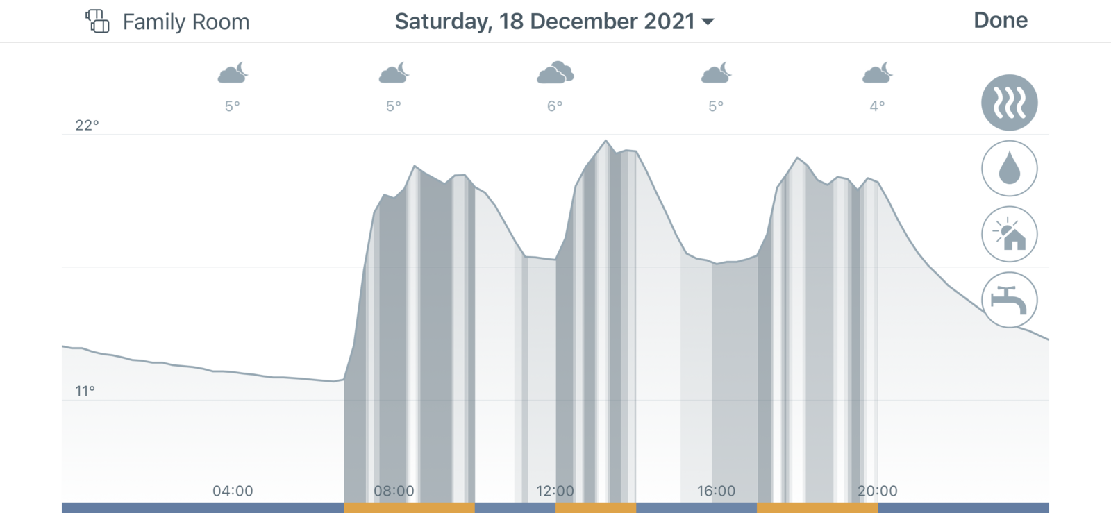

The area has WarmUp UFH covering it, but I’d have to sell a body part to fund its operation these days… and there’s 4x large Rads with unknown BTU output, which does sufficiently heat the space.
The problem we have is at this time of year, and the speed in which the heat we’re pumping in…. Pumps out again!
I’m looking for ideas/suggestions as to what options might be available to ‘do something to the glassy areas to keep heat in’…
Would wooden blinds inside/outside help?
Internally fitted blinds?
If the room didn’t have the annoyingly tricky to do anything with shaped glass above, I’d have ran a long corner rail and had some theatre esque curtains installed… but really that isn’t going to fly…
thoughts?
Options?

You need to do a heat loss study.
Catalogue what the area has and doesn't have, check for unwanted draughts, leaks etc and then make a plan.
This may be realising that the heat loss (or gain) is unacceptable and removing some of the glazing, or you need active shuttering for the summer, and bigger heaters for the winter.
Don't rush into anything. See what you actually have/haven't 1st.

no expert but suspect the best you can hope for in heat loss terms with blinds is at worst perhaps 5% or less at best around 10% but suspect the actual savings will be wilth all windows shuttered and closed be nearer 5%-or less
If that extension was built properly it should be nice and warm. I wonder if your goal post beam system is bridging the insulation. An infrared thermometer will tell you the cold spots inside and warm spots outside. Survey every foot or so and record the hot and cold areas.
That vertical rad shown in the pictures is about 2 kW design heat output.
But I never find they benefit the room by 2 kW and probably because they are so good at heating the upper half or the room!
You seem to have two good sized skylights and there may be scope for fitting removable insulation within them to be removed during the summer months.

I'm not sure a camera will tell you much more than you can already see - the biggest heat loss by far will be from the glazing and frames. That is a *lot* of glass you've got there and I am surprised it managed to meet regulations given the presumably limited amount of heat loss improvements that could be made elsewhere in the building to offset what would be classed as 'excess glazing' (assuming your house is of similar age to that seen in the background).
House is 15 years, extension is 4-5 years.

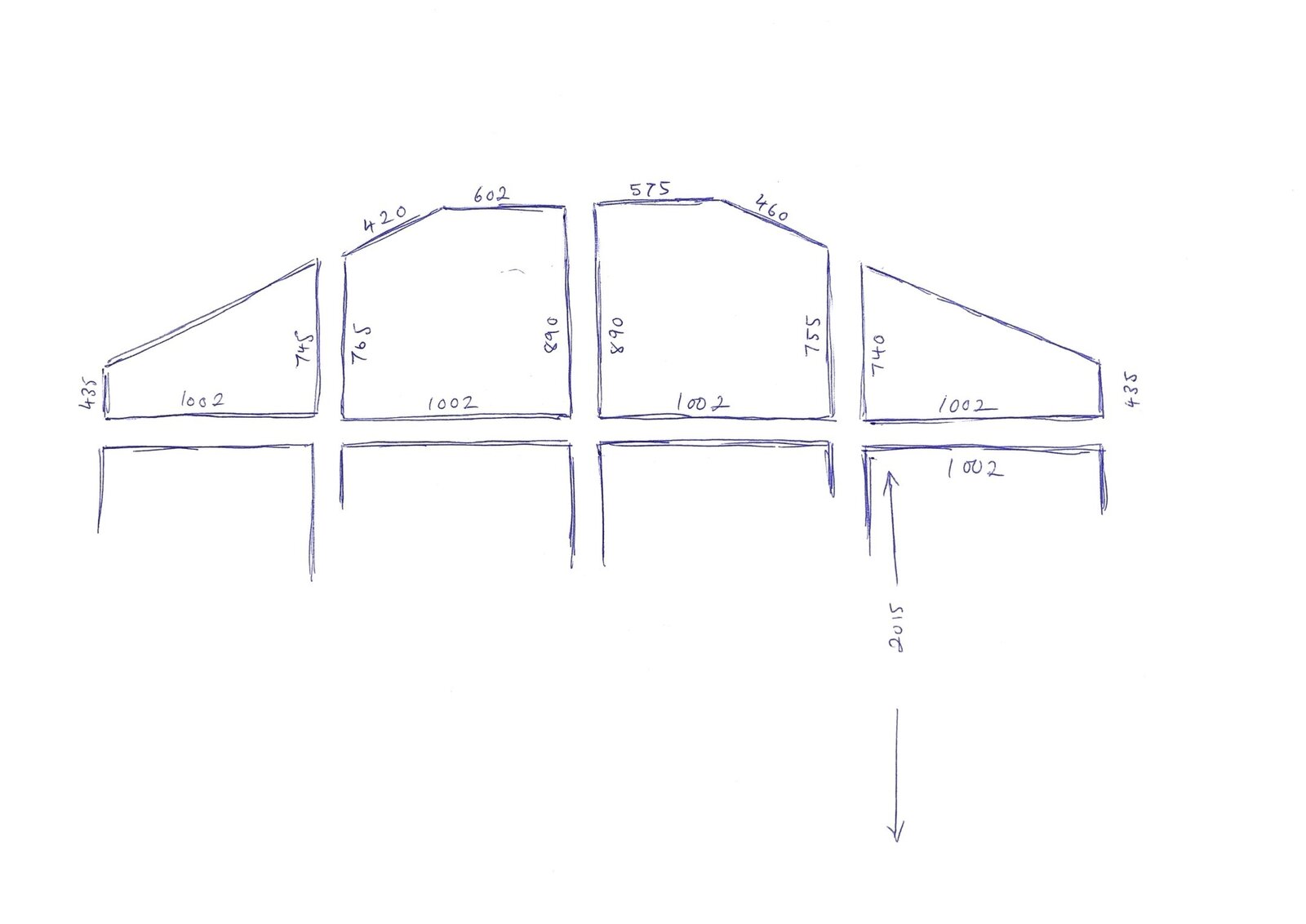

Could you perhaps have some insulated panels made up, to fit into some of those windows, for use during winter? Likewise any roof lights. It will not help in summer though unless you were to leave the roof light panels in place.
It's probably something to consider. Each window might have to form a Tetris style playing field though, as 4 lots of one piece panels would take up a vast space.... in fact so would Tetris pieces but would be easier to handle :)
