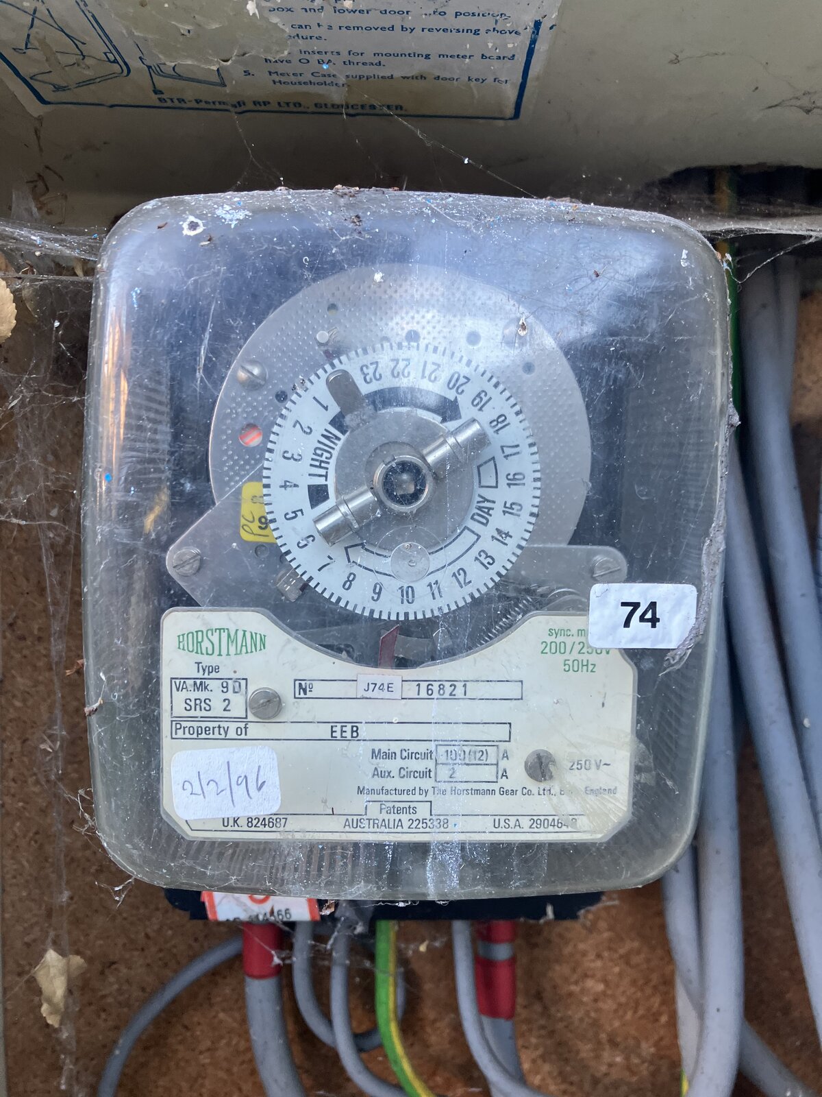

Hi all, we have this type of economy 7 meter. Over the years and several power cuts I’ve noticed our immersion heater has being staying on later and later in the morning. Our economy 7 cheap tariff is 12am - 7am. This photo was taken at 11.33am. From the image, I presume it’s roughly an hour and a 45mins out of sync?
I’m concerned that due to the misalignment of this meter to actual time we are charging our Nighstor storage heater and water immersion heater at the day rate rather than at the night cheap rate. Or do they sync with the clock and get charged accordingly?
How do I go about getting them resynchronised to actual time? I’ve call my energy provider today, but they are not sure so have been passed to the meter team who will probably want to put us on a smart meter.
Thanks for any advice

That is a time switch which determines the off peak period by switching your meter over to off peak and also any heaters connected through it so you should be OK . Back in the old days meter readers used to re set them
If you do not have a 'smart' meter then the rate selection is controlled by your mechanical timeswitch (your Photo). As Crystal Ball comments I'd not bother your supplier until they come chasing. I've just had to give up our Mechanical Timeswitch as is stopped. But for the last period we were getting cheap rate electric between 03:30 to 10:30 in the AM. So all washing, most showering and other heavy power consumption was completed before that time.
Saved a fortune!
Ah thanks both, I had a horrible feeling I was going to be the one out of pocket, but from what you’re saying it’s actually probably working in our favour marginally. I will have to remind the mrs not to set the dish washer and washing etc to come on too early in this case (12am real time) as that would still be peak according to the mechanical timer. All interesting. Will try and resist a smart meter for as long as possible. Cheers all, P.

Actually not until 12:45am (00:45) and 01:45 in the Summer time as I don't think they bother changing them.
Then cheap rate until 08:45 now and 09:45 Summer.
Interestingly here every Economy 7 tariff (regardless of supplier) is 1a.m. to 8a.m. GMT (i.e. 2a.m. to 9a.m. during daylight savings).
Actually not until 12:45am (00:45) and 01:45 in the Summer time as I don't think they bother changing them. ... Then cheap rate until 08:45 now and 09:45 Summer.
Indeed - and that (staying on GMT throughout the year) is still the case with the timing in my ('dumb') electronic E7 meter.. As I've observed before, in the days of electromechanical time switches for E7, I was told by one of the guys that they were instructed to only set the clocks 'approximately', so as to achieve some scatter as to when installations switched over, rather than having everyone switching at once.
