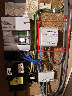

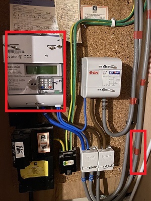

Your first picture tells us (though it would be easier to follow if you stood back and took a wider pic so I could see where all the cables go)
I only see one pair of thick tails coming out of the load side of the meter (the thin ones are for your timed switching) and they divide subsequently for your off-peak and your full-time services.
Therefore, the meter does not know where the power is being used
Therefore, if it is charging an off-peak rate according to the timer, it must apply that price to all power consumed during the off-peak hours.

The supply from the meter is connected directly to these two cables highlighted below. They will supply the consumer unit feeding the lights and sockets, plus anything else that can be used anytime 24/7 for example if you have an electric shower, cooker or immersion heater boost. So they will receive power permanently at the appropriate rate at the time so, as per your neighbour says the electricity will be cheaper during the off peak time. The 'peak' and 'off peak' times can vary, and some include a period in the afternoon. Your electricity supplier will be able to tell you when the cheaper rate is available according to the tariff you are on.
The other two cables will only be switched 'on' by the contactor box during the times that the 'off peak' tariff is available. So, the consumer unit you show that supplies the storage heaters and immersion heater will only receive power when the the cheaper 'off peak' tariff is available

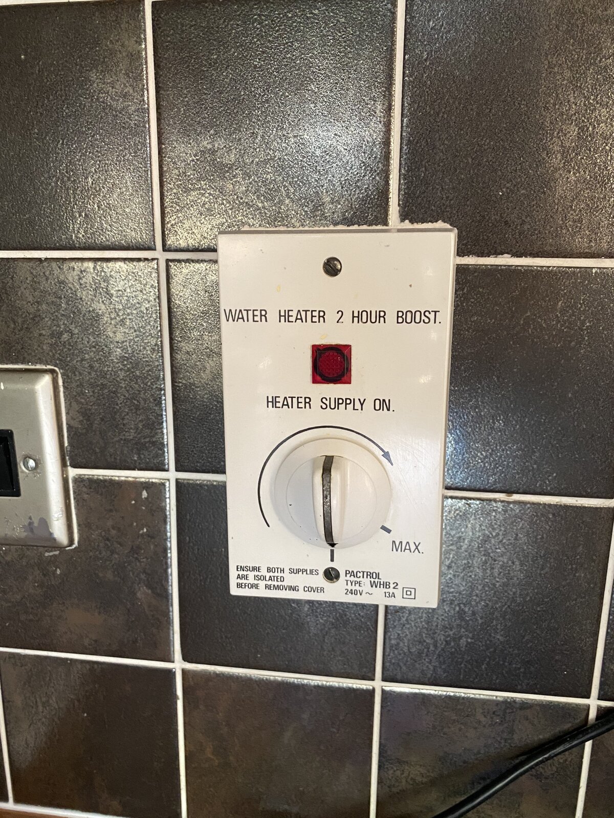

I couldn't help that notice the 'off peak' consumer unit is switched off. Which is fine when you aren't using the storage heaters, provided that you are not heating the hot water. If you are heating the hot water you will probably be doing so via a 'boost' from the main consumer unit and in doing so using the 'peak rate' electricity, which is more expensive.
Thank you so much, that’s correct it’s turned off currently and the boost is being used once each day for an hour and that provides enough hot water for the whole day, it doesn’t get used again
I’m wondering if switching the overnight heat on instead, although at a cheaper rate will likely take longer to heat the tank and ultimately be more expensive
if they use the boost for an hour at peak rate and it takes the overnight 3 hours at off peak then it’ll be more expensive if that makes sense
I suppose it depends how you use it and how it fits in with your preferences, the only way they will know is if they try this for a week then try the overnight for a week and compare readings I guess,
It might be about the same meaning it makes sense to just use the overnight for ease

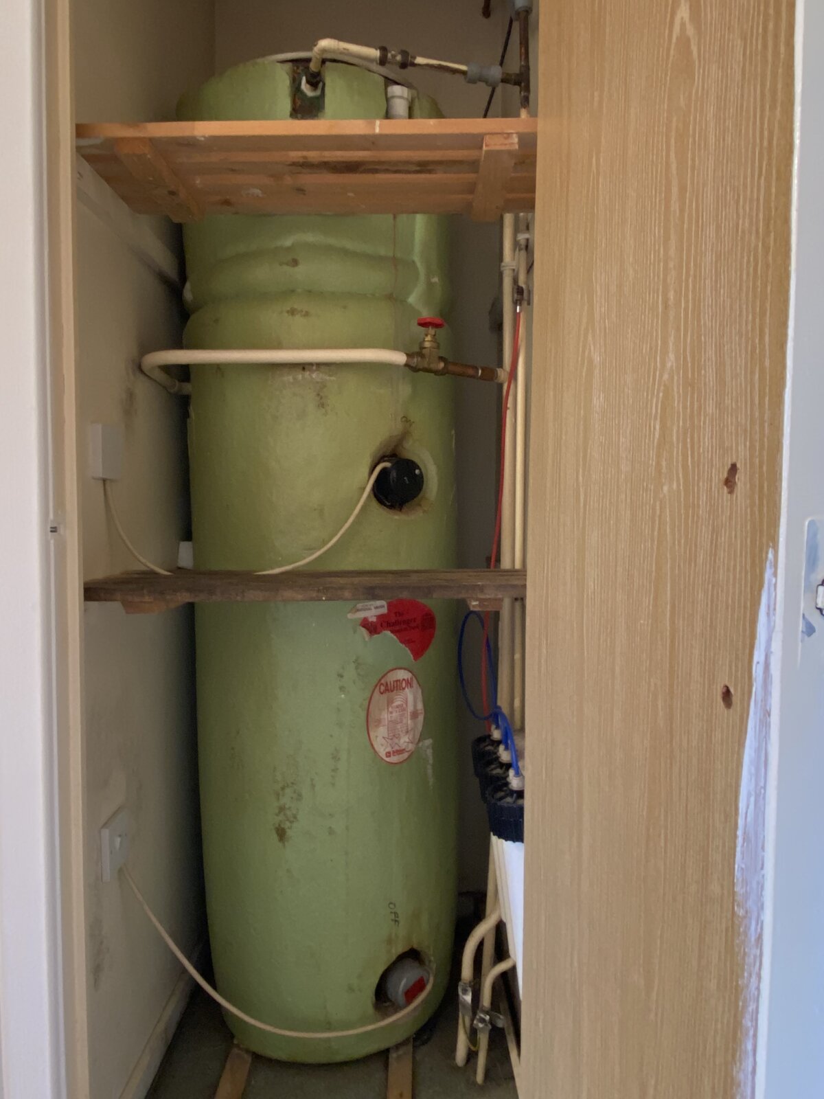

I’m at the house tomorrow so will send some pictures of the tank, I read also that the boost only heats the top half of the tank, but that confused me because it looks to me like the wire at the bottom of the tank is the main wiring and the one about half way up is the Off peak wiring, unless that doesn’t really mean anything,
I expected the off peak one to be at the bottom
The off-peak one SHOULD be at the bottom.
if not, it is easy to change.
You can put a timed control on the upper one, so you don't forget to turn it off.

the boost isn’t a switch it’s like a dial in the kitchen and it ticks back until it turns off itself, so that can’t be accidentally left on as such which is one good thing

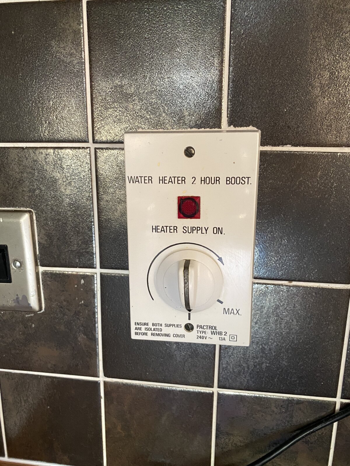

Hi there,
I’ve attached a pic of the boiler and one of the boost, now I look again I have no reason to believe the wires are the wrong way round at the bottom, I thought the bottom one had a light on it that was lit up and therefore because the consumer unit was off for the off peak stuff it must be getting power when It shouldn’t
looking now it has no light so I was imaging it, so I’ll test that by turning the bottom one off and trying the boost, if it still works then I’ll feel better as that makes sense

When the immersion heaters are 'on', and without any background noise present, often if you put your ear to the cover of the immersion element you can hear a quiet ssss sound when the water is being heated. They will probably be the right way around.
Both immersions will have a thermostat that will switch off the element when the water is hot, so don't worry too much about them consuming power indefinitely.
