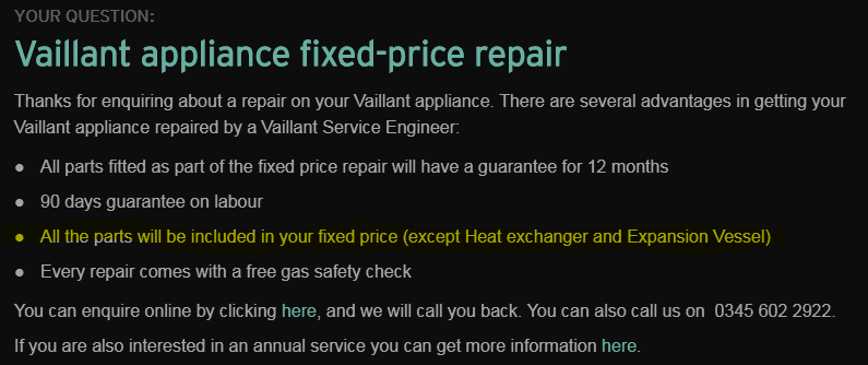

As Ian suggests, go with a Vaillant Fixed Price Repair. They'll charge you a set rate of £285 to diagnose and repair. They'll probably be able to work out which part is causing the issue, but if they get it wrong or more than one part is needed they'll have everything on the van they need, and you'll only ever pay that set price.
Thanks for the link. I was just about to book, it seemed a fair price to get the complete repair done but then I noticed that it says "all parts are included except the heat exchanger and the expansion vessel." Those are the two parts which I'm pretty sure need attention or replacing. So that £285 wont cover those parts, only the one producing the electrical fault. Do you think it's worth it or is there perhaps a more economical option?
