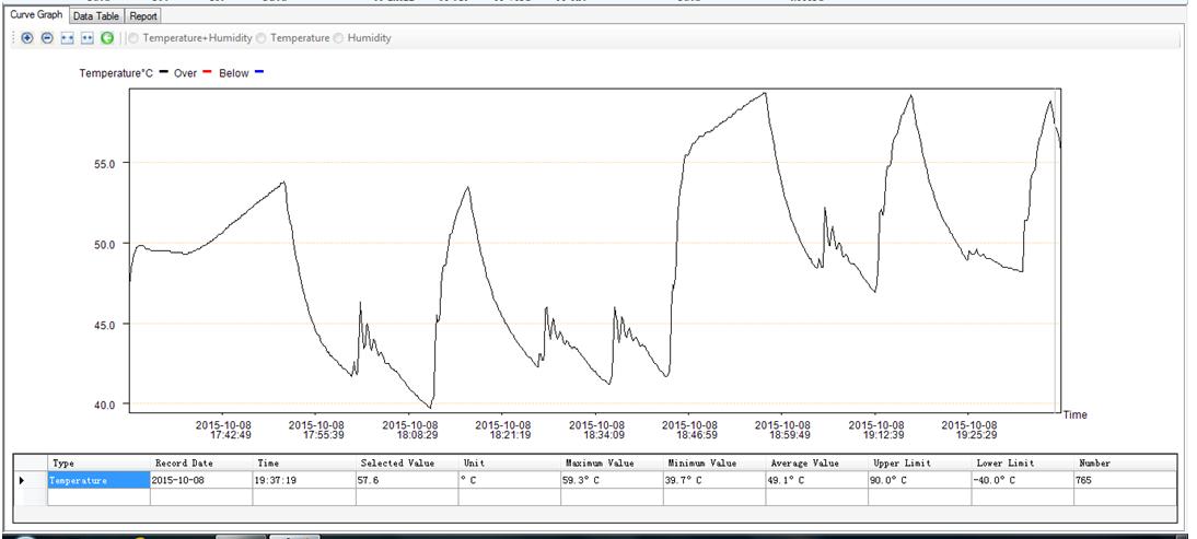

I would appreciate some feedback on my boiler performance (ecoTEC Plus 428). I have noticed that during the hot water heating cycle the boiler goes into anti-cycling mode and then about 15 minutes later fires up for about a minute and then shuts down. Now I believe this to be as a result of the differential between the Flow and Return being too small when the boiler fires-up (approx full power). Please see the boiler Flow Temperature chart below.
From my reading I understand that the boiler cycles should be kept as low as possible to prolong the life of the boiler and this Blip is unnecessary.
In case this helps the d1 setting has been reduced to 20kw and the pump is a new Yonos Pico 25/1-8 running at around 40 watts.
I would appreciate any thoughts as to whether this is normal, and if not, what my course of action should be.
Thank you for your help

The chances are at that age its not a high recovery cylinder. which means the coil in it will probably have a maximum heat transfer rate about 3 or 4kw. your boiler ignites around 19kw, and its minimum power output around the 6KW mark. Which means it can not modulate as low as that cylinder thus there is nothing you can do to stop cycling.
I run a 24kw boiler on a cylinder with a 22kw coil rating. from cold it will burn constant for about 15minutes before modulating down, then it will run another 5 min or so on low before cyling maybe atwice before the cylinder is reheated.
To put it in perspective. Your using a boiler approx 116% the power of mine on a cylinder that can handle 16% of what my one can.
Cycling is inevitable on a perfect system, so on your it will happen a lot on the hot water (if that is a standard cylinder which it is likley to be)
So on the basis that the boiler produces 6Kw minimum and the cylinder is 4Kw (I did some research on my cylinder and yes its likely to by about 4Kw). Once the system get close to its final temperature anti-cycling will be inevitable.
