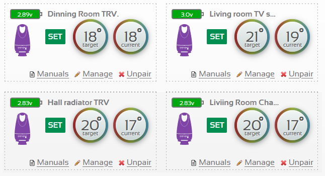

So your task is to set the lock shield valve and TRV heads, and I will admit in my mother house this took some time. I don't know how Tado works, but my TRV heads reported to the PC like this 4 TRVs-1.jpg so I have current and target temperature displayed, in Winter current should never exceed target, so if it does, turn the lock shield down a tad.
Over the winter living with mother I slowly adjusted the lock shield valves, and by the next year the temperatures in each room were spot on, well one small problem, the anti hysteresis software in the TRV heads was OTT, so in the morning 7 am set to 22°C then at 8 am to 20°C or it would be 10 am before it reached 20°C.
