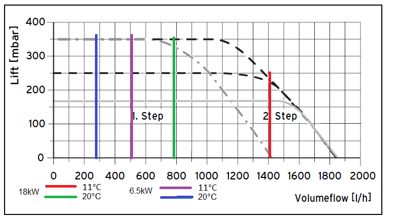

Pipe 22mm and quite long pipes; but boiler now range rated at 18 kW so that should be ok I guess. One more question to the person that put this oversized boiler there...
The limiting factor when considering pipe size is the velocity of the water (metres/sec). If it is too low there is a danger of sludge etc accumulating in horizontal pipes; too high and the water can be heard flowing through the pipes. A velocity of about 1metre/sec is normally considered OK. A 22mm pipe can carry 14.7kW @ 11C boiler differential and 26.8kW @20C boiler differential without exceeding 1 metre/sec. The difference is due the different flow rates (litres/sec) required for 11C and 20C differentials.
The pump and ABV are the same on all versions of the 637, so your graph is the correct one.
Yes, the flow rates given in the tech data are those required to provide a 20C differential at max power. This does not mean you have to maintain this rate all the time, which is a mistake frequently made by many. It would probably be better if manufacturers stated the maximum permitted differential across the heat exchanger.
If you look carefully at the graph you will see that the Y-axis is labelled "lift". This is the head available for overcoming the resistance of the heating system, i.e the index circuit. If the bypass is set too low there will be insufficient head to circulate water through the index rad; if too high there will be excess head, which will cause the bypass to open. The horizontal lines are similar to the constant pressure lines on Grundfos Alpha pumps.
I have shown on the chart the flow rates for both 18kW and 6.5kW at 11°C and 20°C differentials. If the flow rate remains constant the differential will reduce in direct ratio with the change in output; i.e 20°C differential at 18kW will become a 7.22°C differential at 6.5kW.
"Restricting the flow" is the wrong way of looking at the problem; the task is to provide the correct flow through a radiator. So if you have a 22mm pipe carrying water at 775 litre/hr (18kW @ 20°C differential) and this is fed to 18 1kW rads, via 15mm connections, then each rad will require 775/18 = 43 litres/hr (0.72 litre/min, 0.012 litres/sec). Given that a 15mm pipe can carry 12kW (20°C, 1.0 m/sec velocity), a lockshield valve will have to be closed down a lot to restrict the flow rate to what is required through the rad. Water is not pushed through a rad by a pump, it is sucked through because the pressure at the return connection is lower than that at the flow.
The simple answer to your question is to balance the system so you are working in the flat part of the curve and the differential does not exceed 20°C. This must be done with all TRV heads removed, pump set to operate in stage 1 and bypass adjusted so the furthest rad is heated.

If flow over heat exchanger is over 1200 l/h, with a differential of around 5 degrees
but
flow through radiators is only around 700 l/h, with a differential of around 11 degrees
1200 litres/hr @5°C differential equates to 7kW; 700 l/hr @ 11°C is approx 9kW. So more heat is being used up than is created!

@D_Hailsham, Yes, forgive me my errors rounding up and down. When boiler is at minimum power from the display so there is some reading errors there, plus it reports in whole degrees rounded up or down. So I have unfortunately not found a free energy source ;-)
Boiler measuring (d40 and d41) a temperature diffential of around 5º (4.5 to 5.5 in reality). Assuming boiler is near minimum (only graph on display no exact figures) that would equate to around 1200 litres (Even minimum power is a moving target between 6.4 and 7.1 kW depending on water temperature). But all calculations give me *around* 1200 litres per hour.
However, measuring the flow and return pipe just before the boiler myself (with digital 2 temp sensor probe I bought for this) I get, at the same time as the measurements above, measurements in the range of 10 degrees. That would indicate around 570 litres.
So yes they are ballpark figures. It might be 1149 and 574 litres/hour respectively. Question remains - why? As you showed in the graph in the purple line, that is where I want to be?
At least my radiators are on the purple line, my boiler is working much further to the right on the curve, with differential of around 5 degrees, nearer the red line?
I'm baffled.
I don't see why you are baffled.
Clearly the boiler is reporting a differential of 5 C whereas the actual at connections is 10 C.
My only concern is the too high return temperature which is going to reduce efficiency.
Obviously caused by an over active internal bypass.

An over active bypass would be one such problem, that would help. At least then I can get a good vaillant engineer to replace it!

Thanks again now I will definitely get a vaillant service engineer to investigate. Dirt on seating sounds like a possibility, it's only 4 year old boiler but obviously there's every chance the installer just threw it in without cleaning the system...

I cannot think of any other cause than the ABV.
