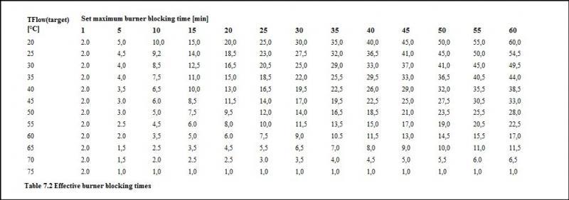

d.2 is the minimum time that the boiler will wait after cycling off before cycling back on again. There is also a required minimum temperature drop. Once both the d.2 time and the temperature drop have been reached then the burners come back on if still required.
From observations and what's written in the manual, it's the MAX time (not minimum!) that the boiler will wait before cycling
The manual says:
d. 1 Water pump over run time for heating mode 2 - 60 min (factory setting: 5 min)
d. 2 Max. burner anti cycling period at 20 °C Flow temperature 2 - 60 min (factory setting: 20 min
Could ianniann be confusing "min" meaning minimum with "min" meaning minutes?
What I think happens is that boiler calculates its own length of time for the burners to be off, based on various criteria, and the d.2 setting is simply the maximum that this will go up to.
Thanks to keithsb who provided a table for d.2's "Effective burner blocking times" below :)

So, from that table, the time the burners are off for anti-cycling *is* driven by the d.2 setting but not directly? That setting is actually the anti-cycle time for a flow temperature of 21C, and then the boiler picks shorter intervals when the flower temperature is higher?
So you have some control at least. I wonder if the table operates using the flow temperature set dynamically by your controller or just goes with the one set with the knob on the front? Out of the available choices, I prefer the ones at the higher end although the delays at low flow temperatures still seem excessively long, and the ones at the high end excessively short. For example, at 75C I don't think I'd be delighted to have my boiler switching on and off every minute or so, but I guess with your controller you won't be in that situation very often.
See this thread for how I believe d.2 operates. I have put it in a seperate thread to hopefully build up a better explanation of all the codes in one place, perhaps also providing a reference for others in the future! :)
