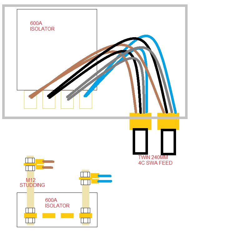

Unfortunately I didn't take a picture of this incident as there were too many people in the way, so I've tried to represent the installation of a brand new chiller unit on the roof of a hospital.
The grey square represents a steel control panel, maybe 1200mm square which contains all the control gear: 600A main isolator, MCB's, contactors, relays, BMS controller etc. Normally the gland plate in the bottom of the box would be removed and another steel box OF typically 400 or 600mm square attached to cater for the incoming supply cable, hence the connexions appearing to be fairly close to the side of the box.
In this case the electricians had no experience of this technique and glanded the twin 240mm 4core SWA's into the bottom of the box and made the connexions using lengths of M12 studding as shown [only 2 shown for clarity].
By the time a thread is cut on a 12mm rod there is about 9mm left, or about 70mm² and after 2 hours of commissioning one of the studs melted, allowing the cables to spring forwards, puncturing the paint of the metal door and burning a 100mm hole through the door.
Fortunately the control circuit was on the lost phase so the chiller shut down straightaway.
The supply was still live!
