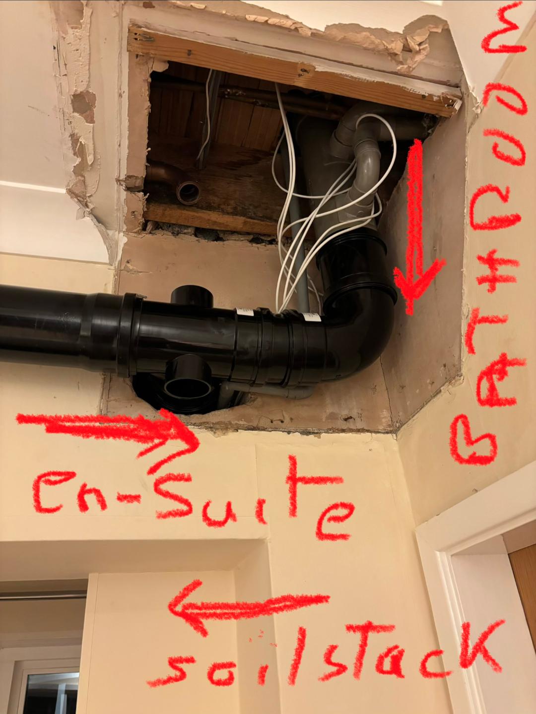

Plumber has fitted internal toilet soil pipes in the downstairs hall opposite each other into a Y connector, before entering the soil stack pipe. Now there is a risk of cross flow, but there is only one hole (above a lintel) for access to soil stack, so the soil pipes cannot be staggered into the soil stack. Building regs will not sign this off, until it is resolved. Access to the soil stack is complicated, that is presumably why the plumber chose to use the existing hole above the lintel. (see attached photo which show the issue). Plumber suggested placing a valve/trap door to prevent cross flow putting in a hatch to access the soil pipe, to make it easier to rod. However, I believe it will still not pass building regs. The new soil pipe connected into the "Y" is at the correct gradient and is 4 meters long and the existing soil pipe is going almost vertical into the "Y" , so plumber thinks its very unlikely to have sufficient cross flow to over flow. Also concerned about "watershed " at the junction if both toilets flush at the same time- will it be more likely to block at the "Y" junction. Any ideas please.
I am not surprised, it's a blockage waiting to happen! It's up there with the best best, an absolute bodge. Did your Installer, (as they don't deserve the title of Plumber), arrive on Horseback?
Risk? I'd say a certainty. There is no way there can be an adequate fall from both directions, it's a blockage waiting to happen, the only variable would be how long it takes to block....
Any ideas please.
You might just get away with using a double Branch, at least then both connection are swept in direction of flow, but it really needs a total rethink. Otherwise I strongly suspect you will be pulling the house apart to clear blockages on a regular basis, and unless you want half of what's gone down the WC all over you/the carpet whilst attempting to clear the pipework, I'd come up with a Plan B and fast.
Need a lot more info though to be able to offer an alternative solution.

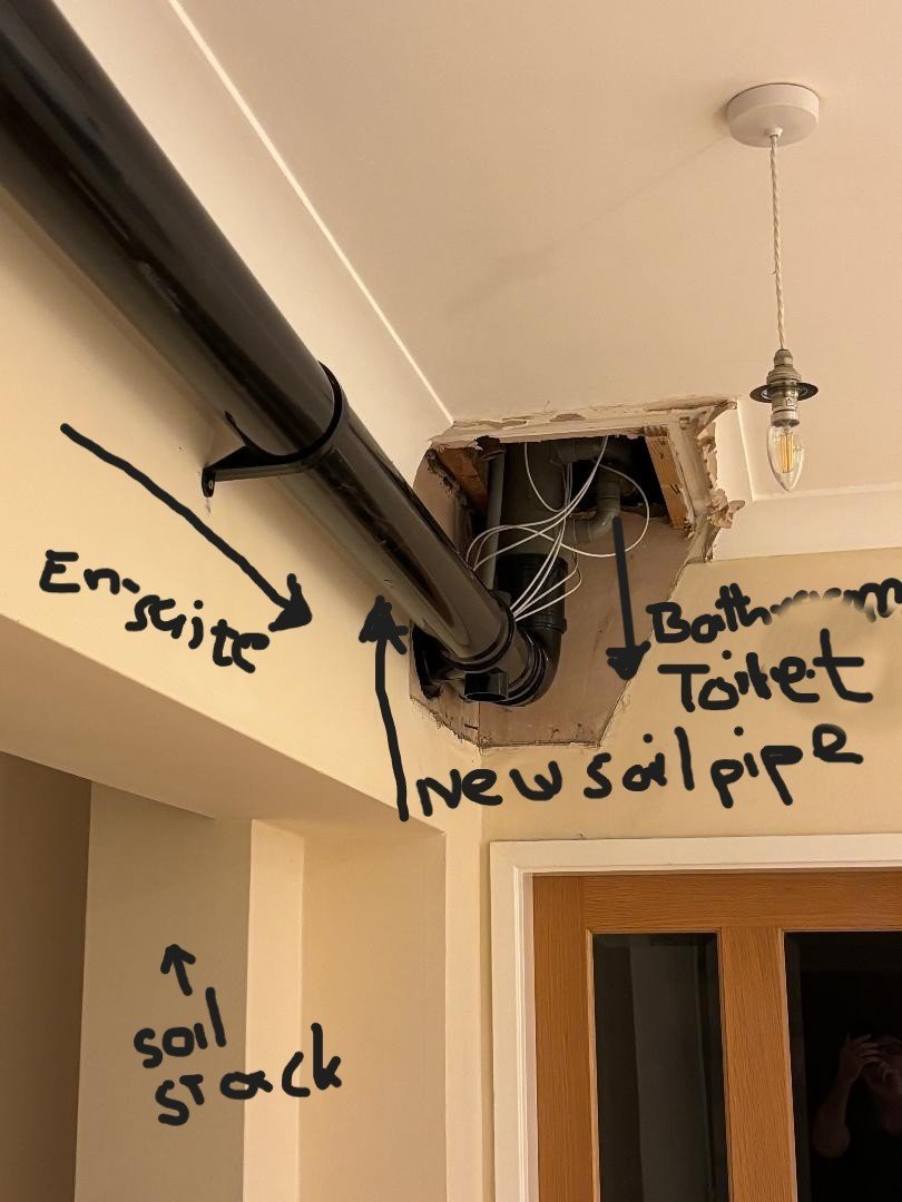

Thanks for your replies, I have attached another photo to original post. The soil pipe cannot go externally from the new en-suite or we would have done that, hence the only route is internal. We did ask the plumber to check the existing pipework first for feasibility, before proceeding to fit the new en-suite. The building reg inspector arrived after he installed soil pipes & said it would not pass regs, we informed plumber, straight away, by that time he had completed about 20% installation, but he is continuing with project, & thinking about a solution, but it may require extensive building works, which he said he can't do. Where do we stand? Is there a more simple solution without knocking down internal walls etc. Should we ask him to stop working, ( he is at the tiling stage now). The bathroom installation company, subcontracted the work to the plumber, and they said they are seeking a solution.
What is a double branch? sorry I am not a plumber, & which part of the soil pipe would it go into?

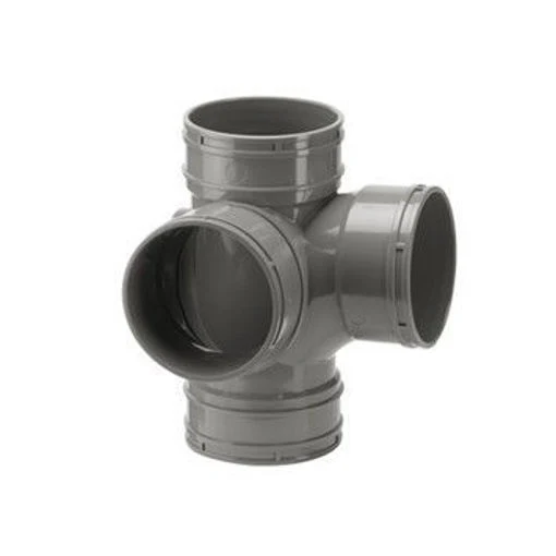

Thanks, that is helpful. I am assuming that is all going to be boxed in as part of the works, so aesthetics aren't a major concern. I think the only simple(ish) solution would be to use a Double Branch so both pipes connect on swept entries, and cap off the unused socket. Ideally both pipes need to join in the vertical section on the other side of the wall, but I would be concerned knocking another hole through could compromise the integrity of the wall.
Alternatively, a corner branch could be used, but there may not be room to dogleg the connection from above, across to suit.

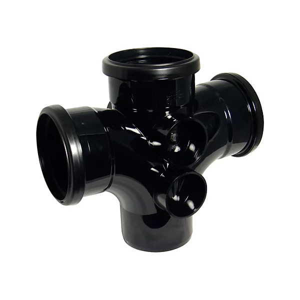

I think probably the only solution that may get you out of trouble without major reconfigurations, is to use a Corner Branch, bring the soil pipe from the Bathroom over with 2x 45° bends to meet it and then reroute the waste pipes as required.
It is going to be a lot easier to alter the 40mm pipework than the 110mm!

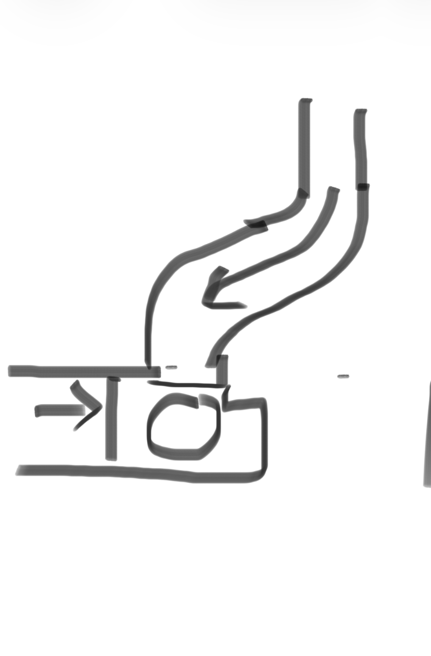

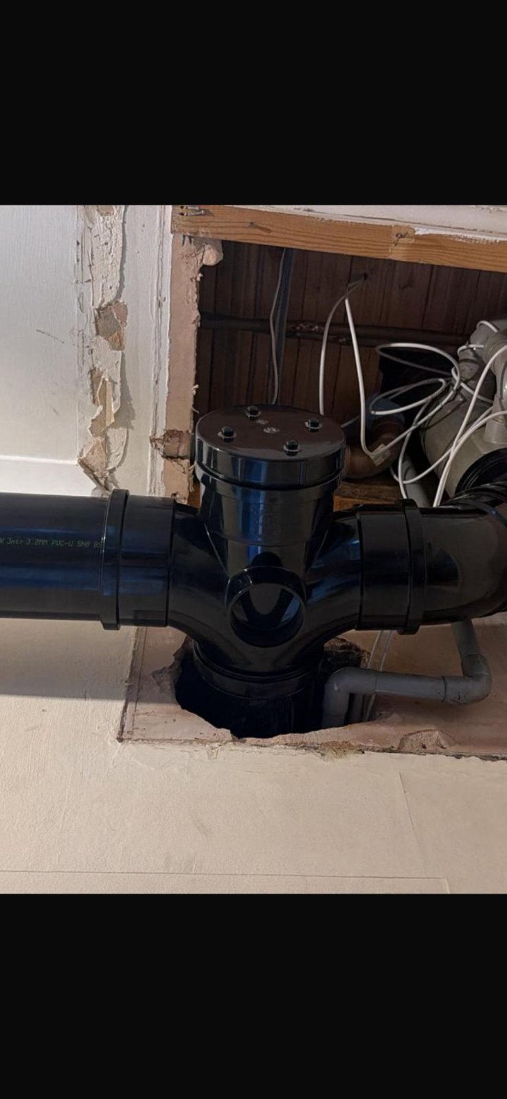

Hi all, They changed the fitting to the one Hugh suggested with swept curves (see photo on left- looking from below. Other photo shows the 1st "T" connector he put in. I thought they could of done something like my sketch (see photo).
Still need to be signed off by the BCO for building regs? Do you all think this solution will prevent cross flow or potential blockages? Looks like a rodding access point added too?

It's better, but not ideal in my view. At least now both incomers are swept in the direction of flow, and there is less chance of any crossflow. I would see what the BCO says, some may be ok, others may not like it.
I would check the en suite WC has a decent flush, you may be relying on that to keep that side of the branch clear of any build up, as I certainly wouldn't want to be undoing that Access Cap indoors with a head of waste behind it.
