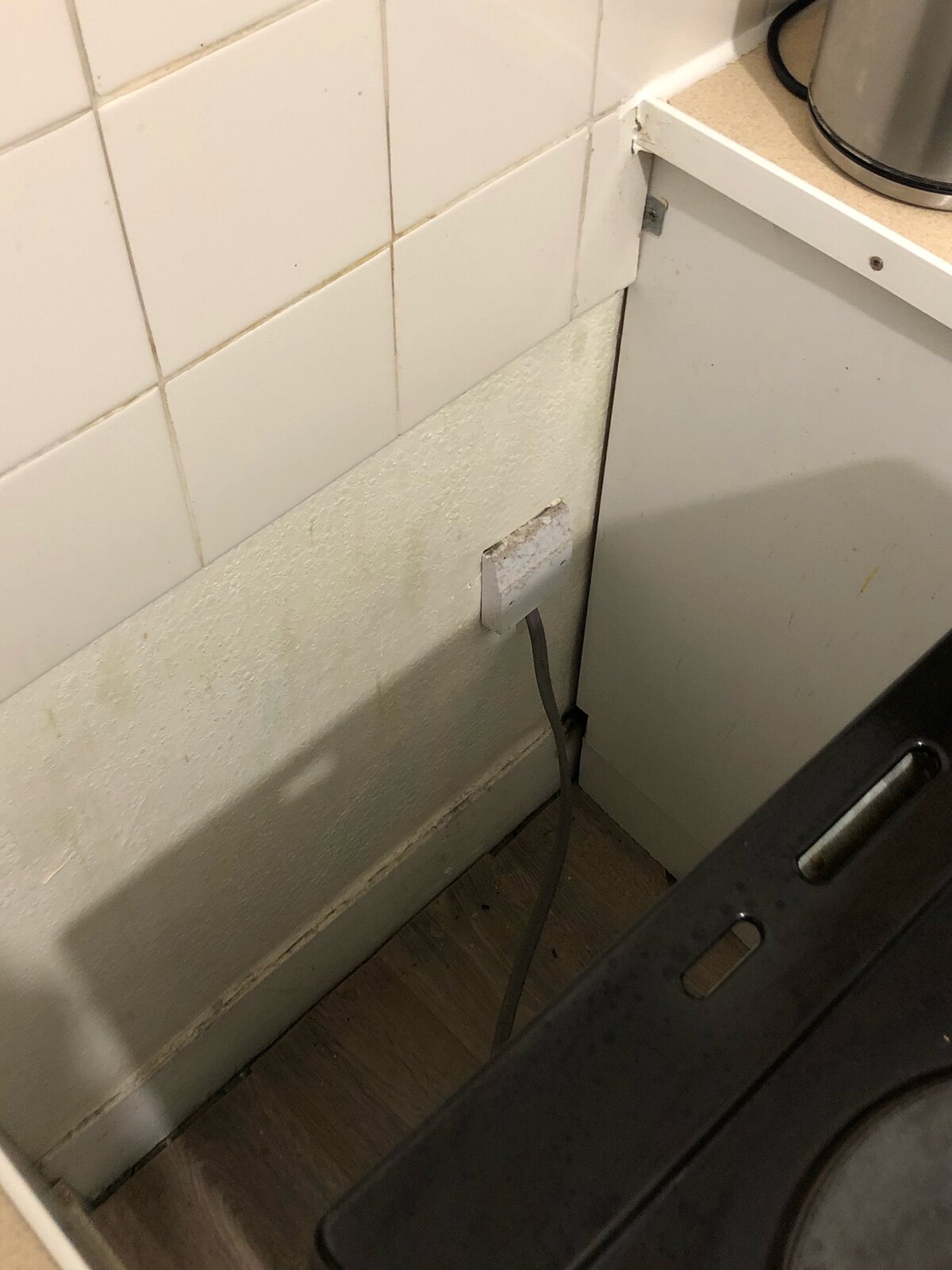

I have a five year old electric cooker and when the rings are switched on the rcd trips. This has just happened and I ve never had to replace or fix it
does anyone know if an element in the hot plate causes this. In the past with electric ovens this is the reason but I ve never done it with a freestanding electric cooker
I am thinking it is not worth repairing and therefore I should just replace the whole cooker but it seems a real shame and such a waste for the environment
does anyone know if it’s worth repairing or just replace? And what I can check. All rings trip the board which means I can’t cook my dinner tonite for hubby amd me!!

Hi the oven and grill are fine - It is the rings which trip whenever each of them are switched on - So we cant turn any of the rings on but the oven works fine
I have disconnected all sockets from the ring and isolated it to just the rings. Is it worth repairing or should I just replace?
