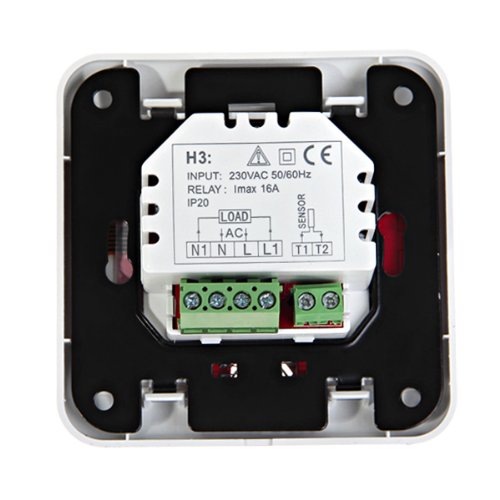

Hi Friends-
I am living in Germany and have electric floor heating. To save money, I am replacing the old analog thermostats with programmable digital thermostats.
The thermostat I have purchased has terminals for both the "load" and for the "supply". However, there is only one set of wires coming into the box (blue, black, and green/yellow). Does someone know which terminals I should be connecting these wires to? Please forgive my stupidity -- I am only smart enough with electricity to get in trouble. And I think I'm going to get into trouble without some help.
Here is an image of the back of the new thermostat.
http://ecx.images-amazon.com/images/I/41m7+-0aTCL.jpg

If the old thermostat only had two wires and earth then it didn't have a Neutral and so operated with a Neutral.
The new one requires a Neutral to operate. So unless you can add a third wire to bring a Neutral to the thermostats location it is unlikely you can use the new one.
Possibly live and switched live, and they may control contactors (relays) at the consumer unit rather than switching the heating elements directly.
