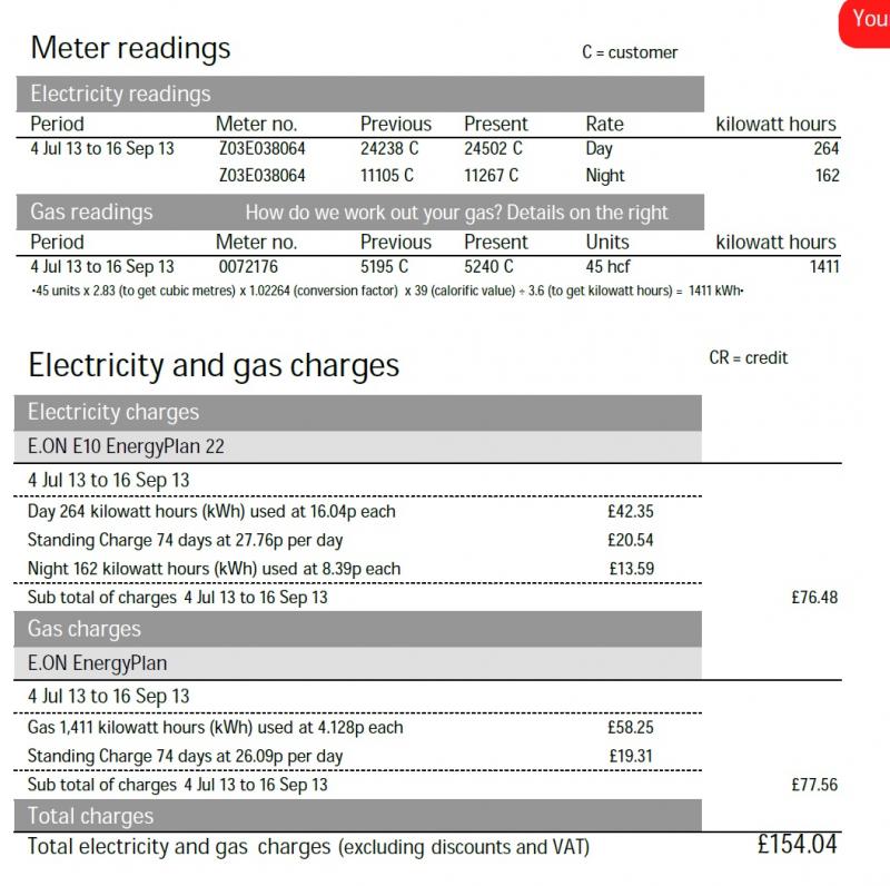

my bills are very high.
From the meter readings provided, you are using about 10 units per day, which is the average amount for a normal sized house.
However the high percentage overnight is not normal. Unless you are actually using your washing machine and dishwasher every night between approximately midnight and 7am, there is something else which is using a large amount of electricity. An old fridge or freezer with defective door seals is a likely culprit, or anything left switched on all the time such as a computer/server or similar.

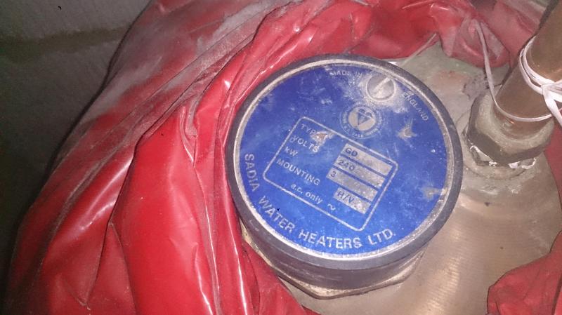

I have a HW cylinder in the loft but I have the boiler timer on for 30-45 mins per day to heat my hot water.
A HW cylinder in a loft would be very unusual - are you sure about that? Are you also sure that it does not have an electric immersion heater in it (and working)?

attached latest bill /consumption Jul-Sep13
At 5.75 kWh/day over that 74-day period, your total consumption is pretty low (I think way below 'average') - but for 2.19 kWh/day of that (38%) to be 'night' (5 hours per night) still 'is not right' in terms of what you've told us - either your fridge and/or freezer are taking far too much or else there is something else using electricity at night which you have overlooked.

Hi John,
The HW Cylinder is in my loft dormer conversion (Ensuite cupboard) and is directly below my gravity fed (HW & Central Heating) header tanks All I know is I get hot water. The HW cylinder is insulated. Sorry to appear vague but Not sure about an electric heater in it??
Hi John,
You could always post a photo of the cylinder but normally they would have a cable going to an immersion heater sticking out near the top of the cylinder. There will be a switch on the other end of the cable which controls when the immersion is on or off.
Kind Regards, John

You could always post a photo of the cylinder but normally they would have a cable going to an immersion heater sticking out near the top of the cylinder (or out of the side near the bottom). There will be a switch on the other end of the cable which controls when the immersion is on or off.
See addition in red in above quote.
I do suspect that the OP may well have an immersion - even if the cylinder is very well insulated, I'm not sure that 'boiler heating' of the water for just 30-45 mins per day would be enough to result in an adequate supply of hot water.

On top of the HW cylinder tank is a Sadia 3Kw immersion heater, but this is not wired to anything up so is redundant! The previous owner fitted this so not sure if he used it previously or not?
The chest freezer in my outhouse which is quite large and only 1/4 full with a dodgy door seal from probably being outside may point to the consumption overnight? Can't think it being anything else?
