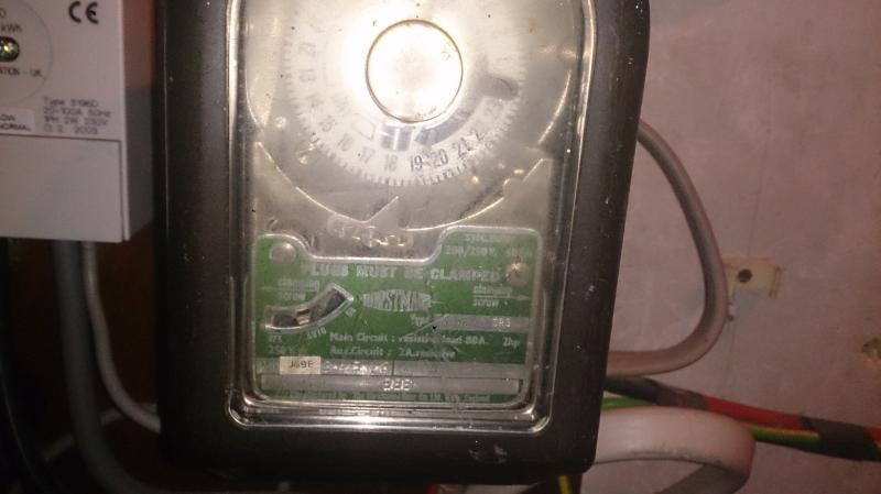

Thinking about it, that bill was before I started using a dishwasher. But I have just been sent another bill today and the night units on average are about the same.
I just took a look at the clock next to the metre (photo attached). Is the time suppose to be in line with the silver point???
To me it doesn't look like it is reading the correct time. I took the picture at 7.20pm tonight??
I would assume it's set to GMT.
I was looking at a sundial today - and that was on GMT as well!
Should I and Is it possible to change the time on them?
No. There will (hopefully) be seals to prevent you from doing that without getting caught! - otherwise half the world would be getting 'cheap off-peak electricity' at lunchtime :-)
To change E10/E7 mechanical timeswitches from GMT to BST and back again would obviously involving sending operatives out twice a year to all the hosues involved, which would be a horerndous cost. They therefore leave the clocks on GMT all the time - so those timings that EON sent you will actually be an hour different during the summer.
