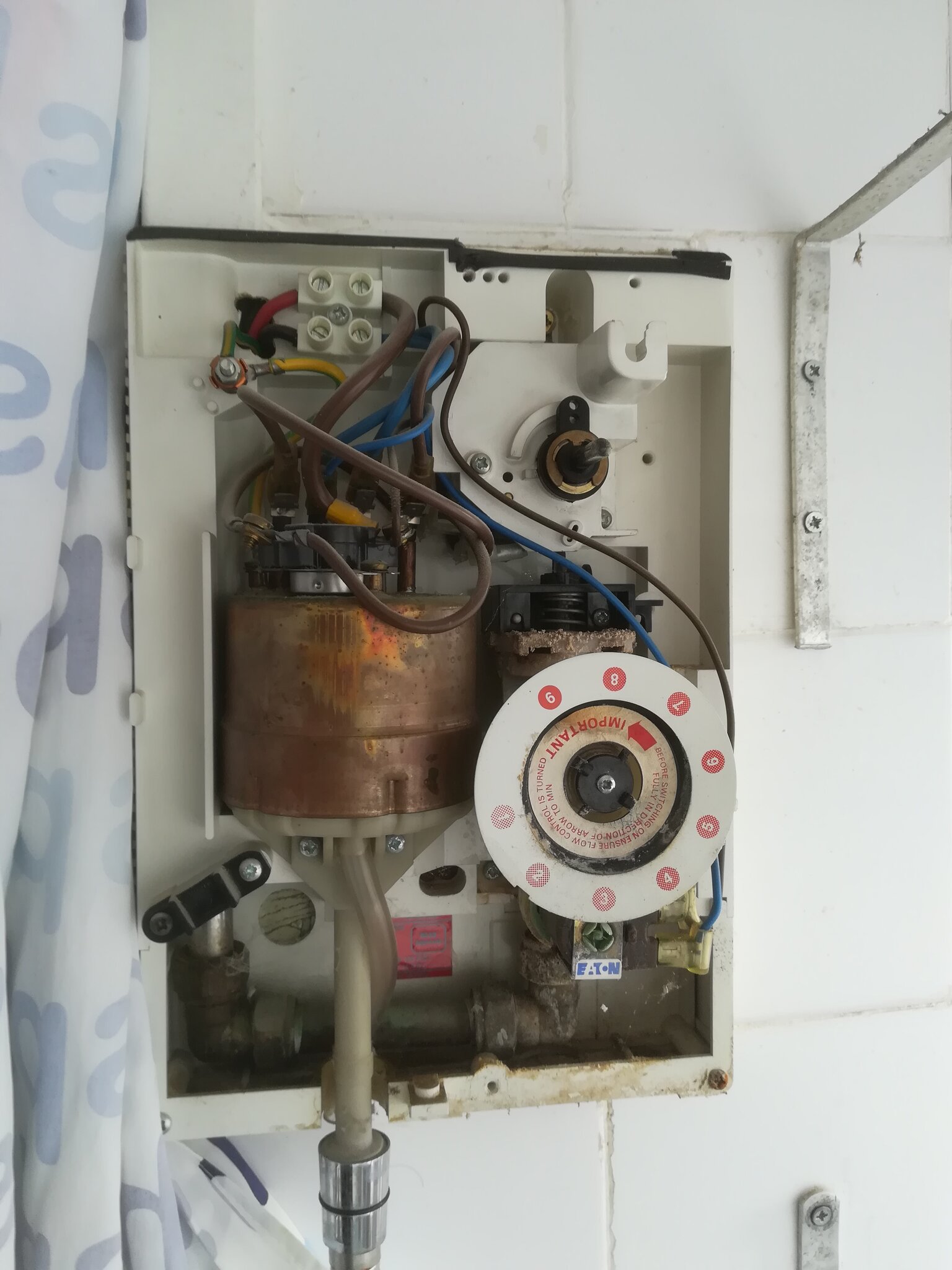

My son has an ancient electric shower put in by a previous owner at least 30 years ago. When he moved in about 20 years ago, the shower wasn't working and I replaced the inlet solenoid, an easy job. I am no plumber but I can tackle things like that. In doing so I was shocked (pun intended) to discover that the electrical supply had not only been taken from the live side of the main consumer unit isolator switch but via only a rewirable fuse. In a nod to safety and updating, I replaced the fuse with an RCD.
Yes, I agree, it should have been replaced and rewired right then.
After about another 10 years I replaced the solenoid again. He said the other day that the shower had stopped working yet again so he obtained yet another solenoid
and we tackled the job but this time the solenoid was firmly stuck on the valve stem. After a lot of gentle coaxing and WD40 the coil began to move , then my worst fears, "We don't want to break the valve do we?" happened. The valve top broke off and water sprayed out. We both moved unusually quickly and ran downstairs to turn off the water main.
One lucky thing is that the shower is over the bath so therewas no water damage. As I suspected, there was no separate isolator for the shower supply so wewere stuck with no water for the house and a broken valve on a Sunday afternoon.
The other lucky part to this story is that he had plumbing insurance and despite showers being excluded from the policy, they came that Sunday evening, plugged off the feed to the shower and restored the water supply
The shower is now a write off as it is so old so we are looking at replacing it with a wall mounted mixer or a mixer tap set.
