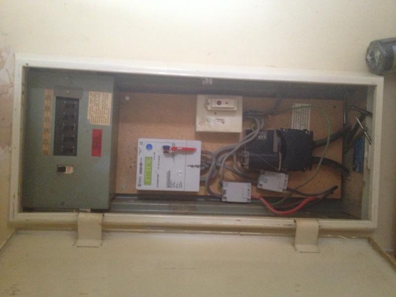

Hi,
I've bought enough laminate to cover the ground floor but before I lay it I'd like to put underfloor heating throughout. My problem is that I'm not sure if I'd first need to upgrade my electrics.
Forgive the orientation of the photograph, I've not been able to rotate it!
I'm confident I can lay the heating, but actually wiring it in is beyond my ability, it's my understanding that anything connected to the main board needs to be dealt with by a professional.
So looking at the photograph, do you think it's likely that an electrician will need to upgrade the board before connecting the heating?
If so, how much might it cost, or how much could I expect to spend just on getting the underfloor heating connected, also what kind of questions should i be asking when hiring an electrician?
Cheers
No.
That's not to say you shouldn't have things upgraded anyway, you should (there's no RCD protection, for a start), but an electrician could install the heating without using the existing CU or wiring.

How is the property heated now? There is nothing in the picture to suggest any electric heating, and that supply may not be suitable for the addition of a substantial extra load.
That cupboard is one of those horrid Clifton/Mantel or whatever things, and is far too small to accommodate an additional consumer unit for an electrical heating installation. Even replacing the existing unit is likely to have various difficulties.

Depending on how old your property actually is would determine whether you need a complete rewire due to the new regulations however a qualified electrician would be able to tell you whether the work is required and also the cost.
